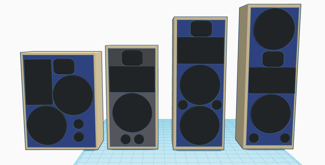

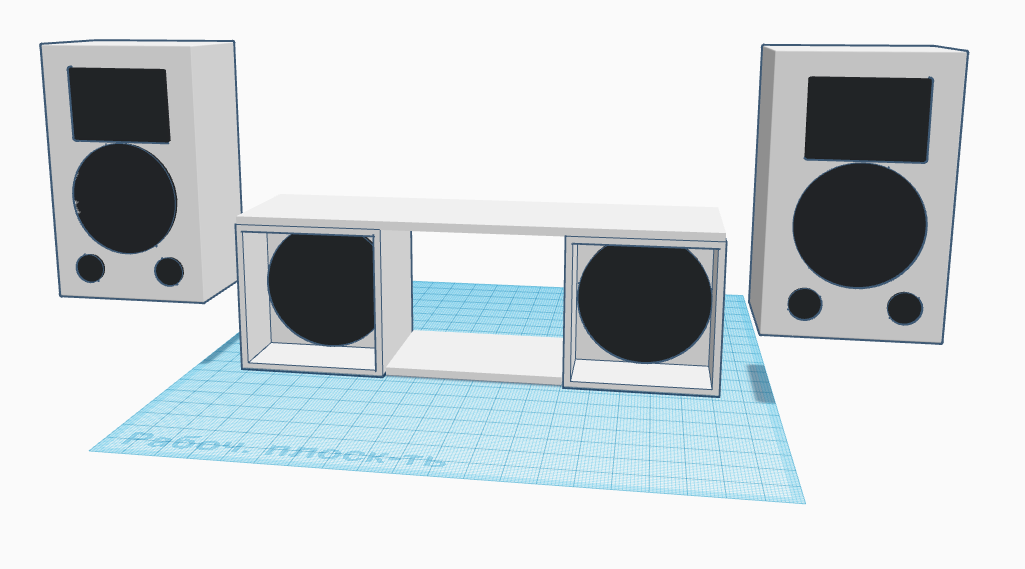

Look forward for comments and opinions. Below a quick sketch how I see the system looking like.

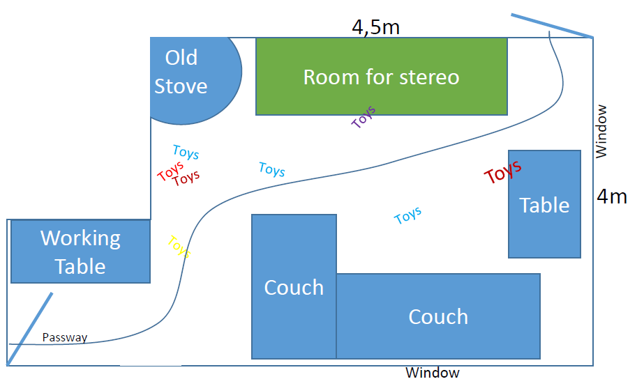

The attached picture represents the sad reality of my room configuration. I live in a very old house, which when was built people had other priorities in life than stereo and TV. For now there is no other option for a better room/place.

No, I cannot use another room as an enclosure, I have thought about that. Kid’s bedroom is coupled to both rooms on sides so it is not an option.
Considering my configuration what solution would you propose? I can increase the size of H-frames if this matters. Right now I am thinking about 450-500mm deep.

That's a tough room to work with. I have been lucky to have rooms with enough depth to maintain at least 3ft between speakers and front wall. Pretty critical for OB IMO. If you got that, you're in good shape.

Antonfazer,
behind the wall (room for stereo)is leading to outside?
If yes, yes, IB won't work for you.
In this case, because of room acoustic, I would recommend 4 smaller sealed sub scattered thru the room. Quad 15" will move more air than dual 18" and will keep your room mode in check.
I would use one on each side of couch, one in the center where is your stereo and one nearby the stove. (bass is mono below 80hz so localization will be impossible anyway)

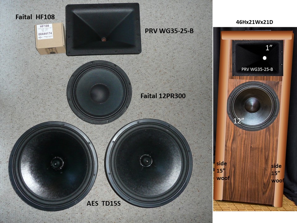

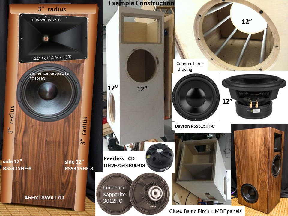

I have the Faital HF108 with the PRV-WG35-25 waveguide crossed with the MiniDSP BW3/BW3 filter at 1200Hz to a Faital 12PR300 midwoofer. I am very happy with the wide bandwidth sound. The long range plan is to add my two AES TD15S woofers for a complete 3-way, with a cabinet similar to the Tweek Geeks BMF-1.
Using DSP + separate amp can generate deep equalized bass from dual side-side 12" woofers in a modest 6cuft cabinet.

Etalon90, IB is not an option. The reason I stick to H-frames is that the best bass that I heard so far in my room was from OB. I think I have to try (perhaps prototype) them out and look for another solution if not successful. I do not have much believe in sealed box subs, I have not heard one yet which I really liked. Thanks for your advice anyway.
Maybe I could build multiple H-frame subs and attach them to the ceiling like lamps J

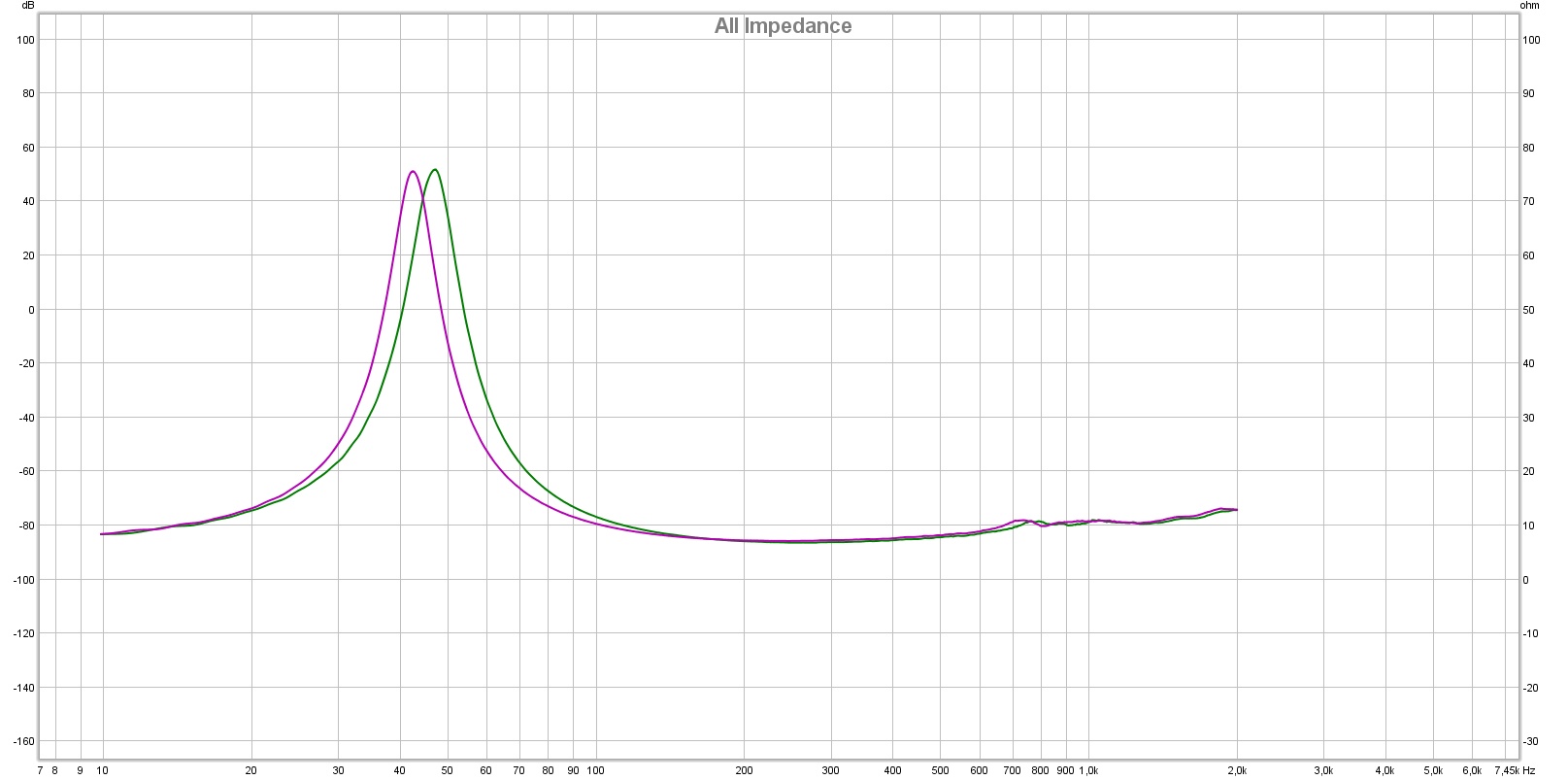

Puppet and Charles Darwin, I am aware of low Xmax and that is an instrumental speaker. However, to my taste this is the best mid-midbass I happened to hear so far. I am not concerned about Xmax. It will play 90Hz and higher in BR box, for that the cone of 15” barely moves on 110db. I rarely listen louder than 100 db.

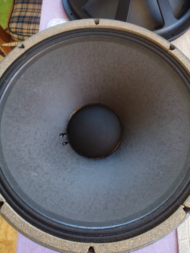

K130 has a very light cone, 60g MMS. Alnico magnet, 4” aluminium wire coil. Real measured Qts of 0,35 which is excellent for BR. I have compared it to 2220, EVM12l and Faital 10fh520 and preferred the K130, see my first thread.
I think many people nowadays look and see high Xmax only as advantage, but forget about the cons. Speaker is always a compromise. I think I found several threads on this forum where people discussed 15” midwofers with particularly low X-max. After my experiments with midwoofers I realized that high Xmax is not an advantage for home use. This is my opinion and not valid for bass and subbass woofers though.

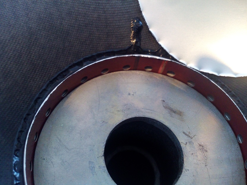

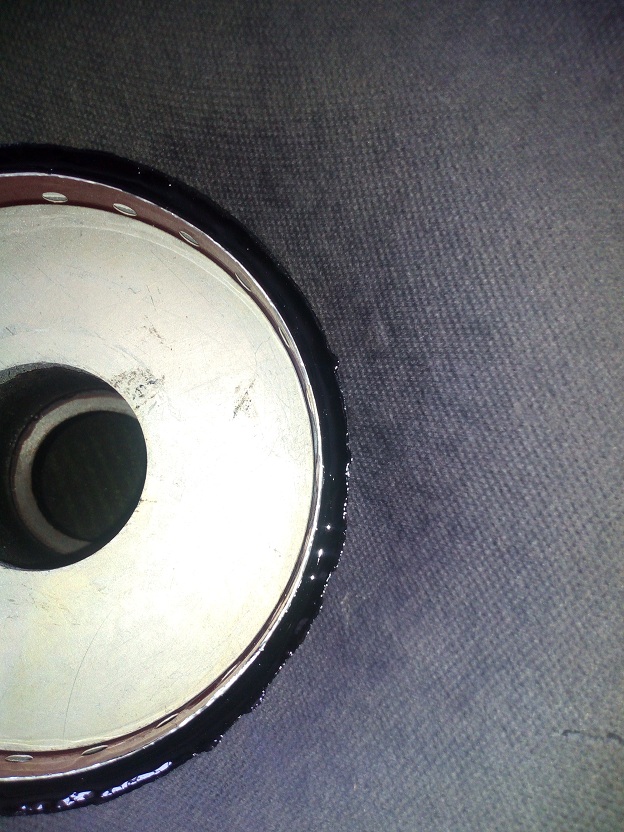

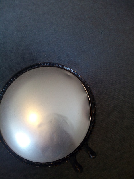

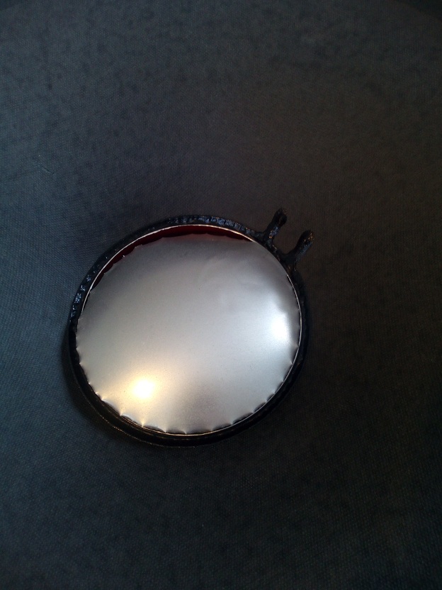

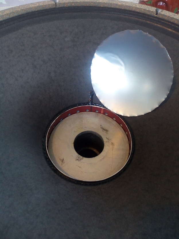

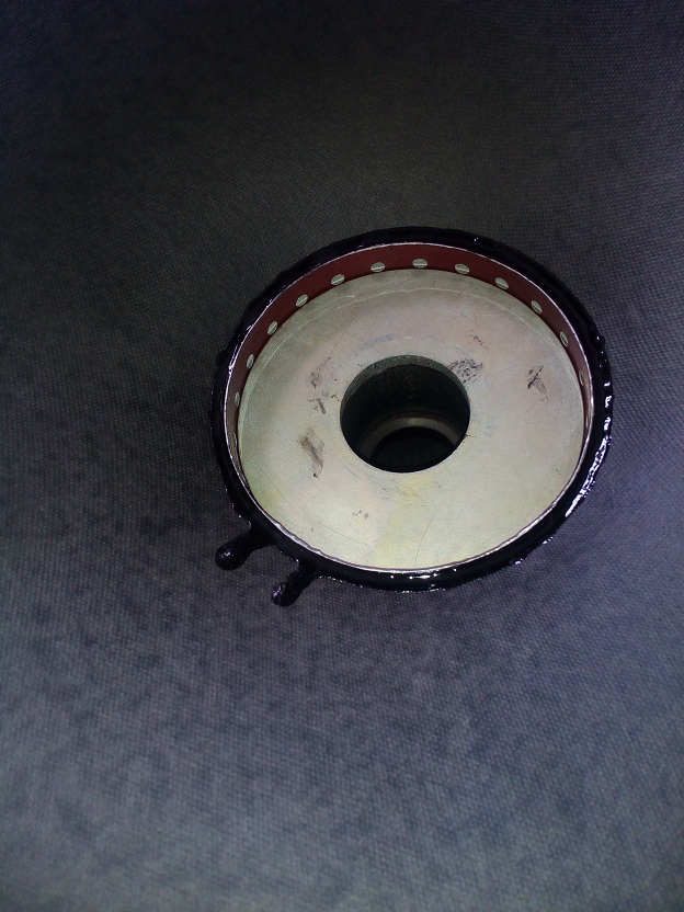

I have a second pair of K130 with wavy (defected) cones. I may try to recone them with hemp cones and use paper caps just for interest.

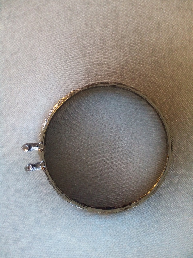

Right now one of the open questions for me is how to protect the K130 from kids. The grills I can find for 15" resonate quite much and are ugly. Does anyone have any suggestion?

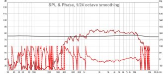

I feel it is time to update the thread with my latest observations.

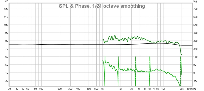

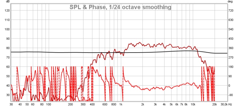

I received QSC clone 1” waveguides and Faital HF108R drivers. In a few hours I was already trying them out in a 2-way with my selected JBL K130 midbass woofers. Faital drivers from the start showed good dynamics, excellent details and impression of little or no listening fatigue. I liked them.
My first attempt was to have a crossover point around 1200 Hz with 3rd order crossovers and with this configuration I was not very impressed with the sound. It was dull and lifeless. The HF108R could perform well without noticeable distortion on the waveguide this low, but it just did not sound good. Then I tried different crossover points and the one I liked best in 2-way appeared to be around 2200 Hz. Having a 15” woofer playing this high brought a lot of dynamics and life into the sound. In fact, I was truly impressed with this combination, especially the dynamics. Overdriven guitars sounded awesome and very natural on any record I played. Like listening to a guitar cab. By itself it is already a great indicator and an achievement for me.
The next day I built a rig with both, the HF108R on QSC and the Renkus Heinz 3301 2” driver to try the system in 3-way. For now of course I used a DSP and active filtering to achieve smooth response. I also made two presets in the DSP so I could switch between 2-way and 3-way directly. So I ran an A-B test comparing the 2-way and 3-way.
The 2-way config: the JBL K130 60 to 2200 Hz, BW 18 order filter, some EQ on 800-1000Hz. On top the Faital HF108R on QSC clone, BW 18 order filter, 2400 Hz and up, EQ on 3-6k. Speakers in the same polarity, no delays.
The 3-way config: the JBL K130 60 to 1400 Hz, BW 18 order filter, some EQ on 800-1000Hz. Midrange: Renkus Heinz 3301 on Renkus 820 horn, 1600 to 3500 Hz. On top the Faital HF108R on QSC clone, BW 18 order filter, 4000 Hz and up, EQ on 4-6k. The midrange horn in reversed polarity being on a longer horn, no delays.
I dedicated about 14 hours listening to this mono setup. Different styles, recordings; switching between configs continuously. To sum up my audition experience, the 2-way kills with the dynamics. I got impressed with every new song. Especially liked the way guitars sounded. The cons: the sound gets too sterile like studio headphones and after a while I got a little tired listening. After switching from 2 to 3-way, this comes to mind: “Wow, the 2-way is awesome, but the 3-way is the one I would keep at home for myself”. The three way really brings even more life into music, it becomes more 3-dimentional. Even though it lacks a bit of dynamics, it is much more musical and triggers more emotions when listening. For me this appears to be important. I got to know an interesting expression today, it sounds something like: “Art can be evaluated by the amount and quality of emotions a person gets while experiencing the art”. Based on that, the 3-way config is a sure win for me.
So I finally decided to go 3-way for the top-speakers, a 15” midbass and two compression drivers with 2” and 1” throat. The horn I used during auditions for the 2” is not a good option for home use due to multiple slots. So I ordered and already received a pair of 18"x10” ebay horns discussed here to be good for home use. I also ordered a pair of 18 sound XT120 horns since I do not need the Faital driver to play low. I have much hope for this combination and this time almost sure I will proceed with them to final build.

Below is the measurement of the Renkus-Heinz 3301 on the ZXPC horn, 1,5 meter. The driver is connected with 15uf capacitor in series and a 16 ohm L-pad. I plan to use it in the range of 1,3-1,5 to 6 kHz and I think it measures quire well there.
The other graph is the HF108R on XT120 connected with 10uf capacitor in series and a 16 ohm L-pad. Will be used from 6-7 kHz and above. Quite a sharp crossover will be needed, most probably 4th order, but apart of that it looks quite good as well.
One problem I have to deal with is a time alignment between the mid driver and the tweeter. Now when prototyping it with active crossover I tried to connect the tweeter in different polarity and neither option works well because drivers are about 100 offset being mounted on the same front panel. To mount the tweeter another way with this horn I do not see as a suitable option.

I did another experiment that some of you may find interesting. Out of my collection of JBL K130’s there was one with a good cone, but some imperfections on the dust cap. I have decided to replace the dust cap with a paper dust cap. So below are some pictures of the process.
The frequency response of the speaker before and after upgrade is almost identical up till 1,5-2 k, where the paper dust cap starts to roll of naturally while the aluminum cap extends up to 6-7 k. The advantage of the paper cap for my application is the smoother response, less resonances on the highs and easier crossover integration.
The drawback is however that the paper cap is a few grams heavier, which together with added glue resulted in 5-10 gram MMS increase; Fs has dropped 5-10 Hz. When it comes to listening impressions, the paper cap definitely makes the speaker to sound smoother and easier to integrate, but on the other hand more dull and lifeless. The “live” and dynamic feeling I was fond of in the K130 was partially gone with the paper cap.
I will try to upload TS parameters of the K130 with aluminum and paper dust caps as well as impedance curves later today.

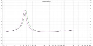

In the attachment there is an impedance curves of the k130 with stock aluminium cap (green) and paper can (pink).
As promised, TS parameters for both:

I whish I could comment but my experience on bass bin is very limited.
I had the 3rd down from your picture (tmww) and it worked best
-Mostly due to spread floor reflection giving me 2 different cancellation frequency
Angling the bass bin backward so each woofer distance to my ear is the same reduced the C-T-C peak cancellation considerably but didn't removed it completely.
Ideally, crossover shall be 250hz or less but I have 4 ways already and have to accept tradeoff...
On it's side, it was worst on all aspect and it's the way my bassbin sit right now...
T
M
WW
My 4x15" bass bin will be diamond pattern
M
T
W
WW
w
So I hope it will "maximise" the smoothness of the floor bounce cancellation.
I'll also angle the bassbin inward.
Keep a eye on my site in my signature, I'll update it once the bassbin are playing
