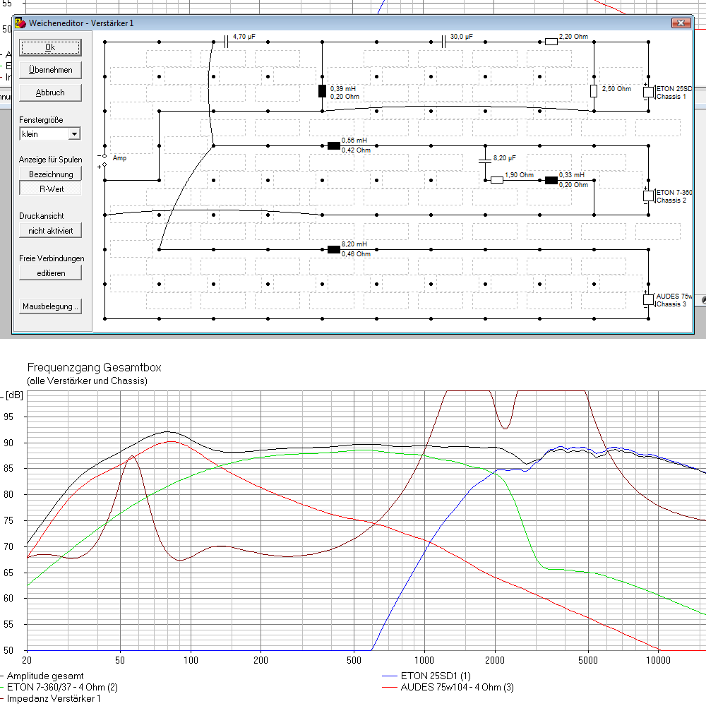

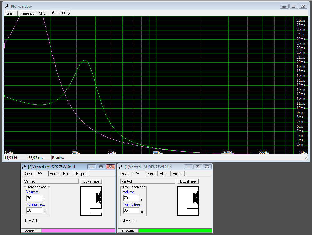

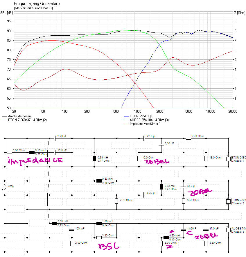

Oke
1.
35Hz instead of 20Hz
In Unibox i found : Xmax is oke at 40W but at 130W excursion is too big, but I guess 40W is enough for my parents.
2.
separate closed enclosure for mid 10liters
means a little less bass output
3.
seperate bass reflex enclosure for woofer 70liters instead of 80liters is oke; it means a little less bass output
4.
removed the 27mH/cap/resistor but now I get a little bump around 80Hz
5.

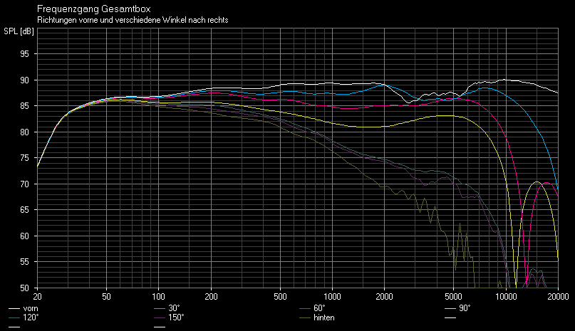

BSC? baffles step compensation / correction
Is this a good solution, I understand this BSC as compensating for the loss of low frequencies because of it's less directive nature. But my parents will listen mostly off axis, so I would think I better compensate for loss of high frequencies.
architect said:
Oke
4.
5.
4. Could indicate a bit too small box, otherwise it looks ok, but maybe woofer series coil could be smaller, and maybe with a smallish paralel cap(maybe connected to ground with resistor=RC)
You may need a series cap on midrange...and a paralel RC
Maybe play a bit with series inductor
Tweeter series cap may be just a bit too small, try 5.6uf(standard value)
Paralel 0.39mH could be too big
Try smaller connect with a resistor to ground
5. NO...on the contrary...a well adjusted design sound the same almost everywhere, it doesnt change character...it may boom too much in some places, whish is much worse

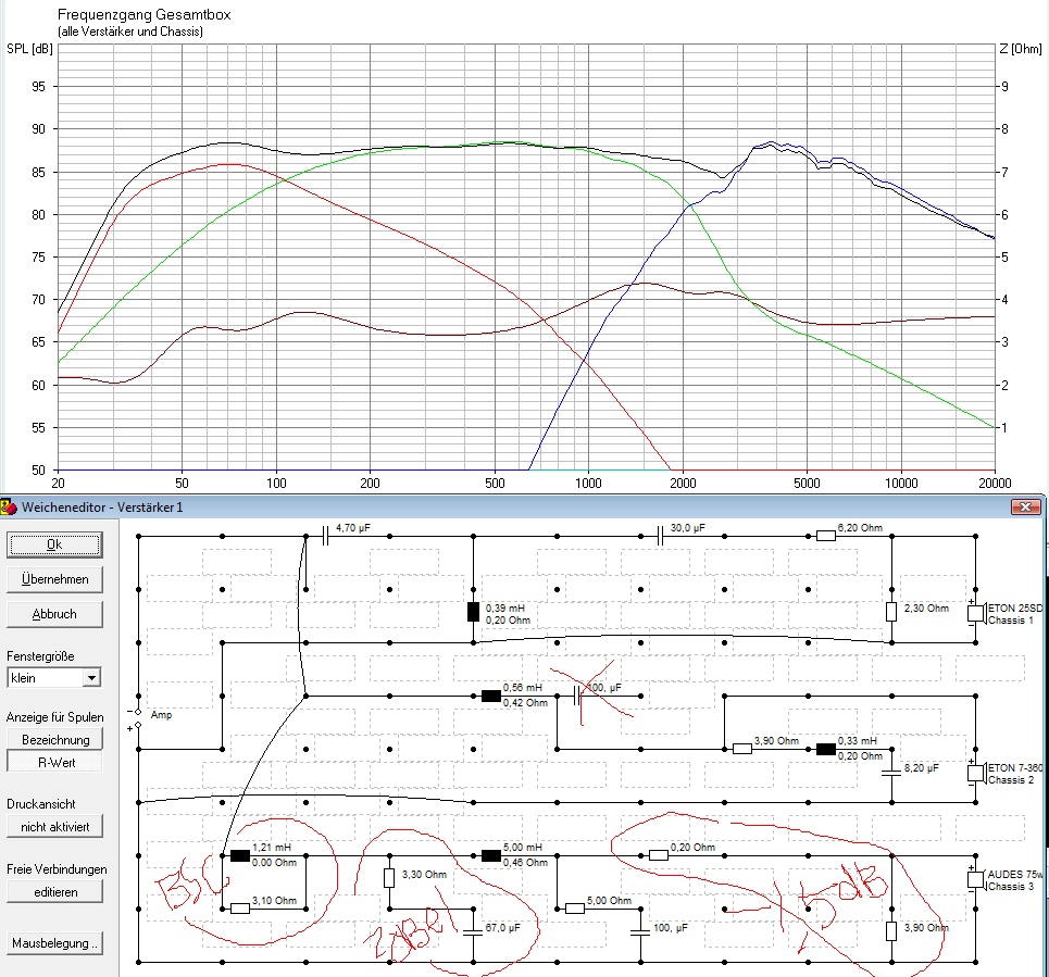

improved XO
added zobel
added BSC
both improved freq-curve and impedance
at lowest frequencies impedance is about 2 ohm, is this problematic. my dad also needs another amp, any advice on what to look at?
crossover any advices?
Woofer xo is the other way round...big inductor first
Preferably only one zobel
1.21mH with 3.1ohm could be used good though...try to connect a cap after 3.2ohm...which means in series with resistor and both paralel across inductor
Midrange
Still think it needs a small zobel...like say about 8.2uf - 8.2ohm
Looks like you need to raise xo point about 500hz
Tweeter
Try make 30uf smaller
Attenuation wrong...series resistor always small and the paralel big
It may not show on sim, but you will like a zobel on tweeter too
As said it seems you have reversed mounting on curcuits and components
Fore one I always have resistor to ground
And biggest component in a curcuit first
Again, I strongly advise to caculate with standard values
I said "biggest" components first...I referred to woofer xo, lowpass
Highpass is the opposite..."small" components first
Sometimes I get them mixed up :clown:
btw, theres a lot to learn from looking at a crossover like this...Troels seems to change his style a bit, and using the special notchlike filter...he may use it as the sole curcuit on a driver, and must like it a lot, as he seems to use it in every new design
I have used that special "notch" fore quite some time now, but solely on woofers and only as a supplement, but maybe one should consider to use it in other places as well as it seems to work/sound very well

zobel moved, very effective on impedancepeek
woofer
notch added for 10" woofer instead of attenuation
BR @ 30 Hz
mid
inductor on smaller
tweeter
4,7 uF cap replaced by 2,2uF
30 uF cap replaced by 22uF, when smaller of axis becomes worse

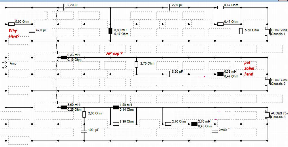

some remarks on the filter:
- I see the mid is left unfiltered at the bass end, which is the cause of the <2ohm impedance in the bass. if the amp can handle it, OK it might sound good, but you could consider a HP condensator there (might also influence the filtering of the bass)
- you have only a single coil for the mid, and no zobel to compensate for the rising impedance, which renders the filtering ineffective towards the higher frequencies. i suggest you put a zobel there
- what's the use of the zobel in the tweeter network? and it seems to me in a strange location...
:nod:
Further, best get rit of woofer notch
Instead try a cap on 1.8mh/3.3ohm...in series with and after 3.3ohm, both still in paralel with 1.8mH
Try 8.2-12uf...3.3ohm is probably too small, try 8.2-15ohm
Woofer zobel...smaller cap and bigger resistor
Paralel curcuits...as said before, I have the resistor connected to ground, but cant say if it makes a difference
Zobel on input before xo...not sure its a good idea

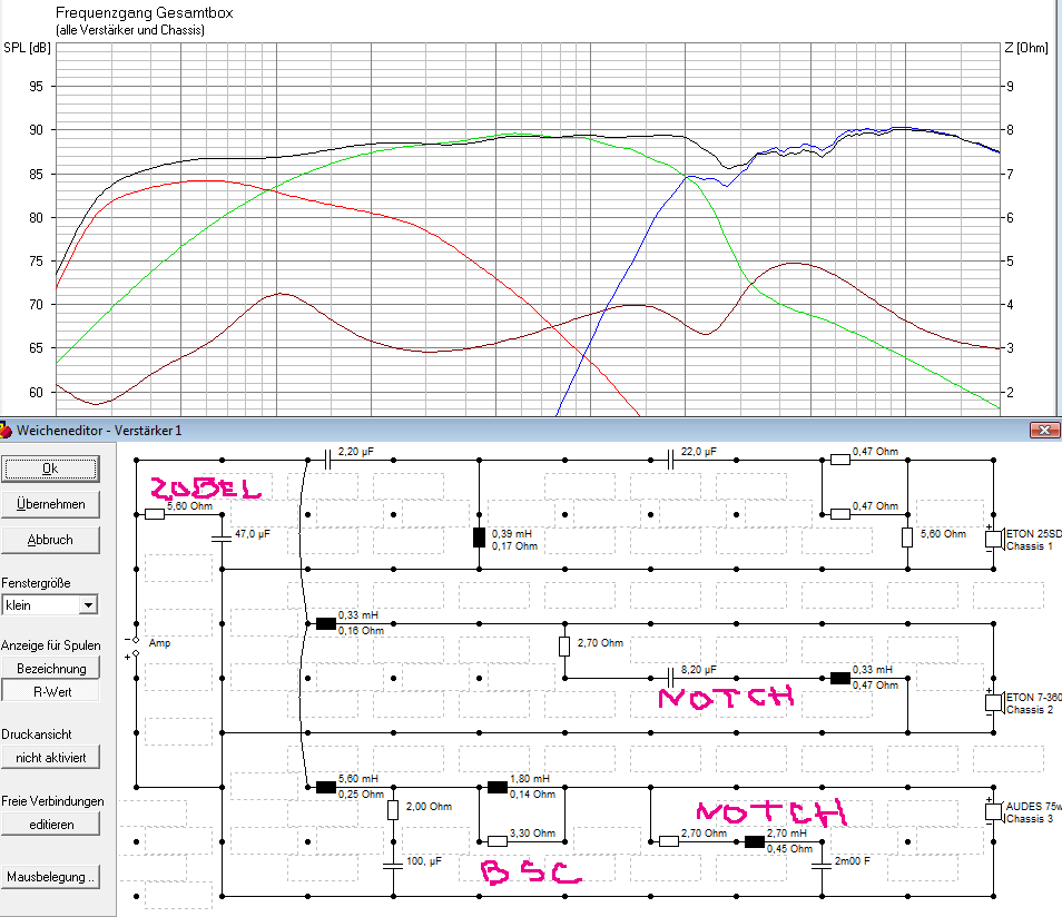

Oke another improved filter.
Henkjan, what kind of cap sould you advise on the mid? when I try 100uF The curve is very ugly with a kind of bump at 75dB; not a nice fluid curve. I thought it would be a good idea not to use bipolar caps on the mid so if I'm right 100uF is about the max. When I add an inductor after the cap and parallel to the mid I need to change poles on the woofer and mid and tweeter should be attenuate to match the basswoofer. I'd like some advise on this point. But you are right, impedance at lowest frequencies gets better.
zobel on mid added
zobel removed but zobel and impedancecorrection for tweeter added; both seems to be effective
notch on woofer not removed, helps to keep bump out of responsecurve, I changed some values to improve impedance.
I tried the suggestion of parallel cap and larger resistor on woofer but this seems not to make the curve any better. I changed them backwards to old values. (not yet in added picture)
zobel for woofer also straightens off axis responsecurve
resistors have been put at ground-side
Better 😉
Zobel cap on mid looks big
And your zobel resistor are small
Also, using sims doesnt mean that theres no need fore measurements
You will just have to use listening instead
Anyway, the "final cut" cant be done until its playing
