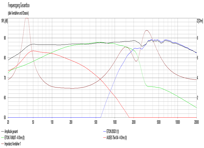

I've modelled with Boxsim on TS-parameters but I've not measured the drivers.
Here I have a frequencycurve which looks good I'd say.

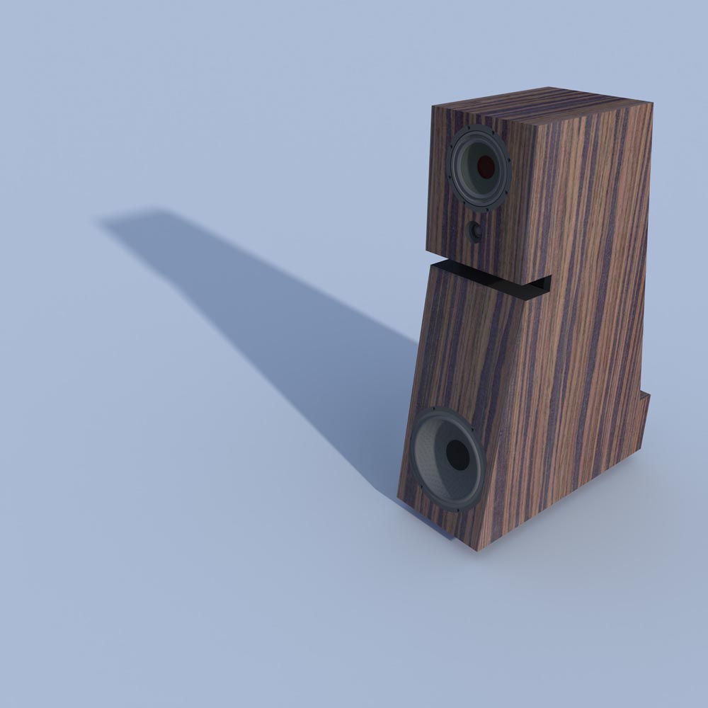

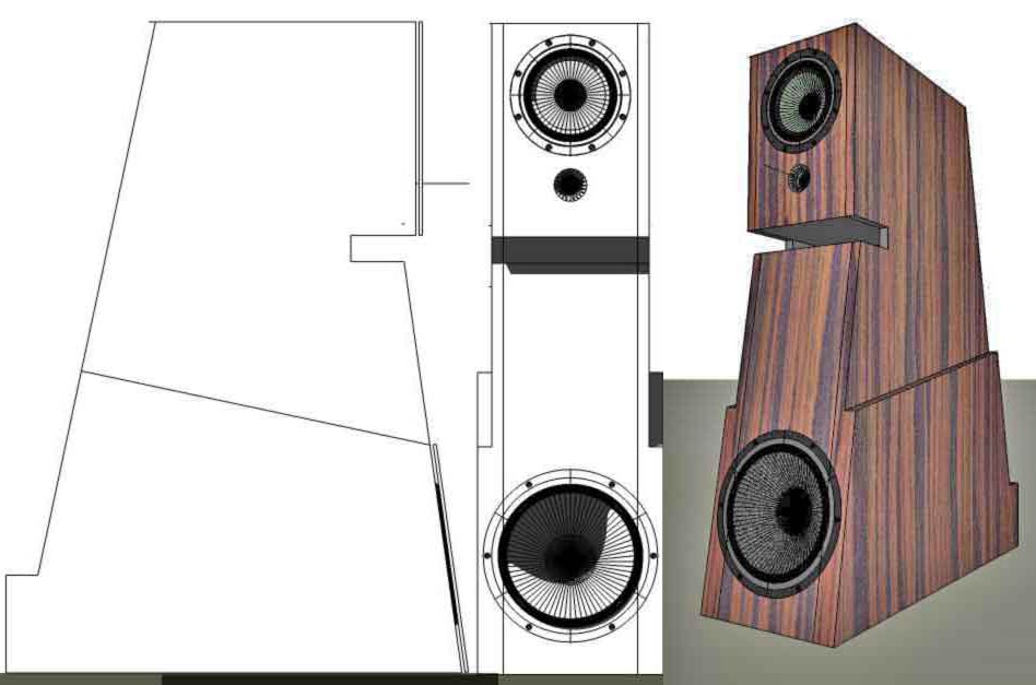

Picture made in Sketchup. The bassreflex-port is in the middle because of eastetics and calculated at about 20 Hz. I was wondering whether it's oke to say that both drivers mid and woofer use the same 80 liters? How can model the bassreflexport with two drivers on it?

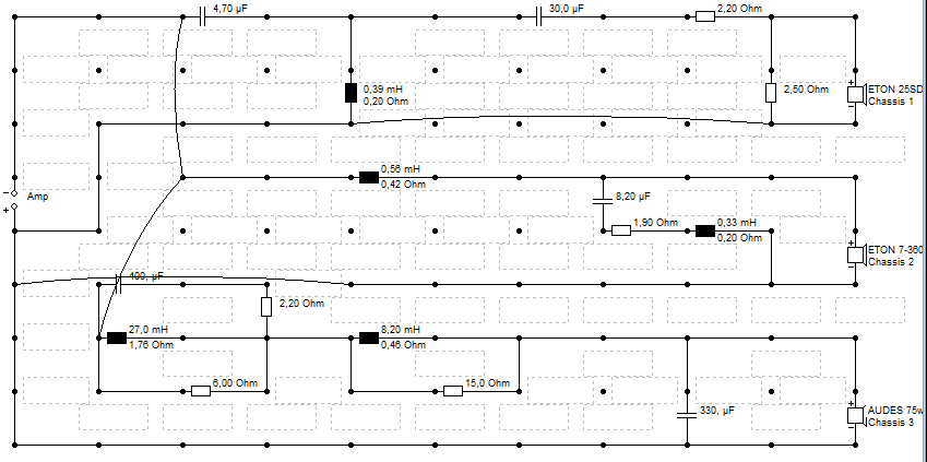

This i my thirst own crossover. Before thisone

architect, looking at the cross section of the box in post #11, it looks like you are having the same box for woofer and mid....do you think it's a good idea for the midrange driver to be exposed to the woofers low frequencies? Its going to move like passive radiator in low fr area. May be I am wrong, but I would keep em separately.
adason,
he is trying to use the same box tuning for both the bass and mid bass drivers. Still not a good idea.
architect,
see if you can perhaps expand the mid bass cabinet a bit (and separate from the woofer) so you can reach the desired 100Hz roll off. Either that or consider running the mid bass with an open back and raise the XO point of the woofer to accomodate the back wave cancellation.

about 80 liters bassreflex at 20 Hz
How is that with Fs at 30hz and Xmax of 4.5mm and 80liter
If its with a very long port, dont do that
It looks more like 35hz, which is very good too
But it seems ok to loose some box volume fore the mid chamber, as it seem you are close to get the same bass rolloff with about 70liter netto
You asked how to model two ports
Just use the summed area of both ports
About your box design
Have you calculated the listening height

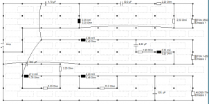

Theres a paralel notch with 27mH in series with woofer what thats good fore
27mh, thats a big one, and in series with signal may not be so good
or do you know something I dont, is it EQ or....?
I have had curcuits on woofer and mid to remove low end ressonance, as I have learned to do so, but I have found that it work ok without and seems to sound better too - but those were series notch in paralel with driver
Also the paralel cap on woofer is awfully big, may not need to be that big...cheaper and easier when smaller
As Pete suggests, you may want to let the woofer play a little midbass
Also Im not sure its too good to have the woofer right down at the floor
