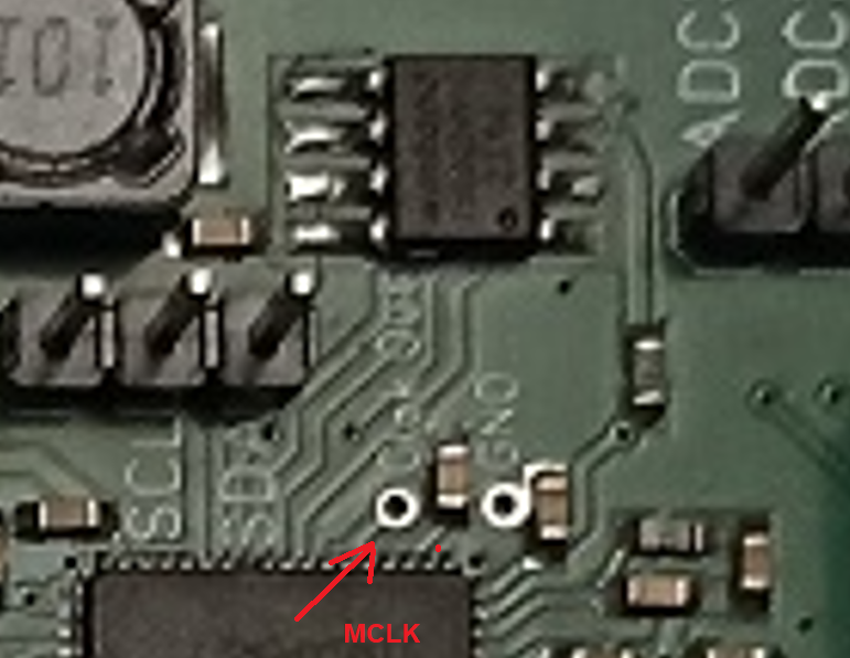

Also, if you really want, you can take the master clock for the ADC from the amplifier board, if you look closely on the amplifier board there is a master clock output from the ADAU1452, the frequency of which can be adjusted in the adau. But I think this is unnecessary, I think an ADC operating from its own clock generator in master mode is quite sufficient.

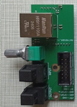

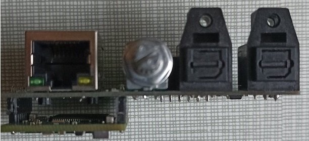

This module is very easy to connect to the 3Way DSP Amp using this input board.
I want to know your opinion - does it make sense to assemble such input boards without the Network Transmission module, at a price of 15 dollars?
Will they be of interest?
Or is this a very rare and little-demanded data transfer protocol in DIY?
Created a thread on this solution. Anyone interested in this solution can ask questions in the specified thread.Will they be of interest?
https://www.diyaudio.com/community/threads/3way-dsp-amp-adapter-for-dante-aes67-board.426074/

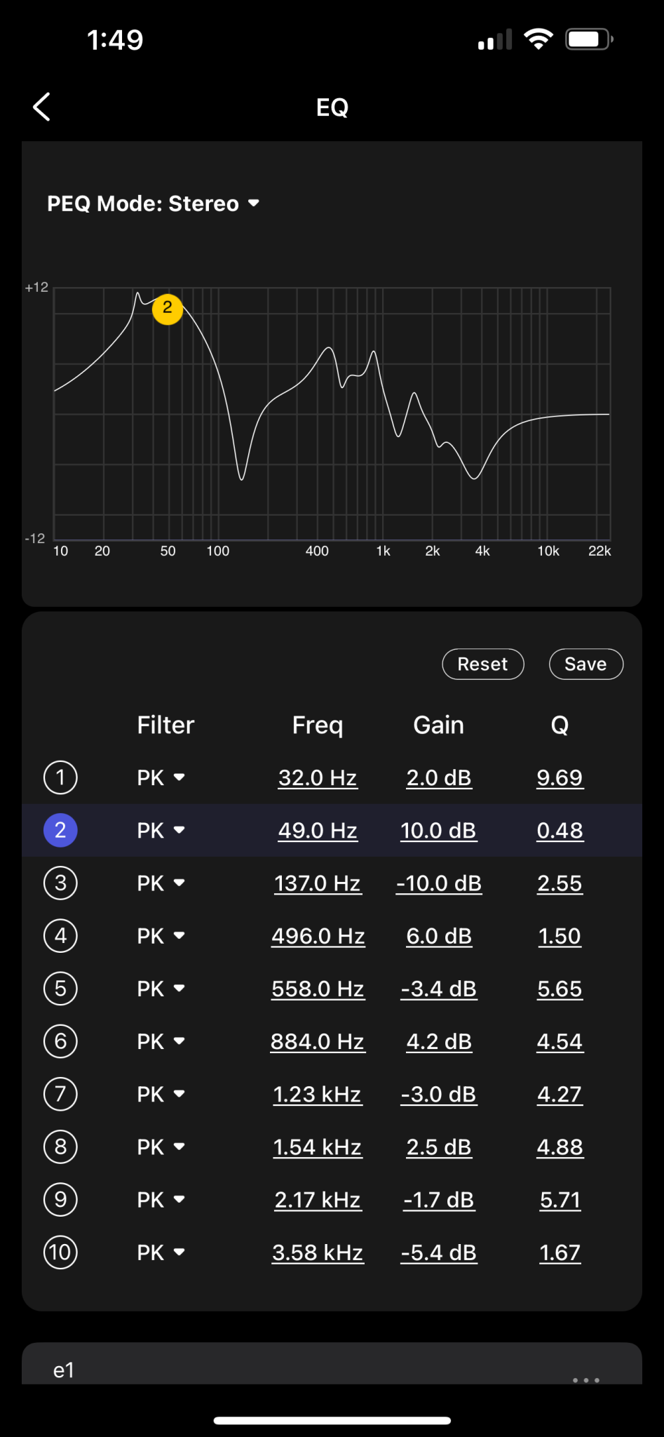

A DAC like this arrived and I liked it right away as soon as I turned it on. The sound is very transparent and airy—especially for jazz, smooth jazz, and similar genres. What I really like is that I can run the optical output from my WiiM streamer straight into the board’s optical input, so no external DACs are needed. I set up room correction in the WiiM and ended up with this graph:
This board is interesting because you can spend a lot of time tweaking the sound.

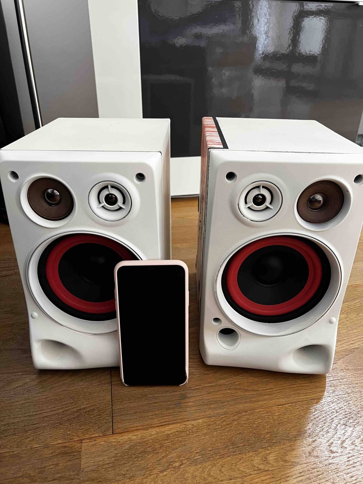

To prepare for this, I bought a used set of vintage three-way bookshelf speakers—JVCs made in Belgium!
For now, I’m not planning to make the speakers fully active. I’ll keep the amp as a two-channel unit in its own enclosure and run six wires to one speaker and six to the other. Then I can keep tweaking the response. In short, a creative person will have enough to keep busy until the next century!
