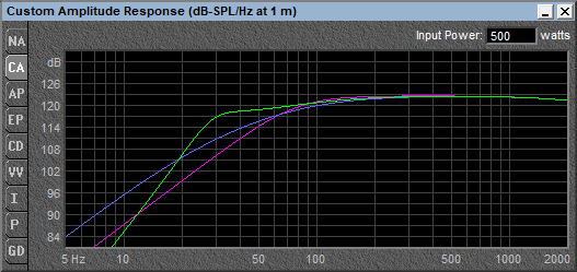

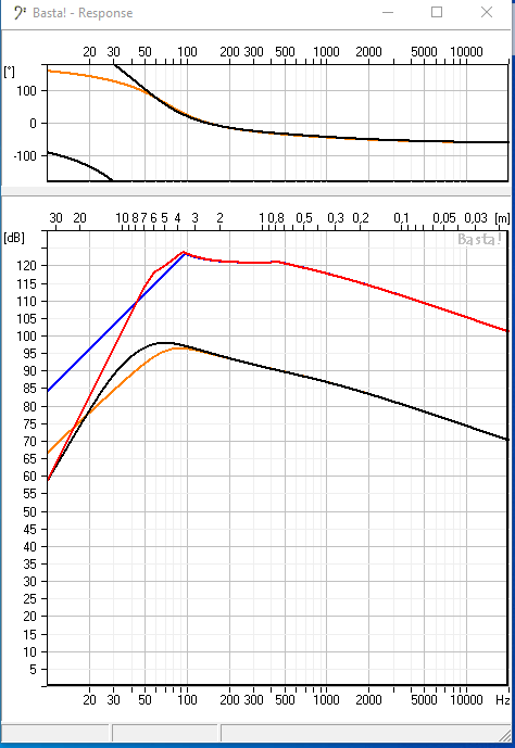

Been speaking to John at ae
He’s suggesting 4-6 cubic feet ported for the td15h+
And sealed for the td10m in .25 cubic feet for a a of .707
I could maybe go 4 cubic feet tuned to 27hz but it’s a big speaker
Maybe 38” tall 18” wide 17” deep for roughly 5 cubic feet made from 1” mdf allowing 1 cubic feet for mid, tweeter enclosures and bracing.
Like a Daniel hertz m4
Or sealed side firing 38” tall 12” wide 17” deep giving 3.1 cubic giving roughly 2.1 cubic feet for the sealed woofer and 1 cubic feet for the mid and tpl
Like a mini tweek geeks Bmf -1
Crossover will be mini dsp thinking steep slopes
1.5-1.7khz for the td10m - tpl200h
And a low crossover to the td15h+ maybe 100hz
Anyone got any input on ported vs sealed
