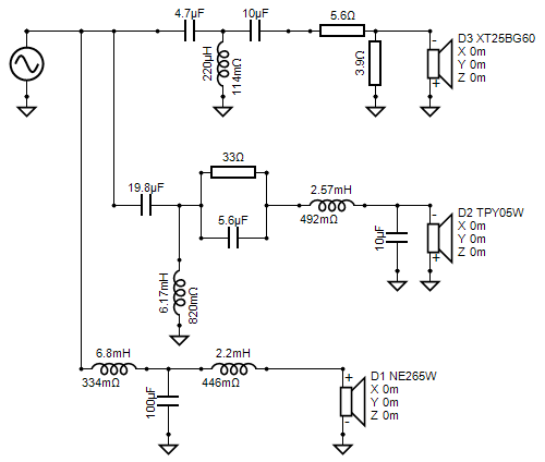

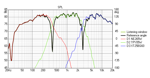

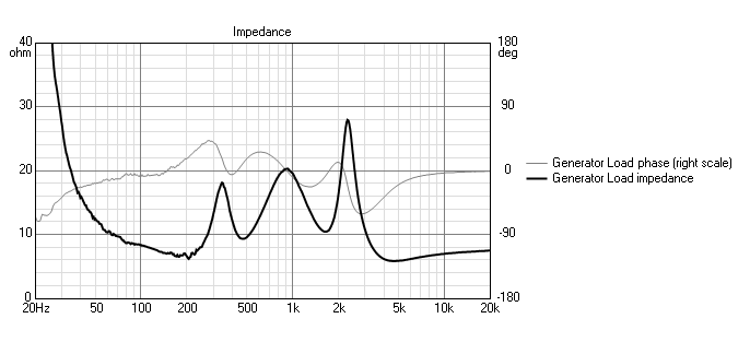

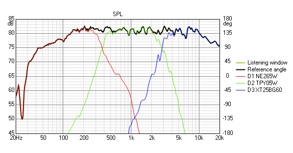

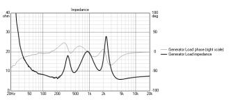

Here's my attempt. Not perfect phase alignment but might give you a comparison with your own. Rename the .TXT = FRD if you want to use the same response curves (I applied an estimated baffle with step and diffraction).
Box is 41L vented for woofer, 15L sealed for midrange (I like large sealed midrange enclosures)
Target sensitivity ~ 82dB (allowing for 3dB BSC)
Woofer Fb = 30Hz with a 102mm diameter port at 557mm long (will require an elbow)
Baffle is ~650mm (H) * 314mm (W). Allowing for 10mm spacing between drivers and port. Depth to be calculated allowing for total volume (41L + 15L + port + bracing).
Driver Z offsets used = 90mm for NE265 and 26mm for TPY05, assumed tweeter design axis.
Xmax is reached at 160w input. with max port velocity at 18.6m/s (acceptable).
