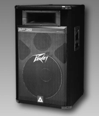

The Audax PR170N0 6.5" is used in the Peavey SP3 and Peavey SP3G speakers with the 15” BWX/KADT Black Widow.😱Another possibility is this xover from Peavey ECS 3X (500 Hz/2500 Hz)
Nice find. They tune it to 58 Hz, which produces a nice flat response and sharp knee in my model.
Yes. Maximum power for linear excursion is around 40W. A 98dB/2.83V/1m Speaker makes a heck of a racket with that.

Now then a question, Loren, you said after Thorsten pointed out that the box for the Peavey could be a vented one,
" I would recommend using the box frequency Peavey uses and set it at 58 Hz. F3 will be 59.5 Hz. For that alignment:
Box is 3.5 cubic feet
vents would be two 4" diameter and 1.23" long each."
Will that still apply for the 2 way? I guess it could right?
