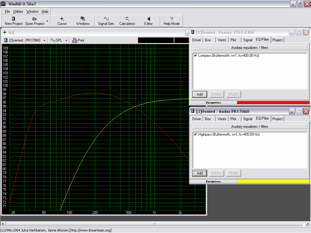

What's the point?
The Peavey F3 is 125 Hz. If the Audax F3 is 190 Hz. Crossed at 200 Hz, or even 400 Hz, the Peavey is doing virtually no work in the system. Actually, it is worse than that.
The red trace is the Peavey. The yellow trace is the Audax.
The Peavey makes a better wide range mid than the Audax!

Well, not sure what boxes you are modelling.
If I use Winisd to sim the Peavey in 150l tuned to 40Hz and then use a nominal 400Hz 1st order crossover to the Audax (with some fudge factor to compensate the fact that TS parameters do not describe the audax well at all above around 250Hz) I get the attached with a system (after XO) f3 of 45Hz. So to me this combo makes a lot of sense.
Ciao T
Ciao T
Ciao T
Nice work.
I see your point, but have you investigated the cone excursion for the vented alignment?
The Xmax is only 1.5 mm and when I modeled that driver in a vented enclosure at 40 Hz and 100 Watts and had Xmax exceeded before Fb. In fact, it exceeded Xmax at about 75 Hz.
My box was a 3.5 cubic foot box.
I would not vent the Audax. Any reason why you choose to do that?
Also, what were your box parameters for the Peavey? I would like to see if I get the same results as WinISD.
I would also like to know where Xmax is on your design?
