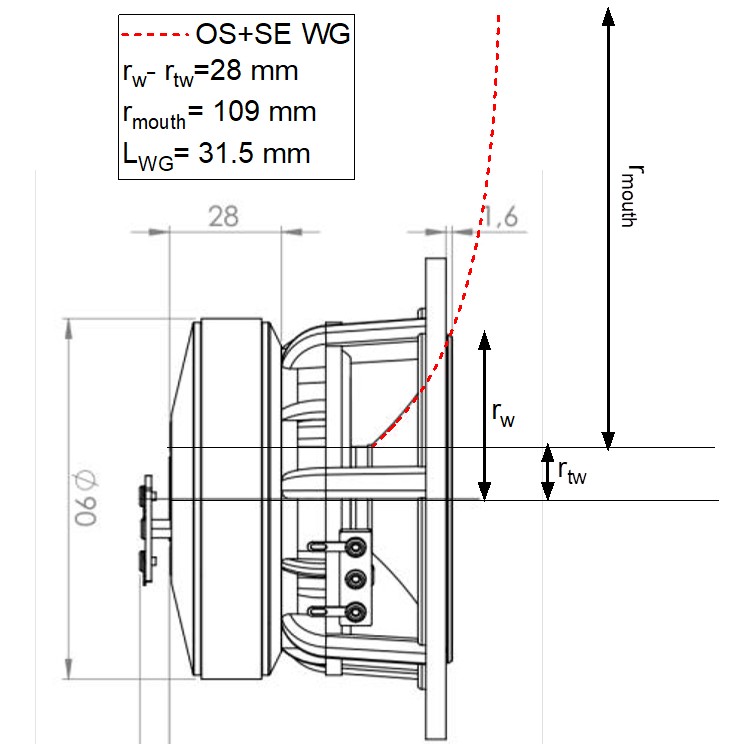

I already did some sketching with the Oblate spheroid+superellipse WG shape. It can be matched quite nicely to the Cox120 cone using OS-SE curve that would result in a WG with a diameter matching the woofer size. Next step would be to simulate the directivity of a wide surround dome tweeter in such WG.

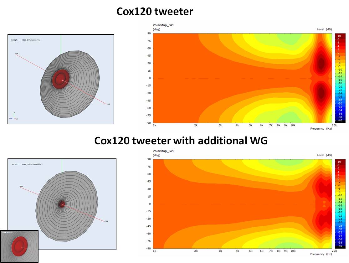

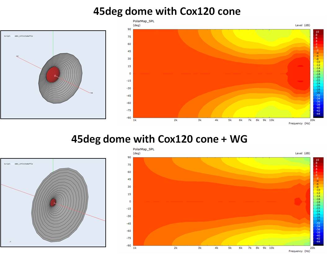

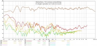

Meanwhile, I did some simulations for Kartesian Cox120 with Ath. First attachment is simulated for what I estimated as the geometry of the tweeter based on the driver drawings and pictures (not precise). The second attechment is the result for an imaginary dome that meets the cox120 cone in a nice angle without any steps or gaps. Both figures show results with and without the additional OS-SE waveguide shown in post #2. I used circular symmetry and infinite baffle for all simulations. The results from rough 3D simulations are similar, but I didn't have time to do detailed testing without circular symmetry. The WG seems to improve tweeter directivity by an octave or so. The response doesn't look very nice for the highest freuqencies. The result is cleaner for the "optimal" dome. I think I would need more accurate data for the tweeter geometry in order to get anything reliable for the highest frequencies.
Kartesian Cox165_vPA reviews?

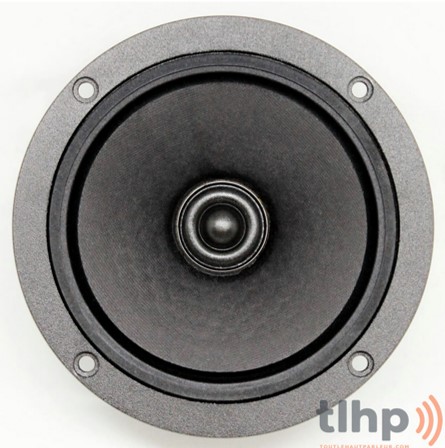

That Cox165 looks really interesting. There is a smaller sibling (120) but seems far away spec wise from the 165. Interesting project - good luck!! Following!
Yes, 120 seems to have details right - tweeter sits nicely and cone edge/surround is pretty smooth. Response gets ragged around 3-6kHz but much better than rivals.
