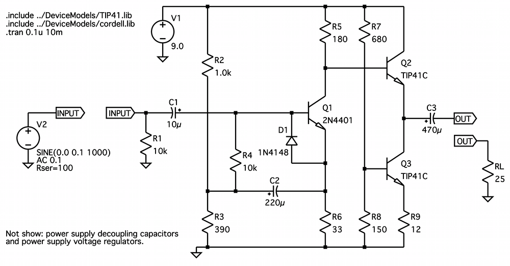

The input impedance of your last circuit is (roughly) 10K || 2K || 470 || (Q1.hfe * R6).
So it's a bit low for an amplifier.
As far as feedback goes, your output is 180deg phase WRT input, so if you feed back from Q2 emitter to Q1 base, you will be fine.
You need to have a resistor in series with C1 (on the amp side), and play with that value and the feedback impedance value to adjust the feedback ratio.
Of course, you will have to bump the VAS gain, playing with R5/R6 values.
Also, is you feed from Q1 emitter to Q3 base, you should be able to turn Q3 into an active current generator, possibly lowering the class quiescent current.
3-Transistor HeadAmp with feedback

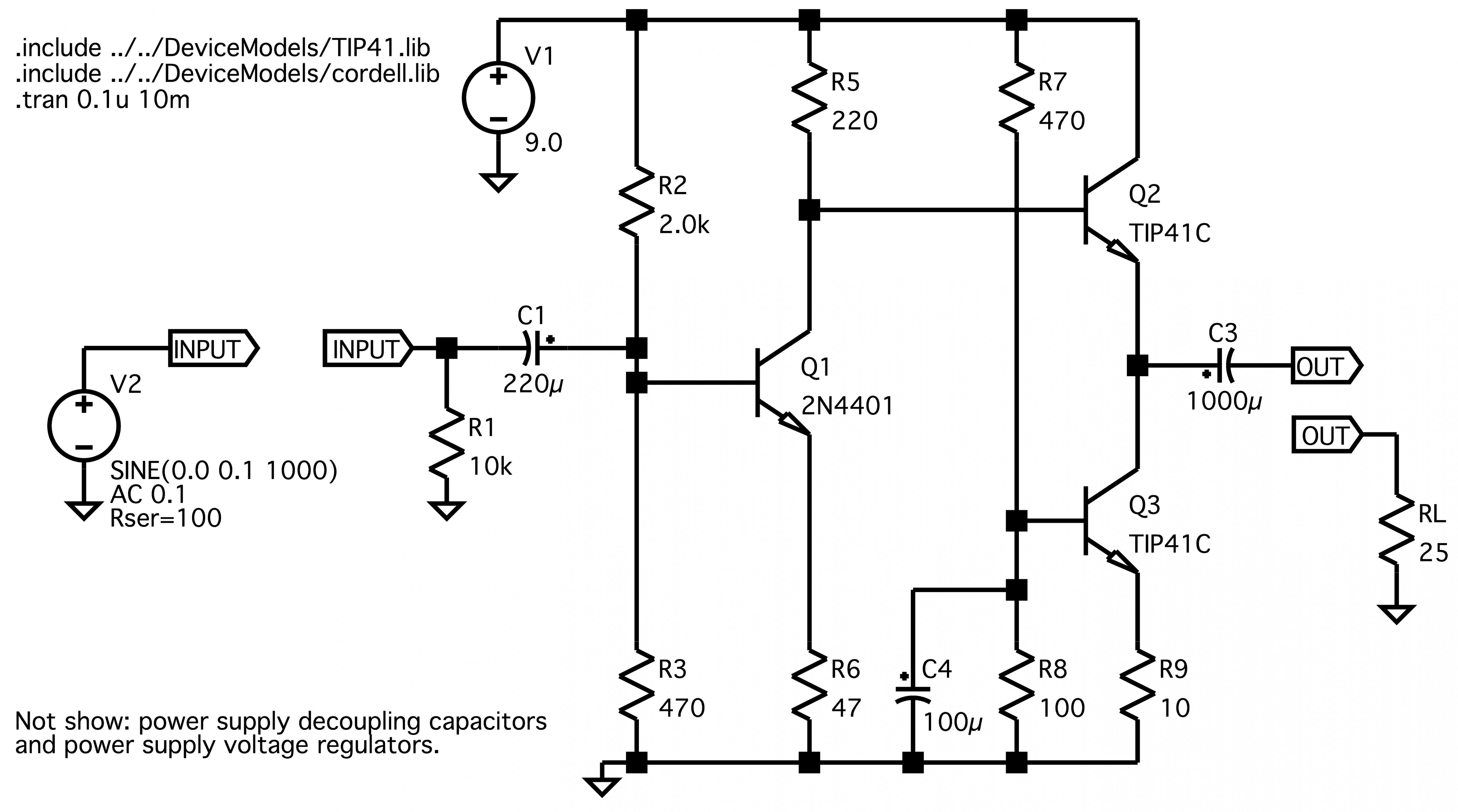

Hi jstott
I know its been a while, but I only just read this thread recently, but better late than never!
The design is refreshingly simple, but with simplicity comes certain problems. In this case the (lack of) real PSSR.
This problem could be solved with proper negativ feedback. The challenge is do it with just 3 trans, but I believe I have come up with two solutions (see attached schematics and tlspice files).
In the first attempt, I basically switched Q2 to a PNP and added NFB from the output to emitter of Q1 thereby forming a Complementary Feedback Pair (CFP). A note: I've tried to separate dc-feedback and ac-feedback in order to make the gain independed of the dc operating point. The performance of this circuit is (with respect to distortion) is quit depended of the load. I have a pair of Senheiser Momentum with an impedance on 18 ohms, they do require a lot current, hence the rather large output capacitor. Further I added a capacitor at the input bias scheme, in order to (further) increase the PSRR.
In my second attempt, I sacrified the constant current, and went for more available gain. Basically this means I had to double the standing current, now more than 300mA. Also the dc voltage on the output should be closer
to 6V in order to have more negativ drive.
I havent physically build any of them (I intend to!), but they both sims quite allright (2nd and 3rd order harmonics below 0.1% before clipping) and PSRR in the order of 40dB and better.

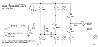

Here's another take 🙂
Of course, there are variable resistors for biasing (R2 and R7).
As it is, the above is of course likely to be subject to thermal runaway, unless, instead of R7, a proper compensation is implemented (which requires another BJT or a couple of diodes).
Alternatively, instead of Q2 and Q3 being BJTs, something like a complementary mosfet as TN2640 / TP2640 are used.
These are thermally stable, fast, have low Vgs-on and have relatively small input capacitance.
