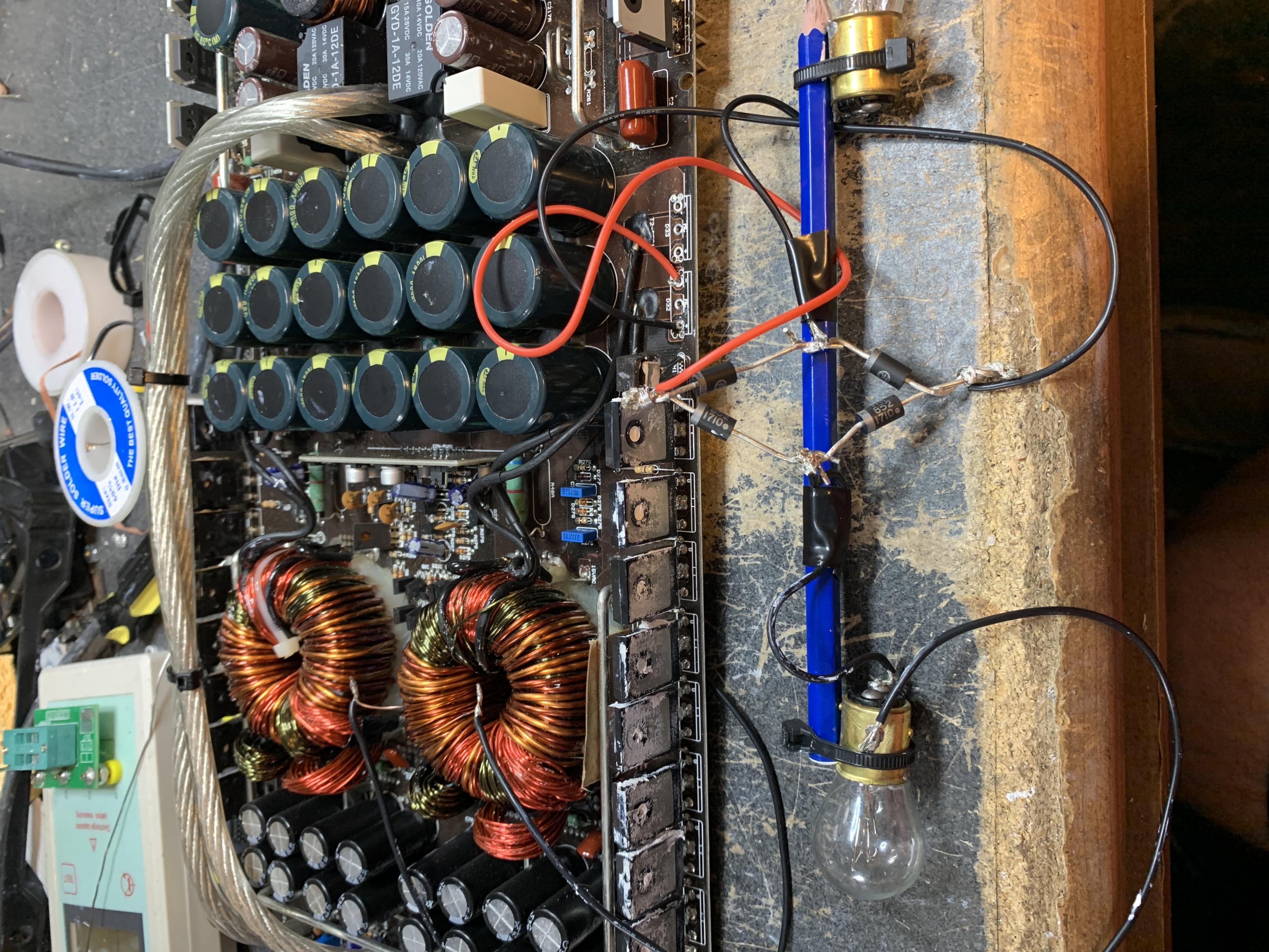

Hey Perry. I finally got around to getting back on this amp. I built the low power jig and connected to the amp. Apparently I have connected something incorrectly because when I power up the amp the left light build flashes briefly and the amp goes into protection and shuts down the power supply.
Can you look over the image and left me know if you see anything wrong.

I can't see your entire jig. You should go from the ground on the bottom, around the transformer with about 5 turns then to the jig.
With only one set of 5 turns (perfectly fine), you would use only two diodes. The ungrounded end of the 5 turns would go to the lamp then to the center of the two diodes.
The attached photo shows using two sets of windings. The red would go to one lamp and the white to the other lamp.
I double checked everything with the jig. Looks to be connected properly.
I did suspect the jig at first. I disconnected it from the rectifier pads. Same issue. The I disconnected one side of my make shift transformer so it would be open and still I got the same issue.
