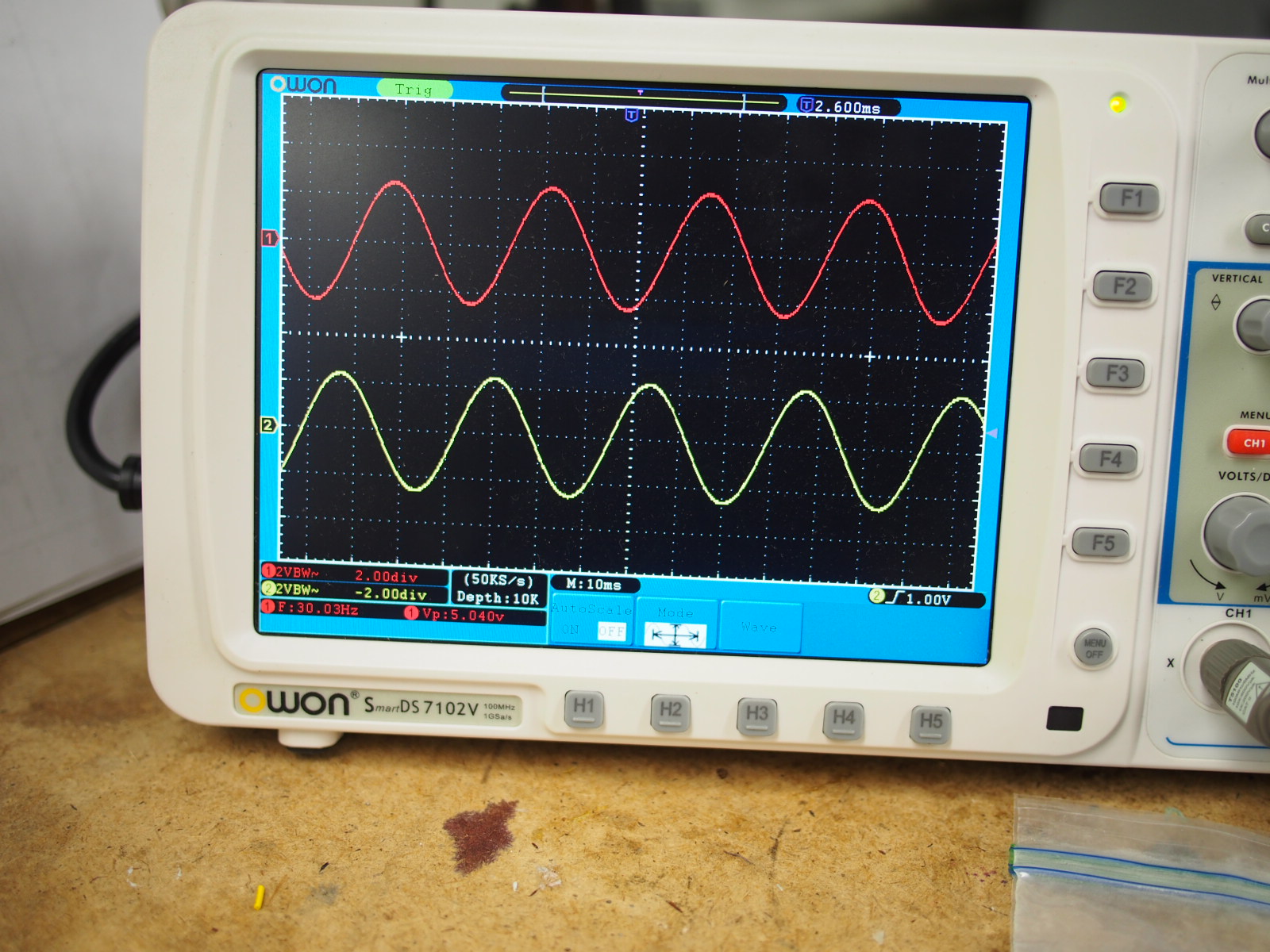

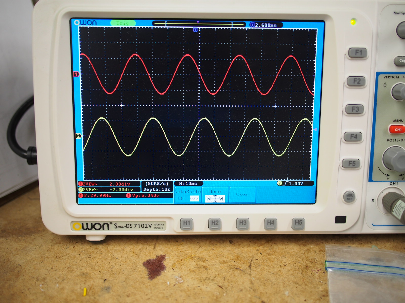

What am I doing wrong?
I have built my 4th SG4 and 2nd MA3, driving a BLWS motor.
Sometimes the motor starts in the incorrect direction (counterclockwise) and sometimes correctly. I have it connected according the instructions, name black motor lead to 0 phase; red to 120 phase and yellow to 240 phase.
I thought I'd check it on a scope to see if everything looked OK from a phase standpoint. It appeared that the 120 phase connection output was actually 240 degrees out of phase and the 240 output was 120 degrees out of phase. Thinking I had something wrong with the MA3, I checked the SG4 output directly, and got the same results.
The output from the 120 is in the first photo and the output from the 240 connection is in the second photo.
What am I doing wrong? I suspect that I might have some setting on my 'scope screwed up.
Also why would the motor start in different directions?
Thank you.

Do you have the scope settings for the two channels set to 'Chop' or 'Alt'? if the latter then what you see may well be affected by the trigger settings. In your pictures it looks like the yellow trace is being used to trigger the display(same relative position on screen).
It might be worthwhile showing a picture of the scope settings, so we can understand a little better what's going on.
As Ralph said, you will always want to trigger from the 0° output and use that as the reference.
The motor will run backwards if any two of the three lines are swapped. There should be no way the firmware can swap any of the outputs; it is hard coded and I've not heard of this before if it is a bug.
Is the motor under a severe load at start up? As the torque load increases, the angle between the rotating field and rotor will increase (this is what produces torque in the motor), but usually, if the angle exceeds 90°, the motor will just stall.
I was assuming that I have something screwed up on my scope. I thought I was triggering off channel 1 which is the 0 degree output. But this scope is new to me so I might go back to my older one.
The motor may be under a fairly severe load. It's a very heavy VPI platter (12-14 pounds) so startup inertia would be substantial. Is there a cure for this?
Remember it doesn't consistently run backwards - sometimes its correct and sometimes in reverse. This was what really threw me for a loop
