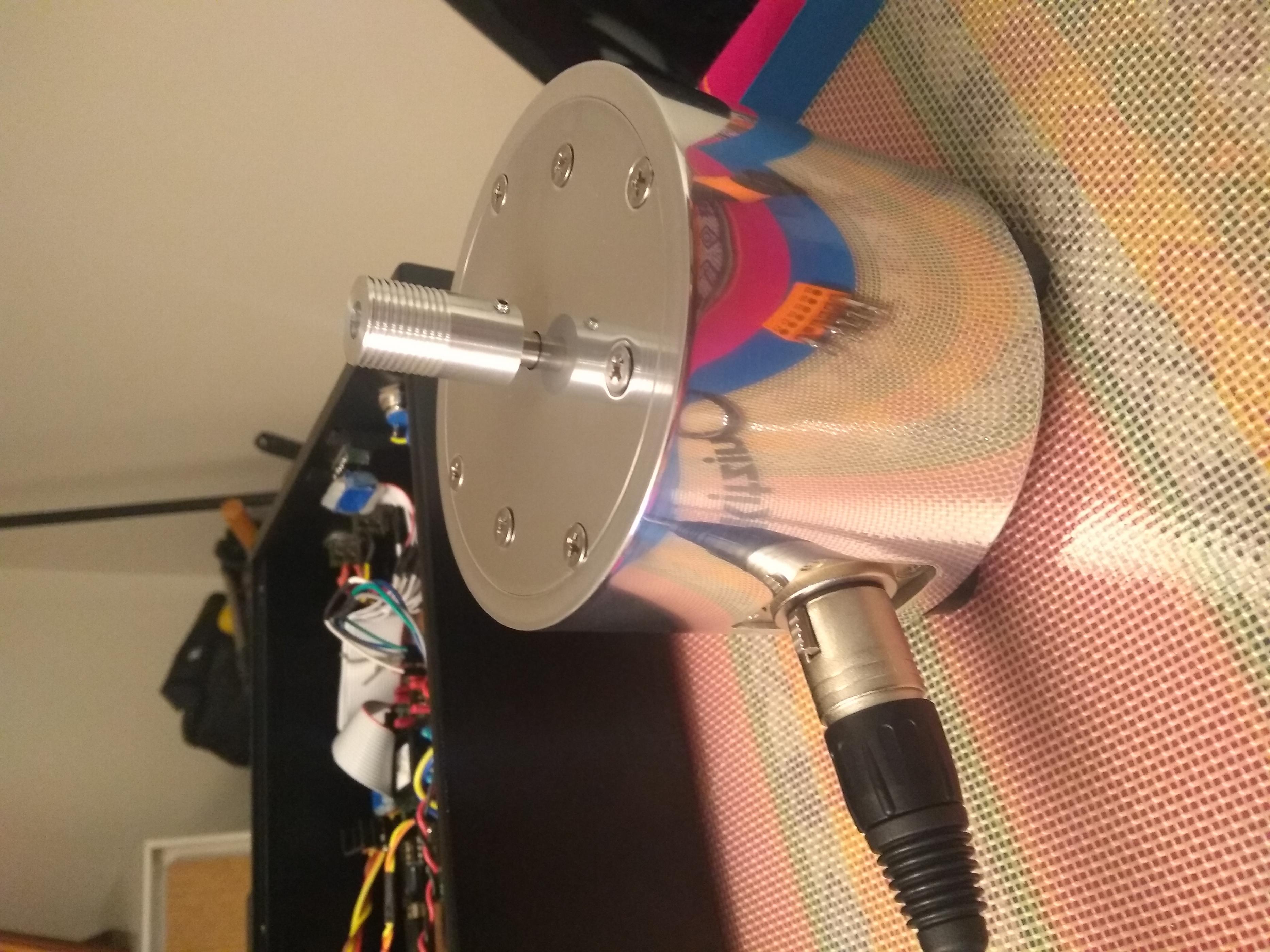

Hello Bill,
I've finally finished the MA3D and motor replacement, with a pod and pulley made of aluminium by your designs.
The alignment voltages are 4.2 VRMS on each phase, with the reduced voltages matching the original instructions.
I'm running a VPI prime, with 2 belts, and using the arduino tach, 33 RPM is achieved with 20.86Hz and 45 RPM with 28.17Hz.
I'm facing some issues, with the motor starting to vibrate and losing speed.
Could it be because of the different frequencies and lack of voltage compensation? What should be the correct voltage values?
The finished motor assembly has 1240g, almost 1000g less than the original VPI SAMA. I'll add lead shots to reduce this difference.
Thanks in advance for your help.

The frequencies are not that far from the original, it is not that sensitive. Make sure the DC voltage on all 3 outputs is the same (±100mV).
Does the motor run normally before the reduced voltage? If the reduced voltage is too low, you can try increasing it slightly, the trade off will be increased heat.
The motors can vibrate more if unmounted and held in your hand. Mass loading helps prevent the vibrations from even starting. The case should be more than adequate, but lead shot may help.
If you dis-assembled the motor to remove the hall sensors, make sure the wave washers pre-load the bearings are both in place (top and bottom).
Nice looking case/machining BTW.
Thanks.
I did not remove anything from the motor, just trimmed the wires and isolated the ones that would not be used.
I've added almost 900 g of lead, but the vibration is still present, regardless of voltage settings. The motor starts fine and the vibration slowly builds up until noticeable, with impact of rotation stability.
Without the motor connected and in 45 RPM, 128 reduced voltage setting, I'm getting stable
7.76VDC for 240, stable 7.82 VDC for 120 and a lot of fluctuation for 0, ranging from 8.9 until 10.
SG4 outputs 2.52 VDC for each phase.
Without the motor connected and in 45 RPM, 128 reduced voltage setting, I'm getting stable 7.76VDC for 240, stable 7.82 VDC for 120 and a lot of fluctuation for 0, ranging from 8.9 until 10.
The DC outputs of the TDA3123 chips should be roughly half of the DC supply voltage. The fact that zero deg output fluctuates is a potential problem. Look at the TDA3123 outputs when the SG4 is at standby; the DC should be supply voltage/2 and should have 50% duty cycle square waves (AC). It might be helpful to look at both the inputs to the chip amps and the outputs with a scope.

Readings on pins 12 and 19 from u1 are 7.66 VDC and 8.2 ranging to 10.6 VDC. Pin 19 from u2 is 7.61 VDC.
Pins 1 from both ics gives 15.05 VDC.
Did I measure the right pins?
Everything looks correct except for the 8.2-10V; I would check all the tantalum caps on both IC's for bad solder joints or correct polarity. The IC could also be bad.
When the circuit is working correctly, you should have the same DC voltage on all 3 outputs.
Checked the solders, reflowed them all, problem not solved.
All the caps are installed correctly so I decided to change the amp ic. A LOT of work after (with 2 pads damaged, but fixed with jumpers) and now I'm getting:
U1: pin 12 7.52 VDC, pin 19 7.56 VDC
U2: pin 19 7.54 VDC
TP1: 0.039VAC
Now I'll reassemble everything and test with the motor.
Everything is working as it should now. The motor is on for quite some time and no vibration or speed loss whatsoever.
For those starting to build the amp, I strongly recomend to use dip sockets for the ICs (and buy one IC extra, doing it sure paid off for me).
Thanks for everything Bill!
