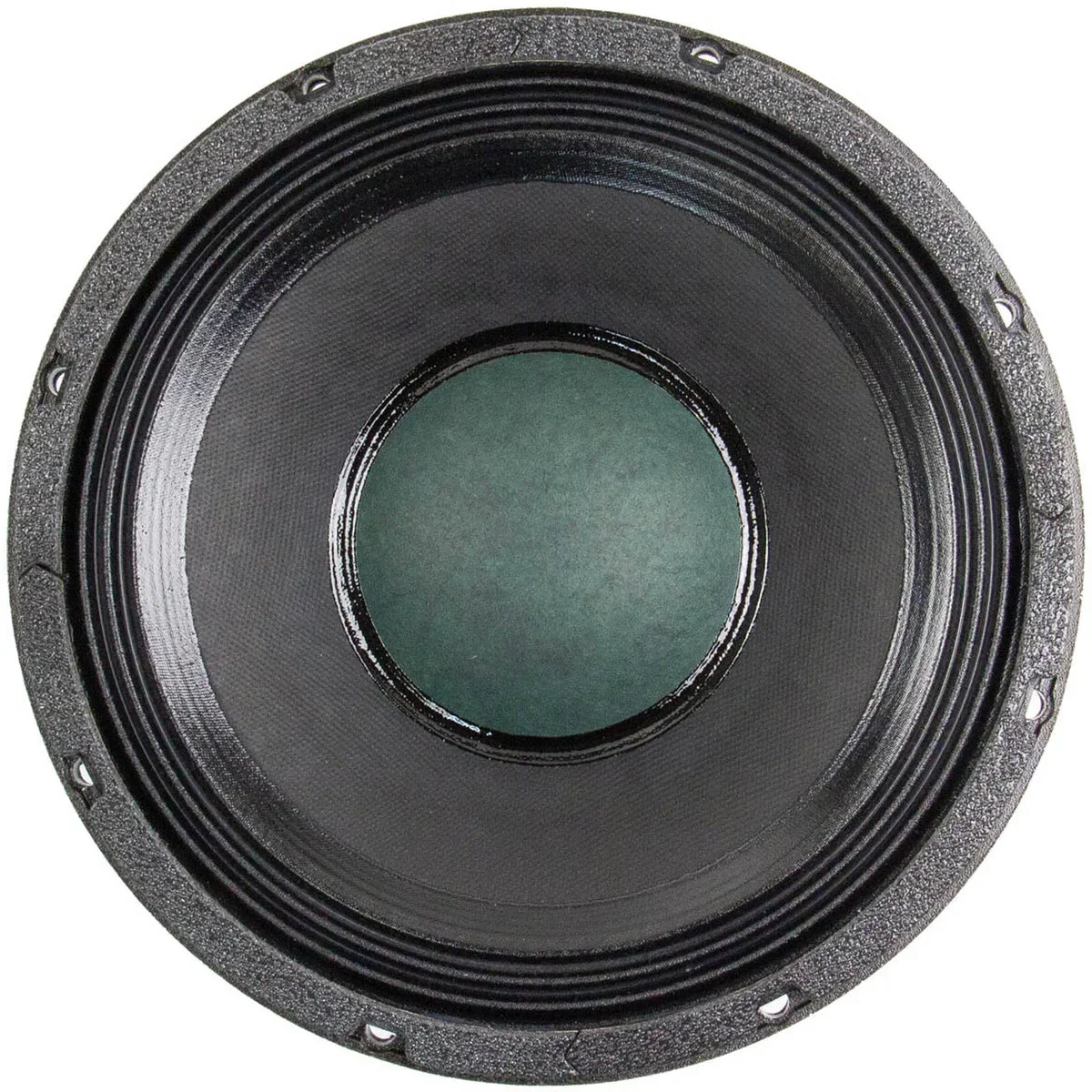

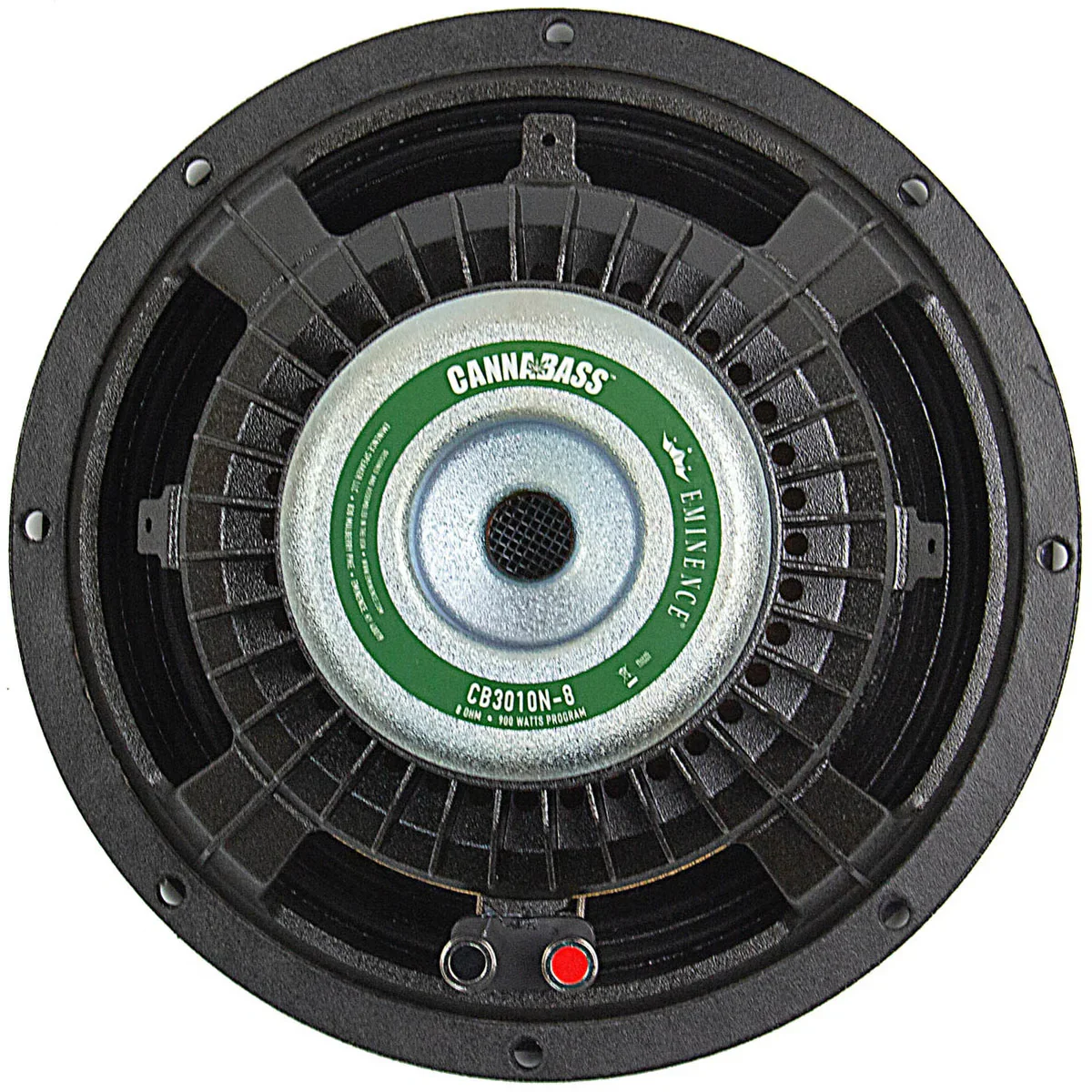

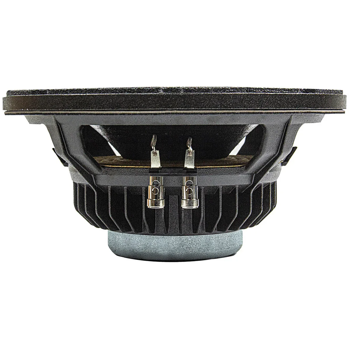

If you haven't yet found something suitable, maybe look at the 10" Eminence Cannabass CB3010-8.
I just got some myself and they're really good. I got them for the same range you specified. They have a very quiet neo motor, huge I/O wound 3" VC with fiberglass former, well dampened cone and plenty of excursion despite the 94 dB/2.83V sensitivity.

Thanks for catching that. The coax version of neo 10" is actually also very good and an almost identical driver aside from the cone and rear pole piece entrance, hence the slight drop in sensitivity from dust cap being open. Part of the reason its so good is due to the split I/O winding 3" VC, which is very rigid and has no significant internal resonance issues on these drivers, which really helps the midbass clarity.
Many midbass drivers have various resonances coming from the spider, VC former and air volume behind the dustcap. Its surprising how many of them don't do that well in the range they're designed to operate in.
Edit - I just realized the requested driver range is up to 3200 hz. I guess this eminence isn't quite going to make it up there without beaming. I still say its one of the best kept secrets for a high sensitivity 10" good enough for hifi and likely as good as many higher end JBL 10s.
