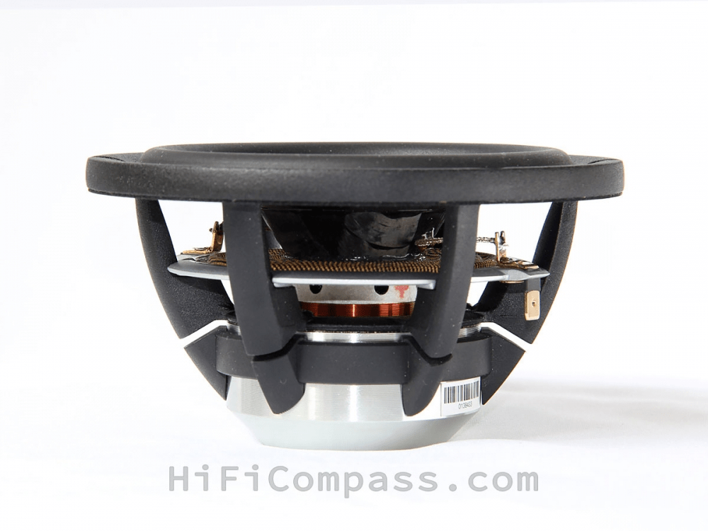

SB Satori might be the best 4-5" now, but not cheap https://hificompass.com/en/speakers/measurements/satori/satori-mw13tx-8

Too much a woofer for my taste and that dip at 1.5 kills it for me……sounds like every other boxed two way with a 2.k cross where the detail gets sucked out in the phase inversionSB Satori might be the best 4-5" now, but not cheap https://hificompass.com/en/speakers/measurements/satori/satori-mw13tx-8

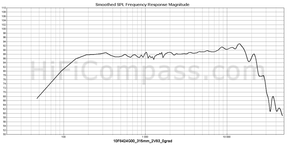

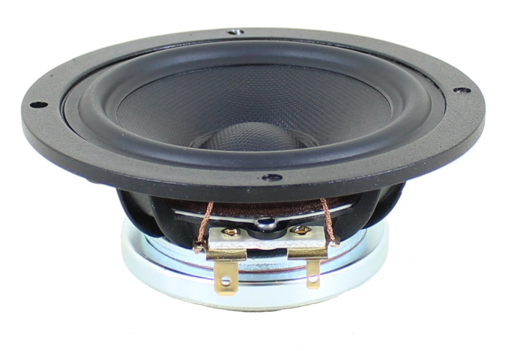

For an SPL limited solution, the 10F is likely the best sounding cone mid of its size and price point.Scan 10F 8 ohms is best VFM!

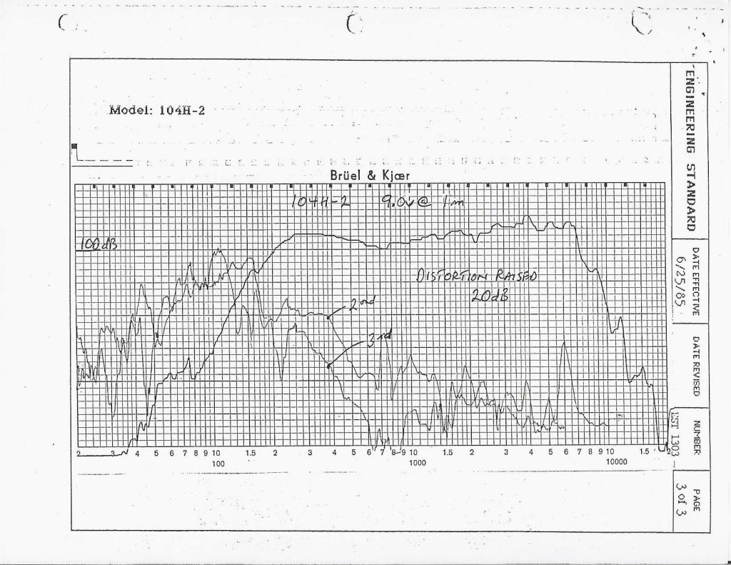

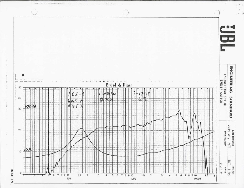

You could just go vintage JBL as well. These drivers are everywhere 104-2 -3, 2105H. Le5-9 good as well.

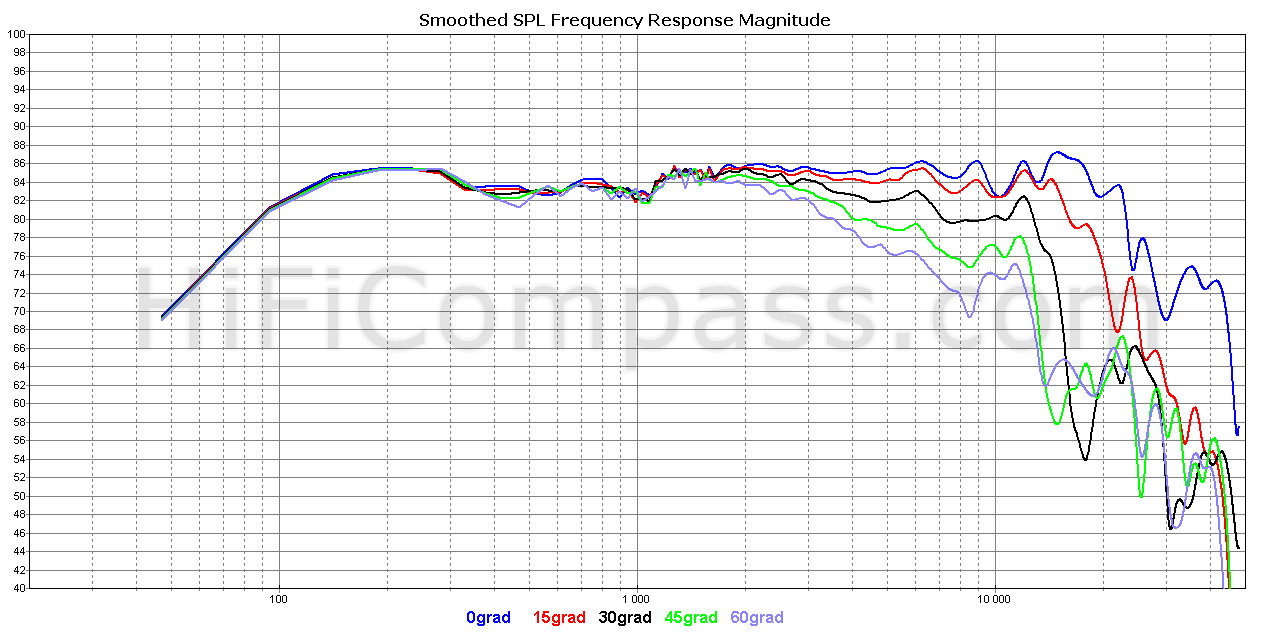

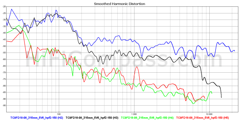

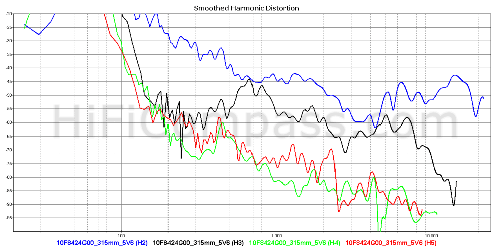

Peerless TC9FD smooooth and cheap as bread! https://hificompass.com/en/speakers/measurements/peerless/peerless-tc9fd18-08
Low HD too 5,6V
SS 10F is 5-8 times more expensive https://hificompass.com/en/speakers/measurements/scan-speak/scanspeak-10f/8424g00
Low HD too 5,6V
Certainly is a lot of driver for 17 dollars.
Strange only 30 watts with open spider
Even seems to have coil vent on the magnet too.
There are many diy projects with this Tymphany/Vifa/Peerless TC9FD during the last 30 years. Even with open baffles and tabletop fullrange. It can take quite a lot of spl as midrange. I haven't used it myself though. Very nice HD behaviour.
