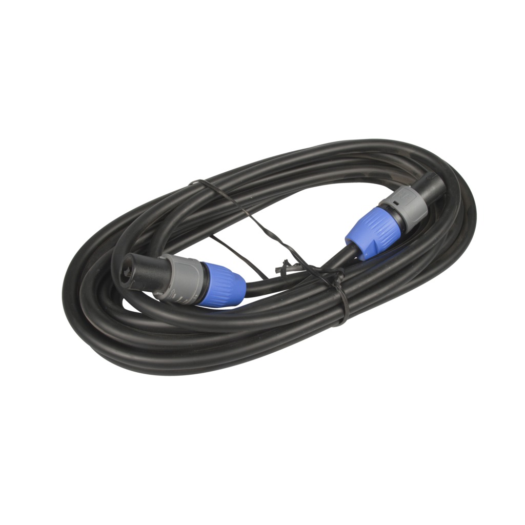

istari knight, doesn't the cable you are using very bad, or did you upgraded already?!
Use this type of cable (professional Speakon type) if nothing else. You can achieve a good improvement in total quality. It's not expensive (1x ten meter run can give you two cables), gauge/quality and it's adapted to all situations (black heavy PVC jacket or clear zip-cord jacket for audiophile applications). You don't need the bulky connectors, so, can save for later use or sell as parts.
http://www.radialeng.com/rcs/pdfs/radcat-speaker.pdf
Speakon Heavy Duty Speaker Leads : PA Speaker Cables : Maplin Electronics
