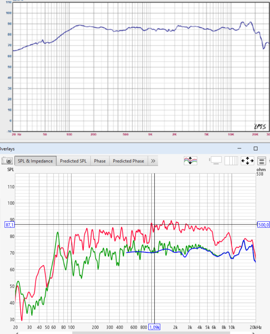

Get Alpair 5.3 and made some tests.
Red line as installed in mini stereo, from 1 m.
Green in test box, from 1 m, blue same but gated to 2 ms.
Some correlation with factory measurements is seen.
In mini stereo probably front panel formed wave guide (2 cm deep) have bad influence.

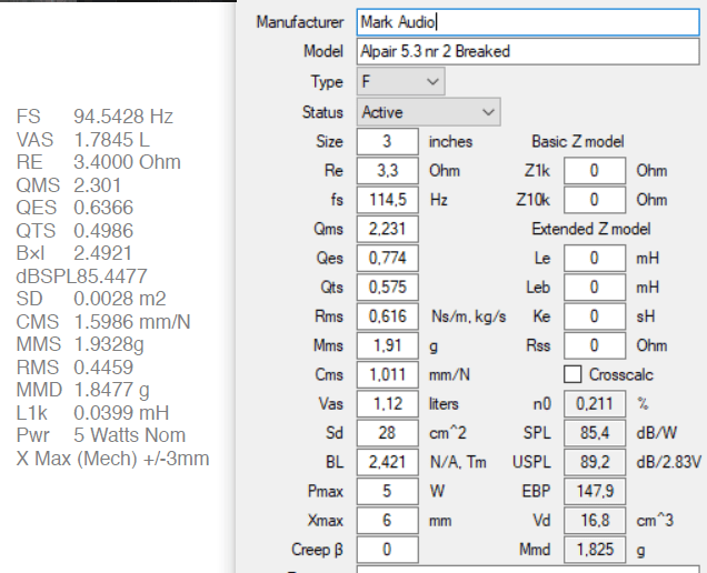

I have break in Alpair 5.3 for 3 days with 50Hz and little over Xmax amplitude.
That is not the way they need to break in, that is how you break them… but because there is no spider, the memory of that torture is likely less so it may not have been too bad.
Drivers should be broken in slowly with low level varied material, and slowly increased. Then they keep breaking in as you start actually using them.
I have found that the T/S we measure with the typical diy kit are not nearly as useful as the factory numbers.
dave
This way break in takes month or more.
I think measured T/S are close to reality, at least Fs cannot be measured wrongly, Qts and Cms also indicate that Fs must be higher than in factory data. BL is virtually same, it is one number what is not affected by parameters what will change with break in.
2 weeks in the closet.

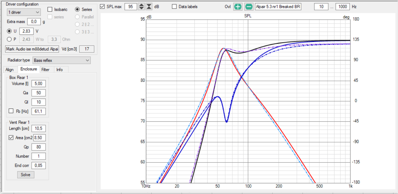

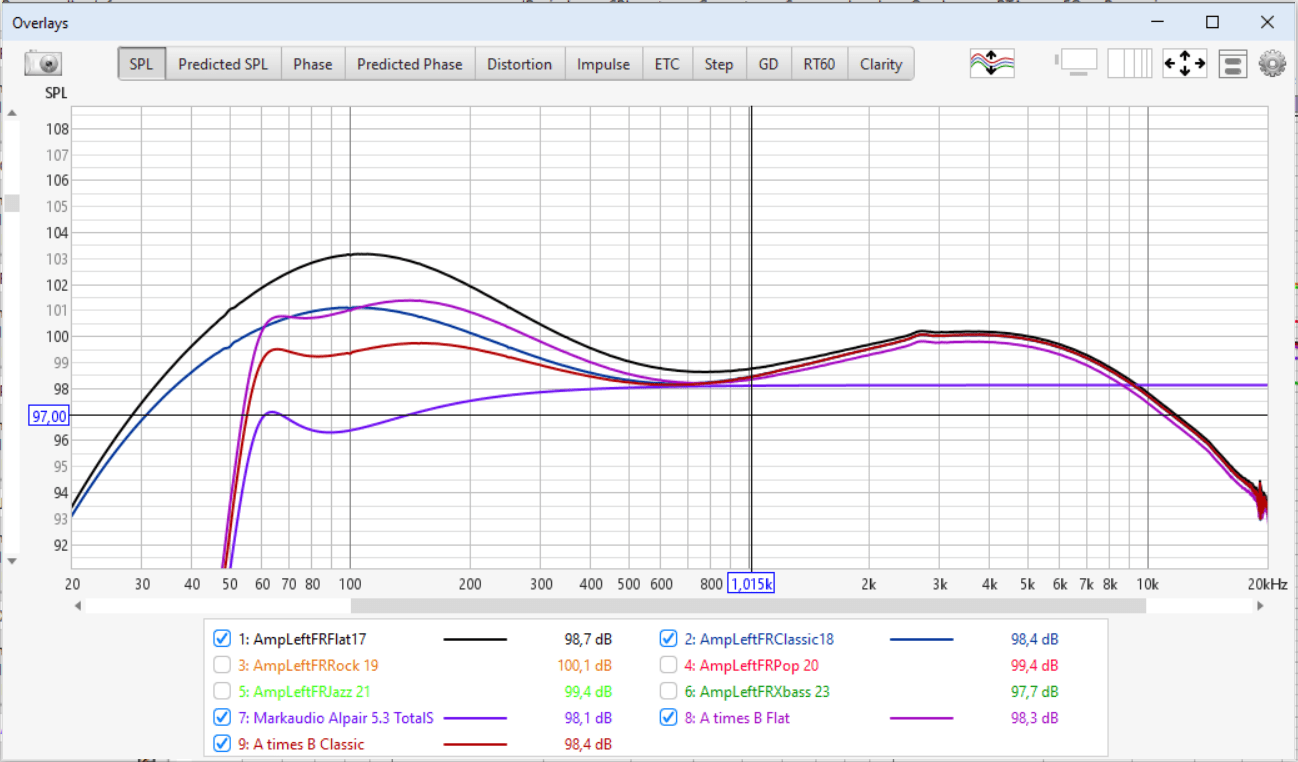

I decided to built new case for micro, 5 L volume per speaker.
On simulation dotted line with factory T/S, solid with my measured.
I presume breaking in moves speaker T/S close to factory T/S and if needed I can make adjustments with box filling.
On simulation
Thise all sims i would call ugly, an indication the box is too large or you have not tuned low enuff (ie rule 1: the 1st derivative of the FR shoulkd not opass thru zero more than once). You have 12 almost an octave apart. That will degrade bass quality. You are trying to push the driver too low.
dave

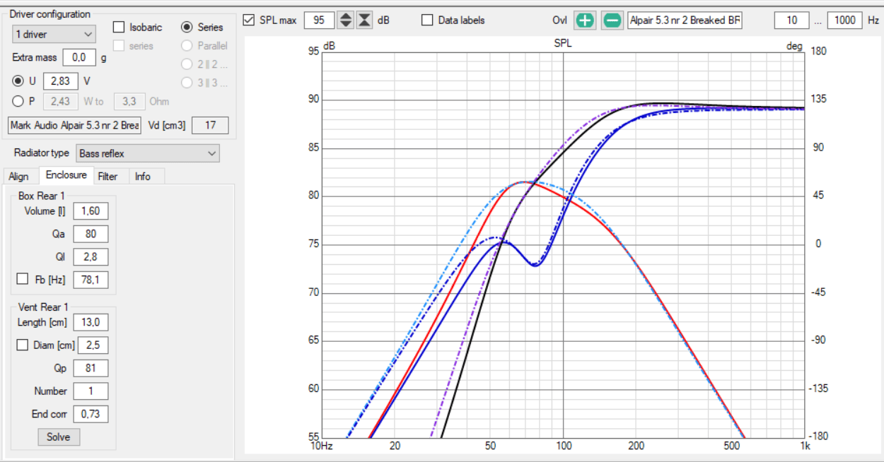

Yes, I know. This is intentional, first I will test simulated box and then adjust if I am not happy.
I have also additional problem that micro stereo FR is cut off below at about 80 Hz.
