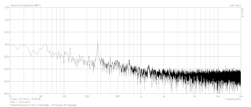

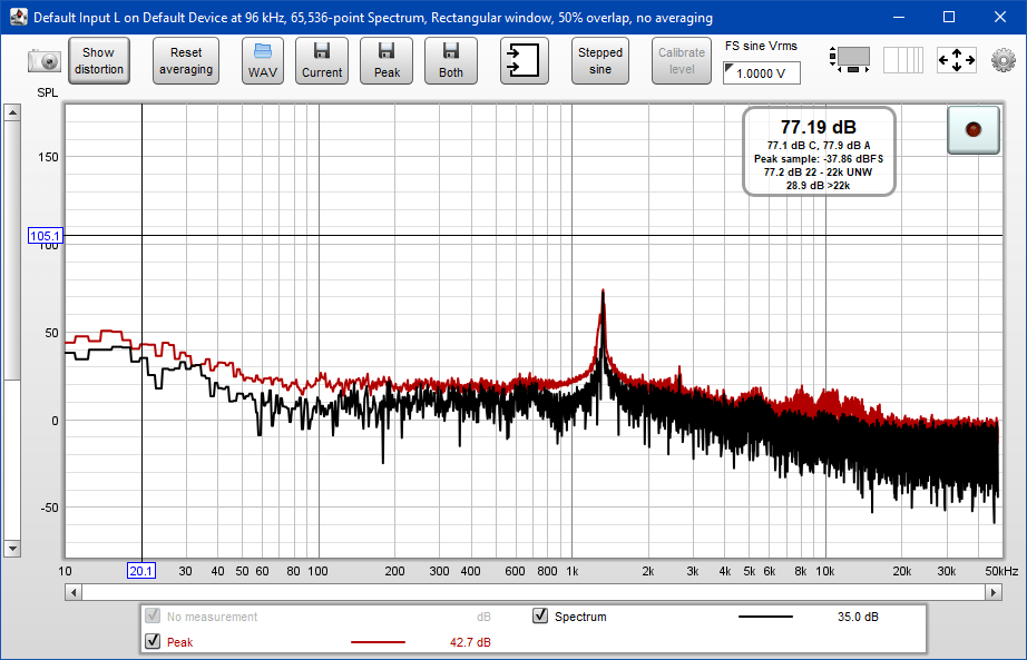

Yes, that near field response appears to show box resonances. If there was no damping material in the box it would be interesting to stuff the box with damping material, fiberglass batting, rockwool, tightly packed dacron or maybe acoustic foam and repeat that near field measurement to see what resonances get reduced. Bracing the box walls or applying some butyl rubber backed foil damping material may also help with panel resonances. It can be informative to measure the box output with no drive signal in Power Spectral Density display mode while rapping on the side of the box walls to see what the resonant frequencies are of the panels. The Arta software has a real time spectrum mode that computes the FFT and displays it.
Here's an example of a panel resonance I measured by knocking on a wood panel.
Me too. Like Arta, REW has a PSD function. It's the Button third from the right labeled RTA, Real Time Analyzer.
Here I pushed the record button, top left corner of graph with red dot, then whistling into the mic. Click [Reset averaging] just
before you knock on a panel and then hit stop to measure panel resonances.

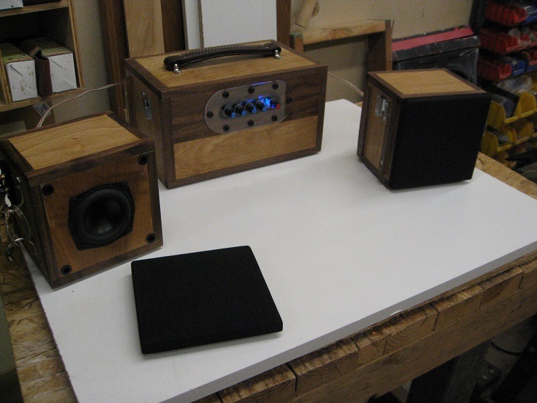

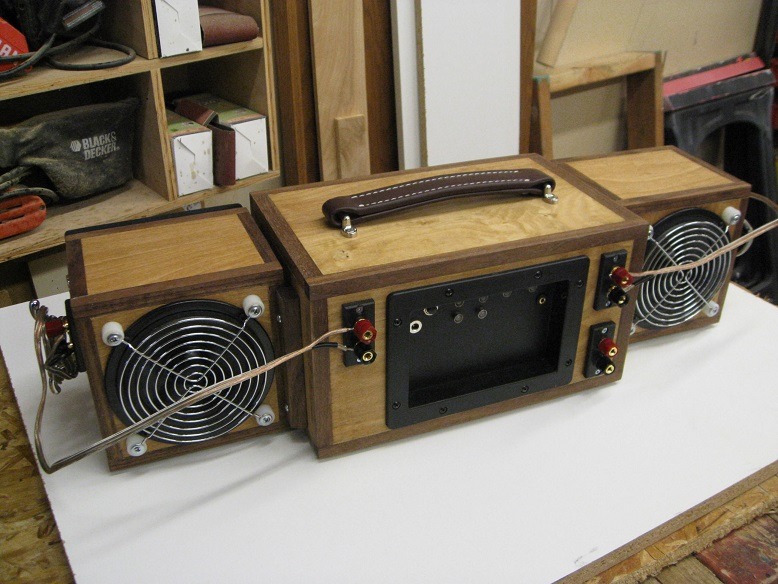

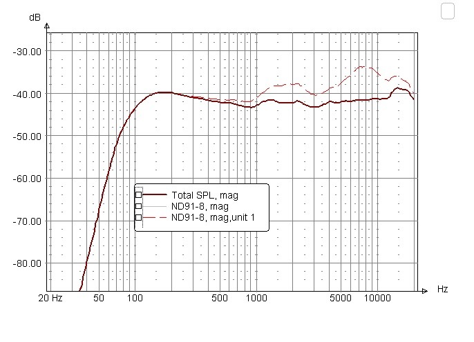

If you aren't able to resurrect or re-use the current drivers another option is the 3.5" Dayton ND91-8. I used them in a portable boombox.
Each speaker box is 1.6 liters, with a 5" PR (Dayton DS135-PR) on rear.
Fs on these 2 units measured 95 Hz (Dayton says 70 Hz). The PR is tuned to 80 Hz, which can be accomplished with a 1" x 5" port, if there is room for it.
Also, there were 2 spl peaks at 1800 Hz and 7500 Hz, which were flattened with notch filters. A Zobel was also used to aid in notch design.
The center unit houses a 2.1 amp board, with rechargeable batteries.
Maybe a little overkill, but the resulting sound was quite good.
The depth of the cabinets could have been increased. I wanted to explore Passive Radiator design.
Also, the 2.1 amp module was BlueTooth enabled, as well as Aux input. Really a fun design.

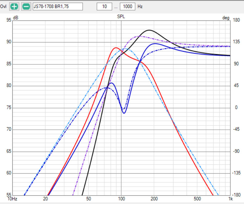

Simulation of original speaker in original box and port is next, dotted line again Alpair 5.3
Hump on 170 Hz is in good correlation with real SPL measuremnts.

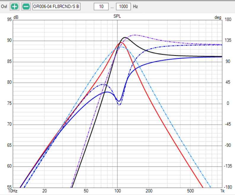

I think because bass response and fit with current box is left only Alpair 5.3 and CHN-50.
Which of them have better mids and highs or generally better?
The $15 CHN-50 can be considered the cheap version of the $50 A5.2/3. CHN does have a spider.
