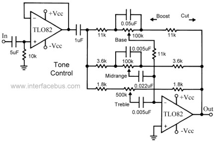

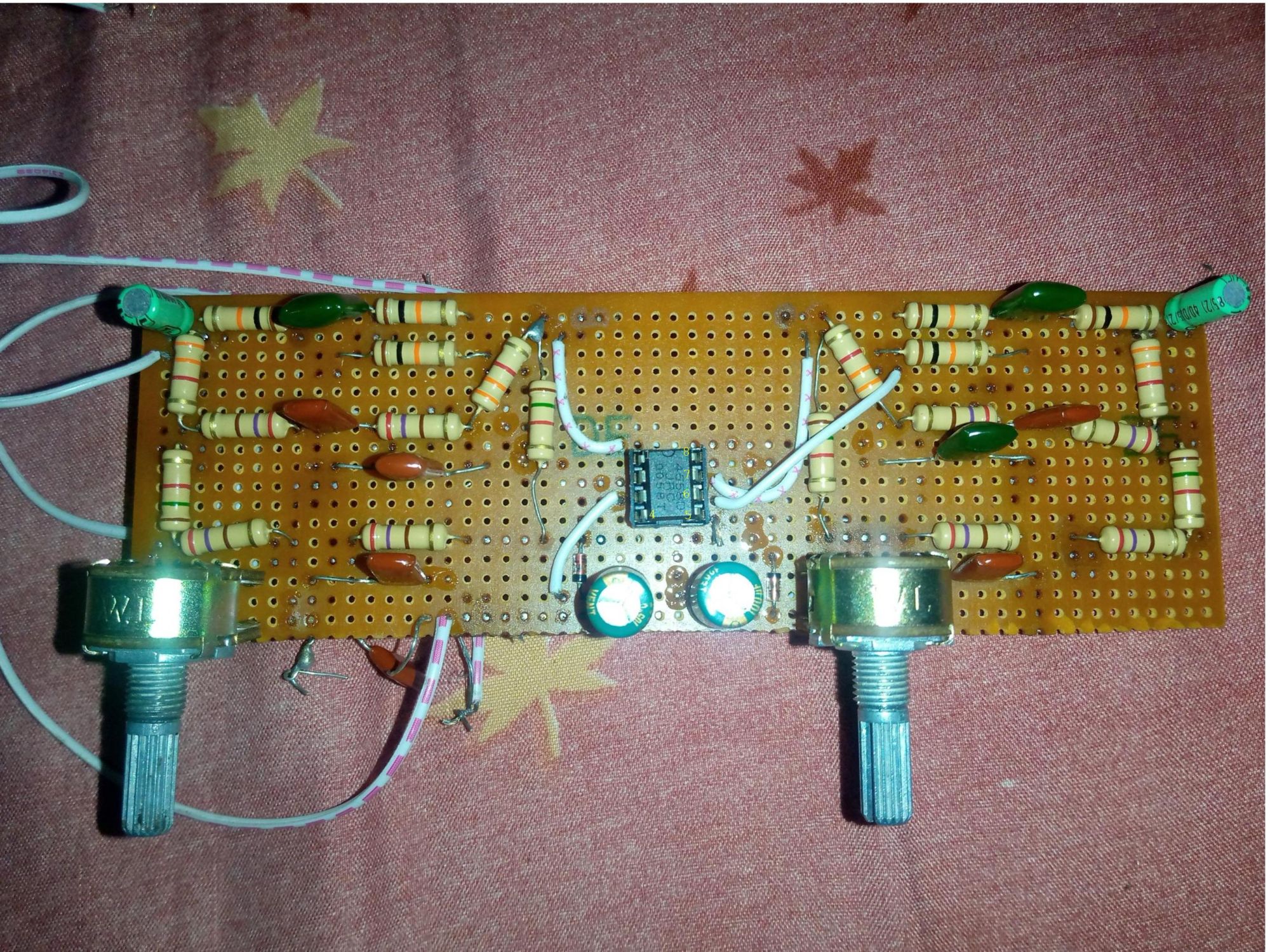

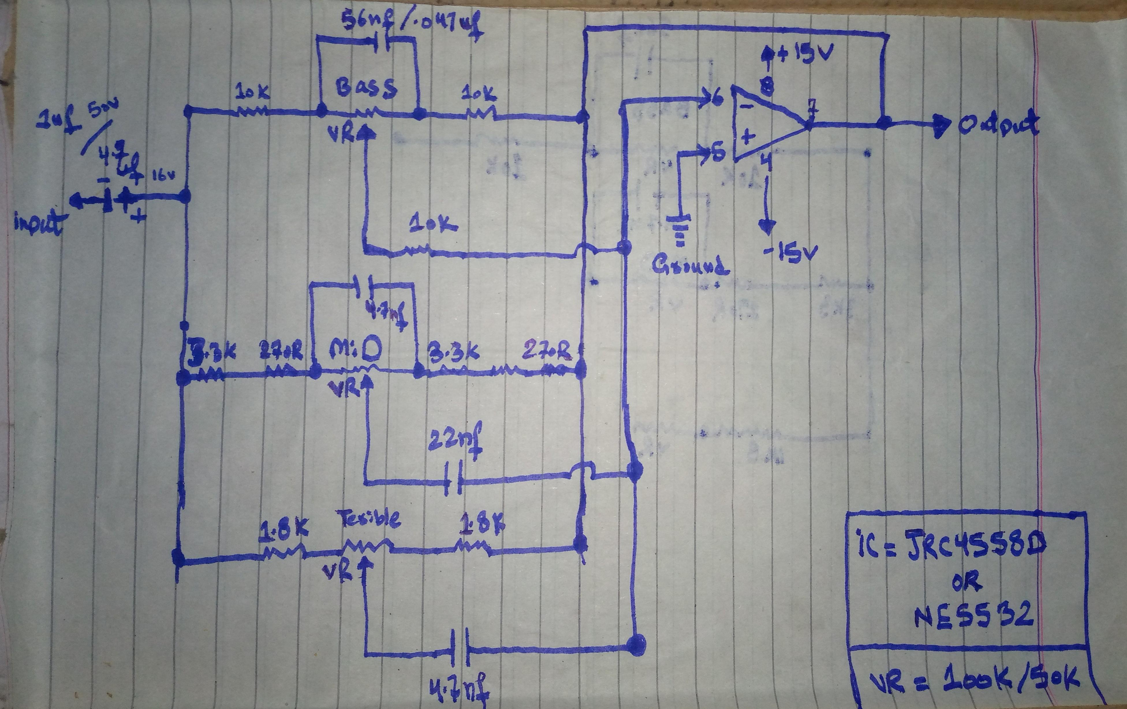

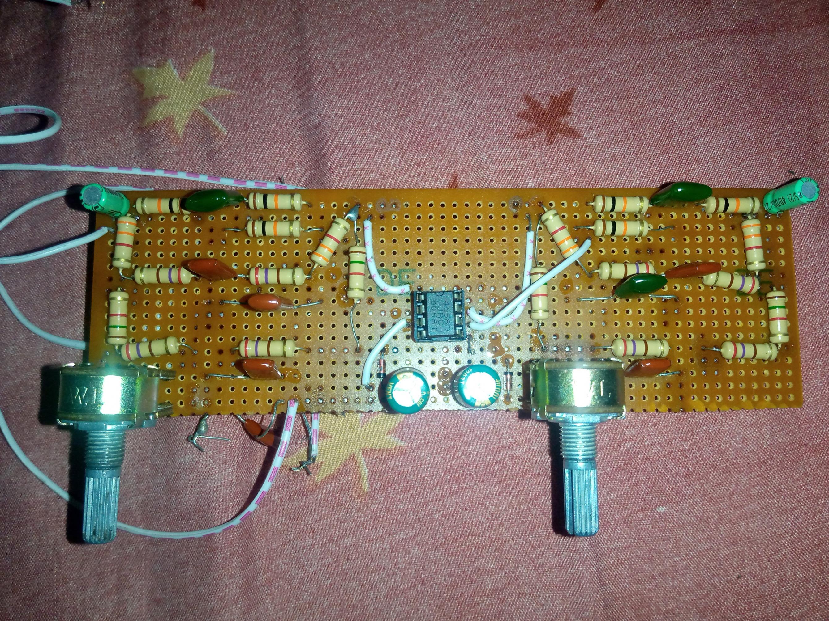

I recently built this circuit
but It Is not working Not getting any sound after building this circuit. Idont know where i have made a mistake.
Thanks In advance

First:
Connect the black meter lead to ground.
Connect the red meter lead to the negative (-) input op amp pin #6.
What does the meter read?
Second:
Connect the red meter lead to the output op amp pin #7.
