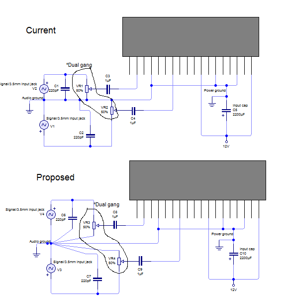

Its all 12v battery powered so no mains earthing here. So its best to have two separate star points, one at the input jack and one for the power section and then just jumper them over with a single link? The signal and power sections do have their own separate zones but I guess there are some very small runs where both input channels share the same return back to the input jack.
Maybe about 2cm in total between the input jack and potentiometer, ie both gangs of the dual pot share a single small (less than 1cm) return conductor back to the input jack.
Then after that its just a single jumper between the input grounds and power ground, but my understanding is that no audio input signal current should travel down this link.
Should I separately star the input grounds or is it just not really worth the modifications at sub centimeter lengths? I drew a schematic to explain it better, excuse the lowish resolution but I did it on a laptop. Second pic is from the datasheet.
With no connection to earth and no mains transformer, the common-mode noise issues won't be mains-related which is a relief 😀 But there will still be potential CM noise issues related to the cables (input, speaker) acting as antennas. This puts the frequency of interest of the CM noise into a much higher band (where the cables are effective antennas) than with a mains connected system, meaning in theory its easier to filter it. However I have no experience of designing with battery powered amps myself so no practical tips to offer.
I'd say suck it and see.
Not worth the bother in a battery powered system.
