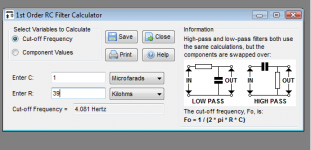

Thanks, as well as the RC low pass filter I'll add the smaller capacitor across input jack too. I think I'll just remove the series ferrite beads since they were pulled out of some old junk and I have no idea of their true characteristics.
Does Hot and Cold refer to one of the incoming audio channels and ground at the jack? (see attached paint drawing).

Well after much searching and clicking on dodgy Chinese websites I managed to come across some actual commercial schematics featuring the LM4705 chip amp.
However in the first screencap the input filtering sections appear to be in the wrong order and the DC blocking capacitor is between the resistor and small capacitor.
Then I came across a different one in the second image that had another weird arrangement.
Just what is going on in these designs? It goes against everything I've been reading about input filters and its very confusing to say the least.

Well the first one is from a genuine Yamaha schematic of a DJ mixer type thing very similar to the item I pulled the IC from so it must have some method behind it, the second one was traced out of some PCB pictures of a car amp I found containing the chip.
Who knows, maybe the chip generates noise by itself and the revere filters are to keep it away from the op amps further down.
Edit: found another schematic of this chip, might as well upload it here just in case some other poor soul comes along looking for references of this mostly forgotten chip amp.
They just did cost cutting. The 2 resistors at the input are an attenuator (like a potentiometer that can't be adjusted), the filter cap so has a series series to form an RC filter. It really is not that different.
In the last schematic in post #36 this is a variable slope filter which is a plain design error as explained. Maybe the chip is prone to oscillation or RF pickup and is this why they added 470 pF to the input pins but it seems unlikely.
You have enough information to make it work OK. If it turns out to have problems you can add the 2 x 470 pF.

I'm confused (again), wouldn't a filter need to have one end of the component nearest the input pin connected to ground to have any effect? At the moment it either looks backwards or is acting like a fixed volume control and blocking capacitor with no real filtering apart from the small RF shunt capacitor on the input.
