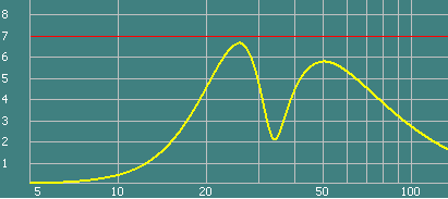

Hello everyone,
I'm looking to build a portable speaker. When I model Tang Band W3-2088SOF 3.5" Subwoofer through WinIsd Pro in 4.2l (.15 cu.ft) box tuned to 34Hz I get 30Hz -F3 point and roughly flat response with 89db SPL. Can this be true or manufacturer is cheating on specs and this modeling is completely false???
Please I need answers soon, only one subwoofer left in shop :/
Thank you very much !

Hi, sure the frequency response looks good, BUT, that's Not the whole story !
1 - I presume you didn't include a High Pass Filter ? Unless you do, Xmax will be exceeded for more than 5 Watts. I included a LR 24db HPF @ 24Hz which safely limits Xmax to just under it's limits for 25 W.
2 - If you look at the size of the port/s needed to acheive that response at that fb, you'll see it/they are Massive ! For eg, a 25 mm round port needs a length of 284 mm ! A wider port even longer. You wouldn't fit that port into that box, unless you folded it. Then you need to always add the volume of the port to the box size, plus the volume the driver etc takes up, to end up with the Net internal volume in WinISD etc. Could be done though.
I got the TB W3-2088S0F PDF from Parts Express, & it states that Vas = 2.1 Ltr. You have it as 1.98 ? Also fs = 45Hz yours = 43Hz ? Sd = 45.2 yours = 42.9 ?
I simmed with the PE specs, but yours won't be far off. My sim also - Net vol = 4.2 Ltrs. Fb = 34Hz
It is a Very good driver for such a size 🙂

Thanks, the specs I have are a little bit fixed, because fs is actually 43Hz instead of 45Hz when looking at impedance graph in PE page. I actually couldn't manage to get the same graph with PR but maybe I could use a peerless 3.5" passive radiator instead of a port. And also, where could I get 24db HPF for a reasonable price?
The peerless passive radiator likely won't be able to handle the excursion of that driver. PR is a better option for tuning such a small box so low, but the Peerless wont do it. Unfortunately I know of no PR that would, you need something custom.
If you can go with a larger PR that would reduce the problem some, a few exist that are in the 5" to 6" range that might work. You might also check for Chinese suppliers on Ebay. I've bought a few and they work well. The biggest problem is that you either guess at specs or attempt to measure yourself, which is not so easy to do. I've not used this driver with a PR, but I did use a small vifa 3" driver with a square PR I bought from a Chinese supplier, I found I could measure the tuning with my WT3 just fine and adjust as needed by gluing weights to the center. For such a small driver it worked fine.
This driver has quite a bit of excursion for its size which is why I worry that Peerless PR, which I have a few of, wont work out. Two of them would require far too much mass.

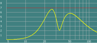

It actually goes to 47Hz -F3 when modeling with port (screenshot added) but somehow I can't get it that deep with flat response using Peerless 3.5" PR (maybe I should give a try to chinese 7x8 cm rectangle PR's?).
I also upload woofer cone excursion graph.
P.S. I meant the tweeter is flat from 2000Hz upwards 🙂 sorry for my silly explanations.

https://postimage.org/index.php?lang=englishPortable as in 'differnt locations' or as in 'outside'? Either way, you won't be hearing much of the 30Hz since it's very dependent of the listening room and outside you won't be hearing anything of 30Hz at all! 30Hz is only included in very, VERY rare tracks anyway. I wouldn't go for it, especally with a such small speaker. I'd suggest to go for a slightly higher tuning and take instead of 30Hz a lot higher spl with a tuning at ~40-50Hz. Besides that, the lowcut/subsonic filter already suggested by Zero D helps a LOT.Hello everyone,
I'm looking to build a portable speaker. When I model Tang Band W3-2088SOF 3.5" Subwoofer [...]
Going a factor n deeper costs you a factor n^3 = 8 in sensitivity, for a given enclosure size. So if you increase the f3 from 30 to 90 Hz, your sensitivity can be 3^3 = 27 times as high (+14 dB).
