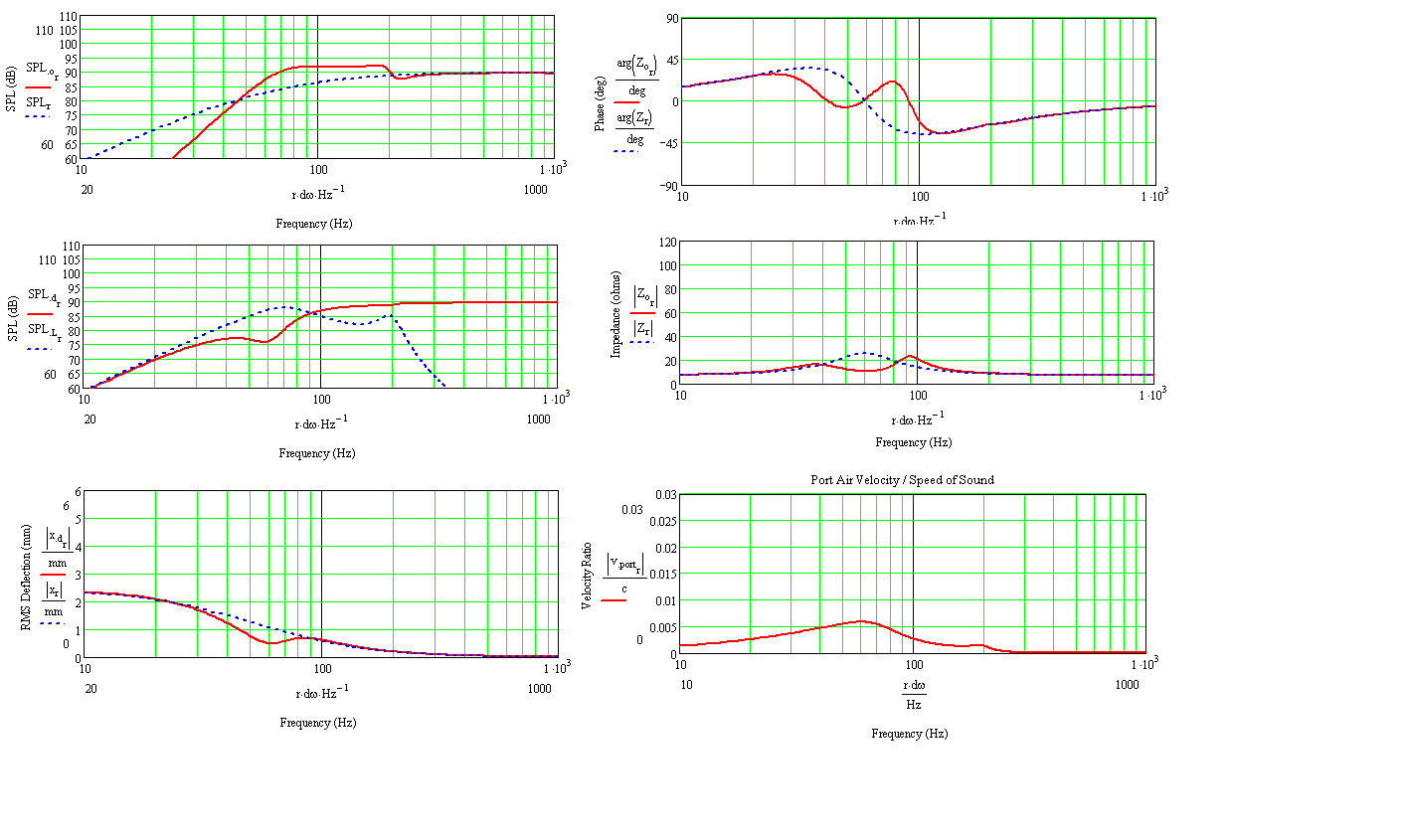

Ha! Talk about irony. Because I was literally just checking to see how well one of the TB units under discussion would work in the twin A7 DBR box. Rather well is the answer. Quasi anechoic attached for that cabinet with the TB, pretty much preserves the pro-audio alignment I built into the response for the twin A7s. The MA drivers would still be my option though; they're technically superior units with excellent dispersion & pretty much self-correct for step loss in practice, but they are more expensive, so depends how much you want to be spending.

My pleasure! Turns out i had jury duty today (and yesterday) so working in office until around midnight to make up the work (self employed). Got out of jury duty tho! This is a nice distraction before i start work tonight.
I modeled a single TB in a .75 box and it's a 2 x 2" port tuned to 55hz. You get to 50hz this way. Personally, i like your idea of sitting them on top of two subwoofers doubling as stands. You can be creative with the cabinet shapes and get something clean looking. I prefer the smaller .5 cf cabs frequency curve. The smaller cab will give you slightly better power handling bc not taxing the driver as much in the low frequencies and you get low enough to integrate the subs without any trouble at all. I don't think you need to play with two drivers per cabinet and believe it will muck up the lovely full range driver sound you will achieve with just one driver. You should have a kick *** system with five of these plus two subs without worry it won't play loudly enough. It may not bother the neighbors or shake the rafters but it should go loud... and they should play music really nicely too!
I simmed a BIB too but since you decided on the subs you probably don't want two lovely towers 60" x 9" x 12" in your room... and you need corners to make them rock so maybe not optimal. Maybe someone else will build BIBs with these TBs?
These work out almost perfect dimensionally, fitting within the footprint of my TH subs, so I can use them as stands. This puts the top driver @ a height of roughly 41" taking footers into account, right at ear level. Even though the graph is in 5db steps, it looks to be -3 @ 68-70hz.......great for integrating with the subs. It's decided, this will be the choice for mains, loaded with 1611 drivers. Thank you much Scott.
You're welcome. As you're running twin subs, I think they should be a reasonable compromise given your particular situation.
Just to be clear, you can only use one of the Tang Bands per enclosure if you want to preserve this alignment -it's higher Vas precludes employing twin drivers per channel, as was used with the two Alpair 7s the cabinet was originally designed for. I would strongly advise retaining the removable back; it makes access to the interior to tailor the damping much easier (I should probably say 'possible' in the case of the lower chamber) -just make sure the seals are airtight & you should be fine.
As ever, YMMV. We can't promise giant-killing HT performance, but you'll have something better than you've got in your TV set. 😉
