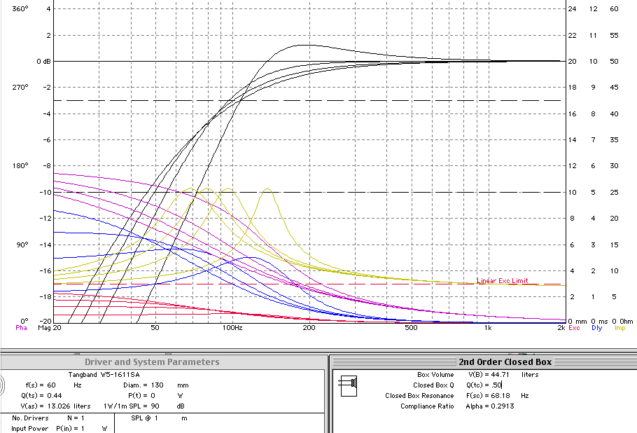

Here are sealed sims of the 5" TB. Q=1.0, 0.7.0.58. 0.5. Volume about 3.5, 8.5, 18, 45 litres.
Sealed it will struggle to meet the woofers.

In real life it's going to be even worse than those models show. Assuming the drivers are up near ear height (between 2 and 4 feet high) there's also going to be a floor bounce dip between 100 and 200 hz. It's probably likely that the speakers will also be located within 2 - 4 feet from other boundaries (walls) as well which will just accentuate the floor bounce dip, creating an even bigger hole between 100 and 200 hz. On top of all that, if the ceiling is 7 or 8 feet high, the floor/ceiling interaction will create another null, this one will be slightly below 100 hz but will subtract even more from the already mediocre midbass performance. The tapped horn subs will have trouble doing any higher than 80 hz (IIRC), so all this amounts to a potential for a massive hole in the midbass right where you don't want one, the spot where the sealed box's response is already very weak.
FWIW I'd go with larger drivers or at least a ported box. I'm pretty sure even Ed Shilling would agree that this is too much to ask of small drivers in a closed box.
I forgot to mention baffle step. I don't see any diffraction in the models so I assume there's no step losses shown either. That's going to take another 6db bite out of the bottom end. That alone ensures that passive filters are going to be required (bsc) which will further stress the drivers at lower frequencies.

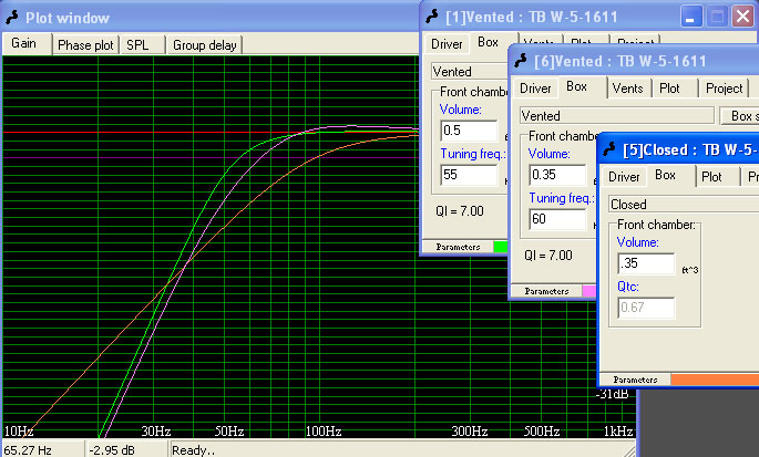

A .5 cubic foot box using the TB 1611 and a 2" x 4" long port will give you -3 at around 55Hz.
A .35 cubic foot box with a 2" x 5" long port will give you a -3 around 65Hz.
That's what i get in WinISD. My sealed measurements match Planet 10 pretty closely and may not be such a great idea for the mains but for surrounds i think they would be fine.

Exactly what I was looking for, thanks. Might you be so kind as to give me one more sim tuned slightly lower @ about .75 cu.ft.
