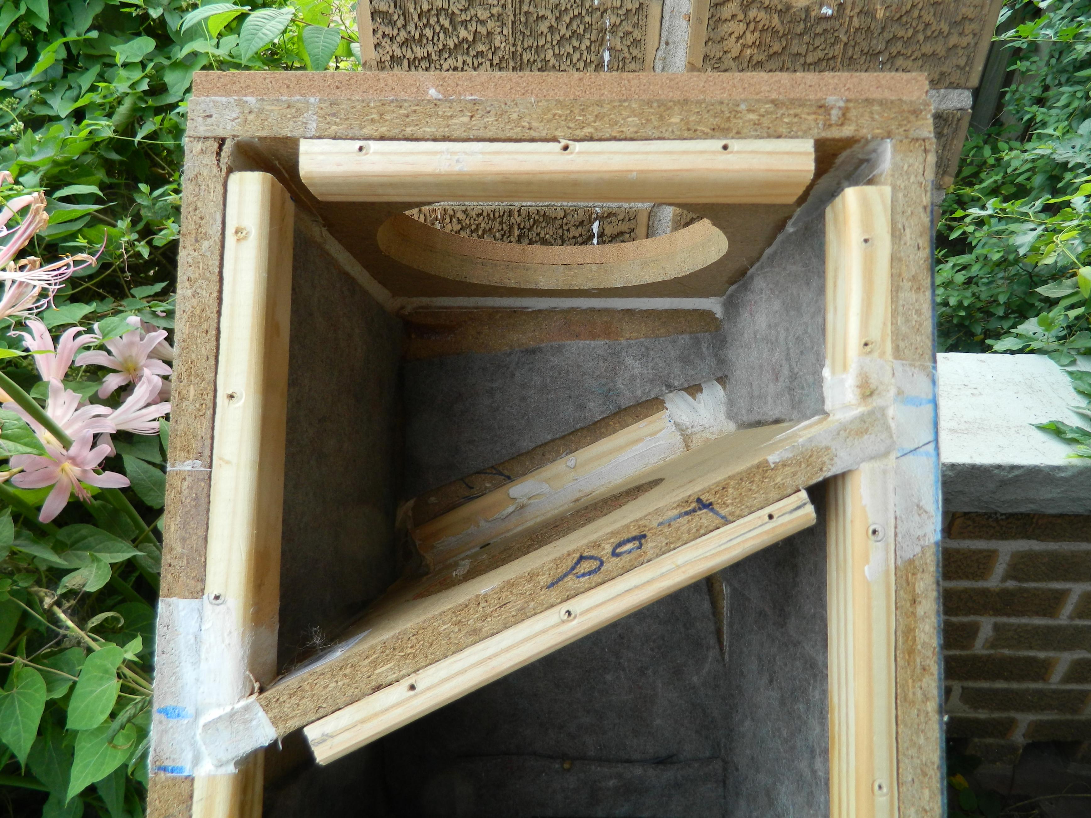

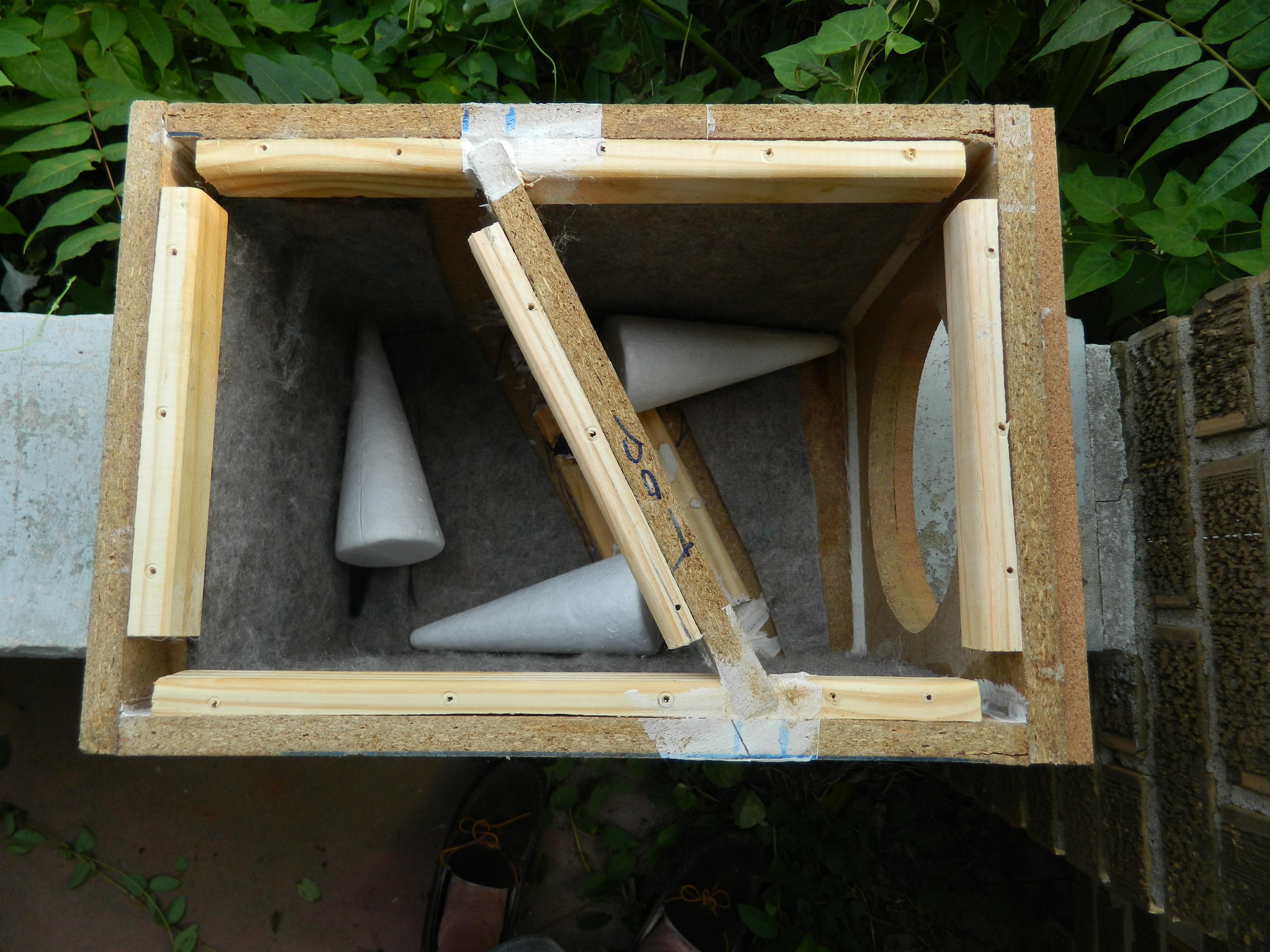

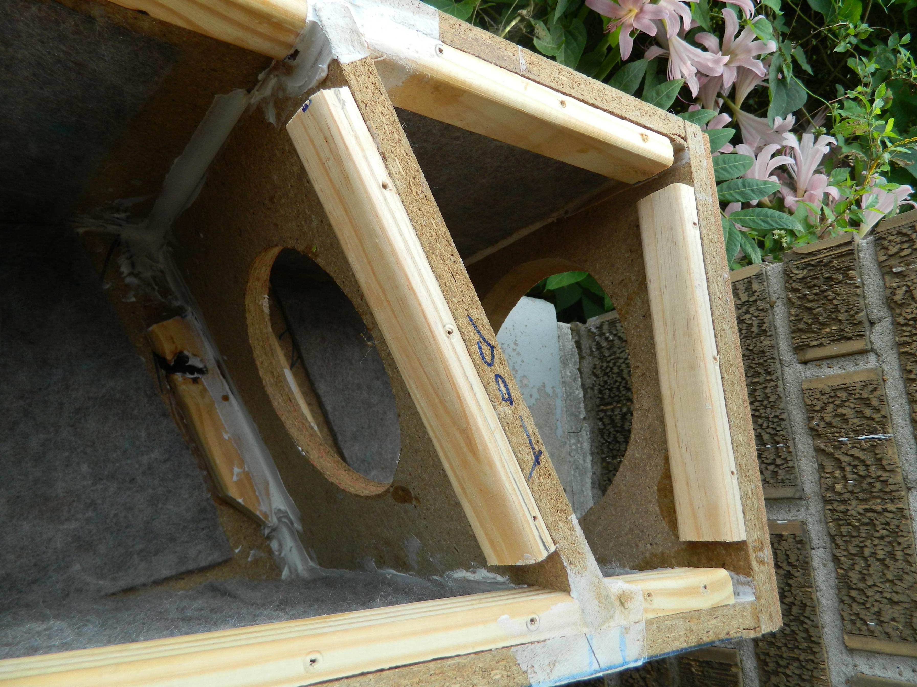

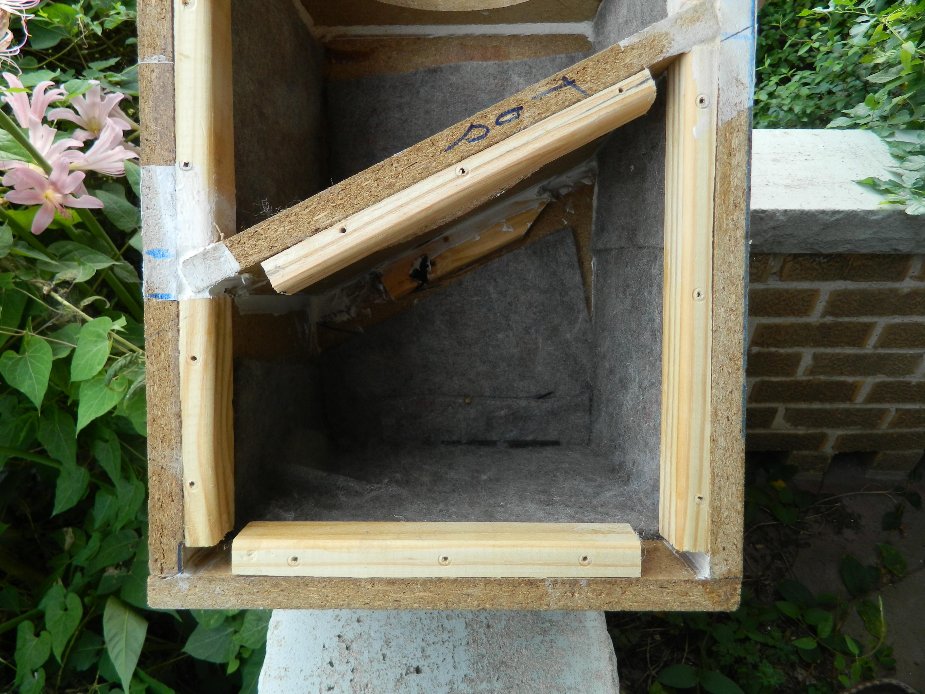

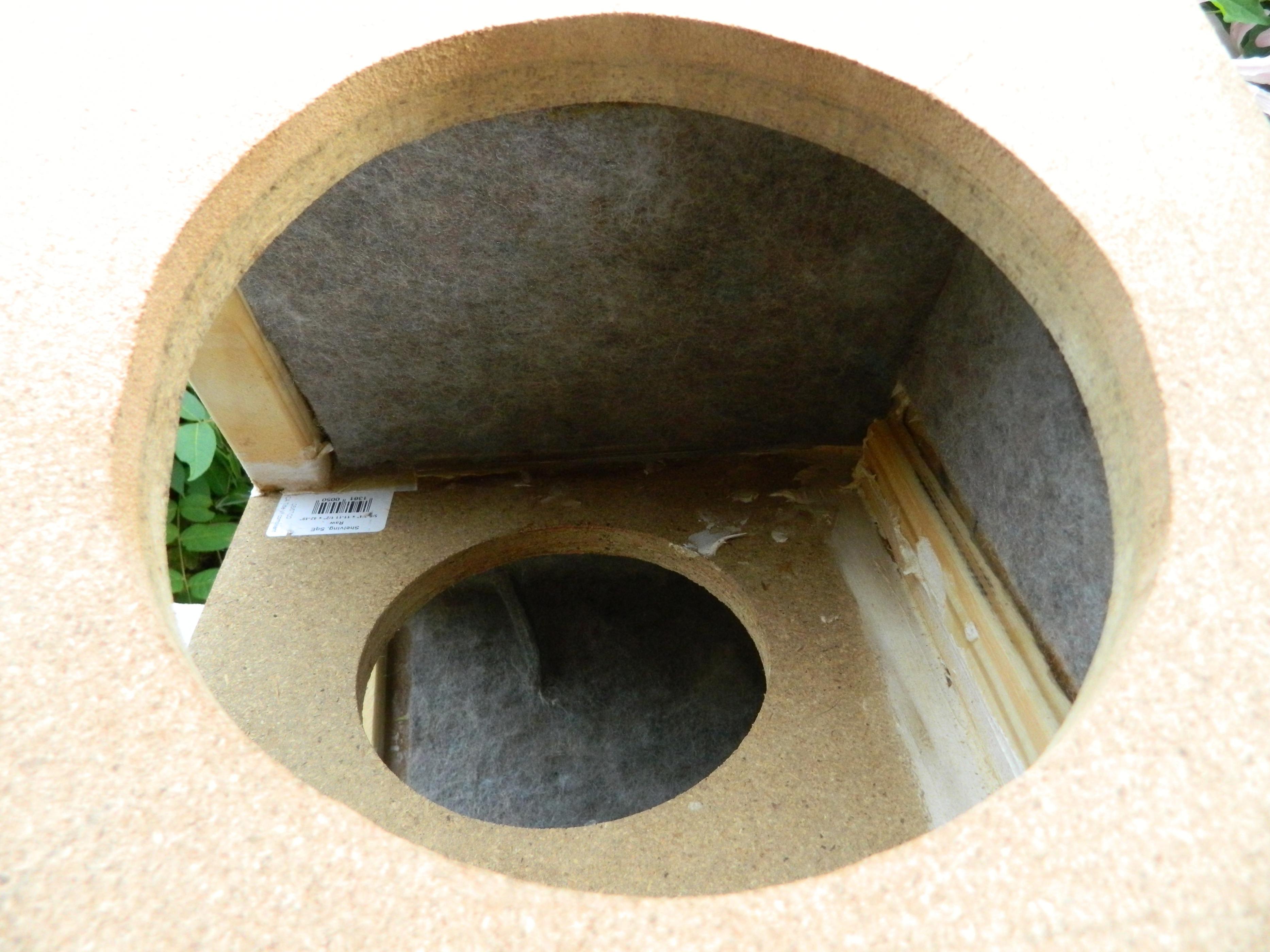

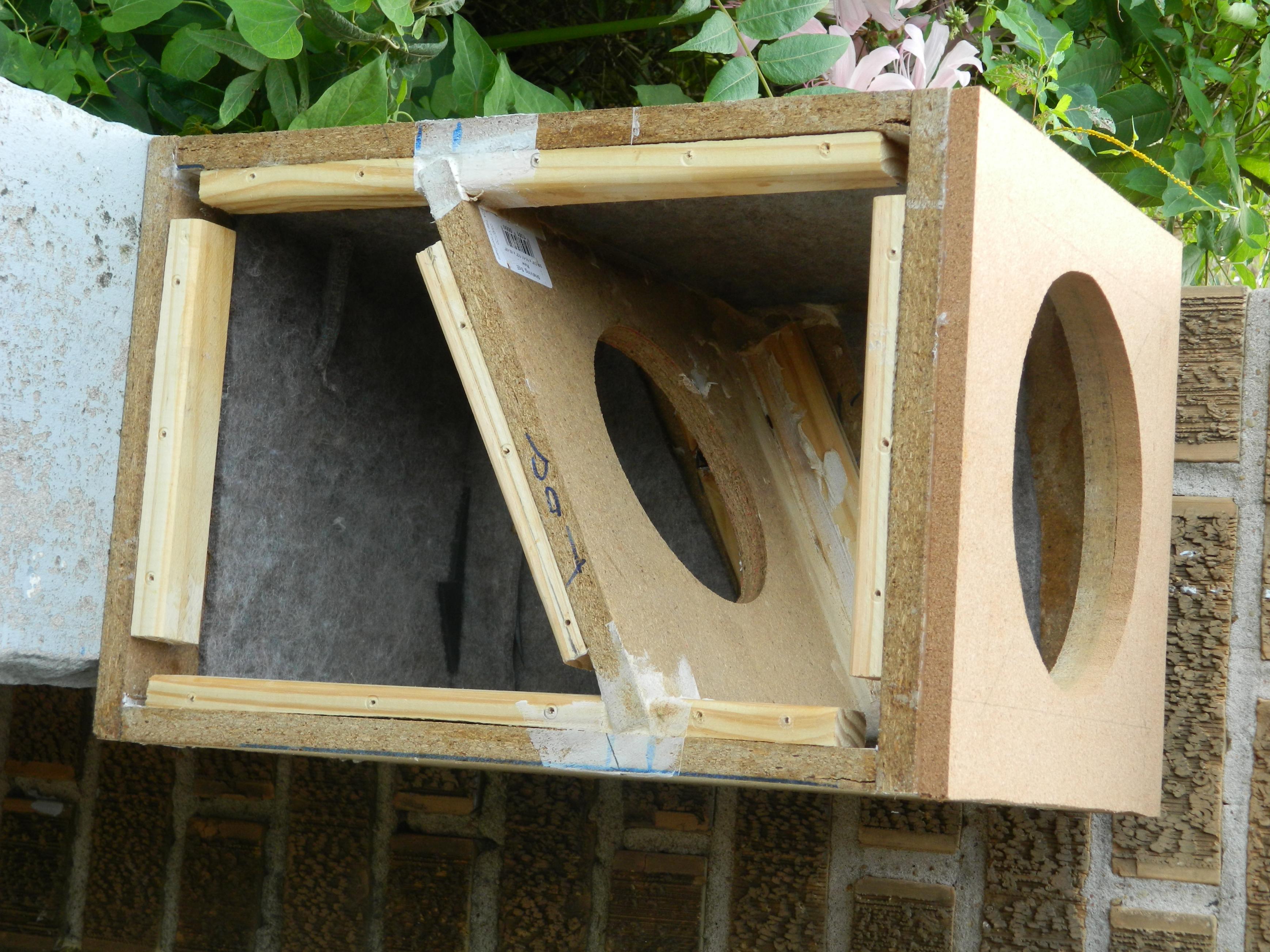

The new Wavecor WF223BD01 should be here today or tomorrow. I built a test box. I will attempt to post a few photos. It's a closed box; regular rectangular shape but I put in one internal brace at an angle to help break up standing waves as well as give extra stiffness. I also ordered Styrofoam cones and spheres I can use to further reduce standing waves (if need be). The idea is to "disrupt" parallel wall surfaces with irregular shapes. I can cut these easily and try temporary placement before I would glue them in permanently. I glued hybrid/synthetic/felt dampening material to the walls. I will stuff the rear chamber and use one of my large pyramid foam blocks inside the woofer chamber as before with the SB29.

Just received one piece only of the Wavecor WF223BD01 (8 3/4 in. 4 Ohm woofer). I have it playing all by itself at the moment. I still think the Satori MW or MR 16 are the ones to beat for musical realism BUT; they just can't take the kind of power I want to use. I think two each MR or MW 16 Satori 6 inch, 8 Ohm in parallel would be my absolute best answer but; that is getting too expensive. Maybe the new TexTreme MW19 will be released soon; that might be the best of all worlds for my needs and requirements!??? Of course; the Wavecor needs some break-in time so too early to tell if I can live with it or try something else. That is why I only bought one piece to start with!
