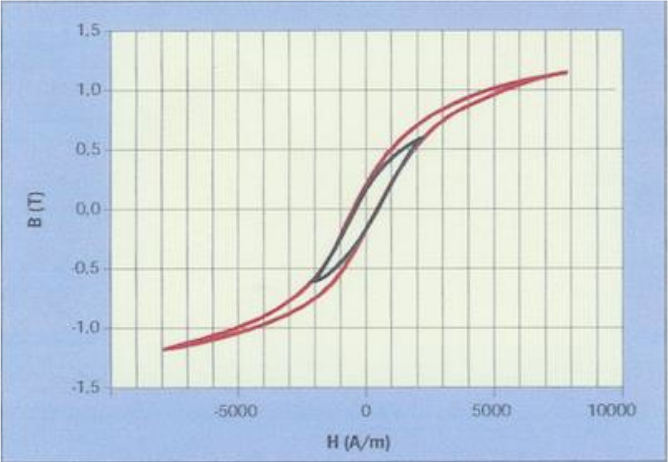

An air core won't saturate but a toroid can. Your advantage here is the low resistance. You mention one reason here.for low frequency and high power because it won't distort or saturate like a cheaper coil would.
Which indicates the cores involvement, and is part of the consideration toward saturation. There is a hysteresis plot available.the inductance value is higher for the same amount of coil wire using any other type of core.

Yes but 5.6 mH air core would be a very high DCR compared to any solid core. This particular inductor is rated for 700 WRMS with a DCR of 0.078 Ohms.
Other coils of that inductance I found were 15 or 16 AWG and they all had a DCR of 0.25 to more than 0.26 Ohms and rated for 400 to 500 WRMS. These had more common Ferrite or steel cores.
a 12 AWG flat foil air core inductor in this inductance has a DCR of at least 0.4 Ohms.
a 15 AWG air core inductor in this same value has a DCR of 0.63 Ohms.
The wire gauge and DCR are the most important here of course. But even at power line frequencies and audio frequencies the toroid shape core has many advantages as I understand it. It takes less coil wire turns with a toroid coil to reach the same inductance of other cored types. I posted two links that discuss this; that includes power line and audio frequencies; not just RF.
