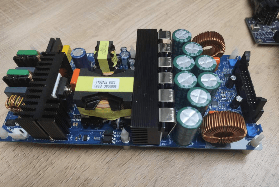

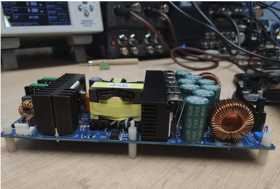

And, quick update here:
The universal power supply 2*300W amplifier module is ready for the public now :)

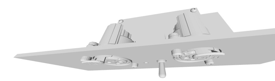

Can someone please point me to the files to CNC the rear panel cutouts for XLR and switch etc (dxf?) ? I saw the mech drawing file, but I really thought I'd seen reference to the panel cutouts too but I just can't find it now in the thread?
Hi, Chris
Please check the first thread for the drawing files. And re-attache it for you.

Thanks Eric! This is no doubt just me being foolish but I did look through those dxf files. I couldn't see which one I would import into panel designer software to make the correctly spaced cutouts when CNCing the rear panel? There seems to be a top profile of the I/O board and an XLR but not a complete layout for rear XLR and switch panel cutouts. Sorry if this is a really silly question. 😆

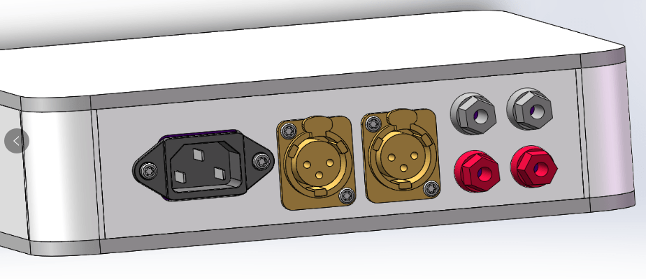

Hi, Chris
Sorry for the late reply, please attache 2d/3d files for the IO board with the rear panel.
