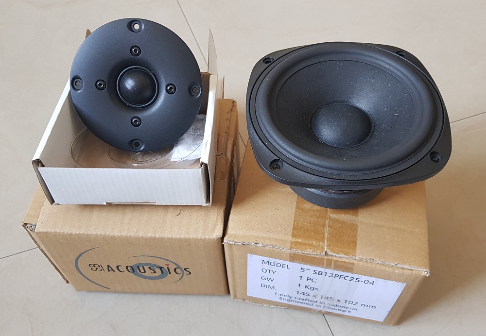

2way Speakers with SB Acoustics SB13PFC25-4 & SB26ST-C000-5

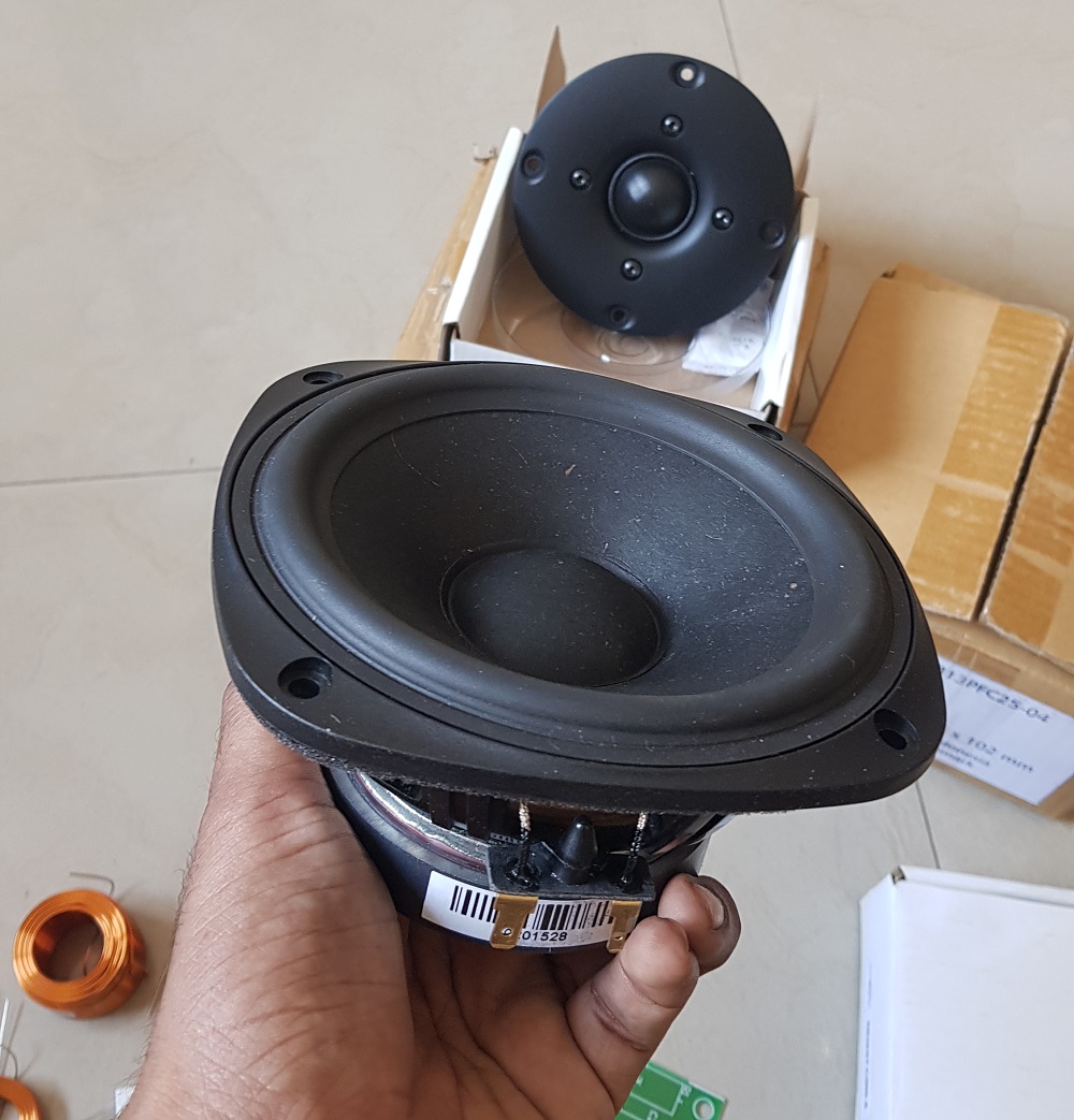

Started the 2way design with SB Acoustics SB13PFC25-4 Paper Cone Woofer and SB26ST-C000-5 Soft Fabric Dome Tweeters
Specs:
2way Floorstanding Speaker from 5'' mid-bass and 26mm dome tweeter.
Cabinet Volume: 8Ltrs
Woofers: SB13PFC25-4
Tweeter: SB26ST-C000-5
Nominal Impedance: 4 ohms
Port tuning Frequency: 45Hz
Cabinet Material: 6mm MDF + 12mm Pinewood
Cabinet External Dimensions: Height - 870mm X Width - 175mm X Depth - 232mm
Xover Design, Cabinet CNC Data, and Measurements will share soon

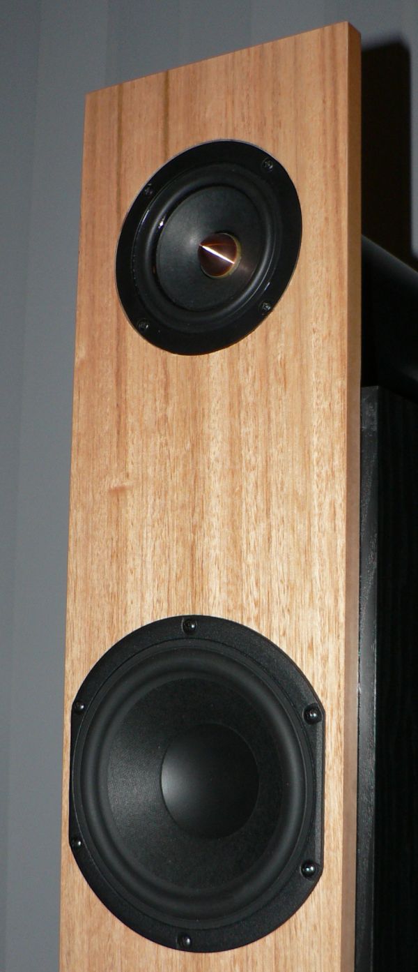

Cabinet looks fine except pine isn't a good choice for cabinet material. Not dense enough. Try Baltic birch or MDF instead.

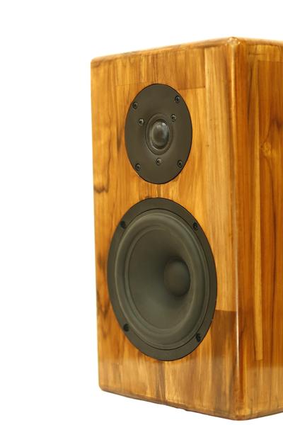

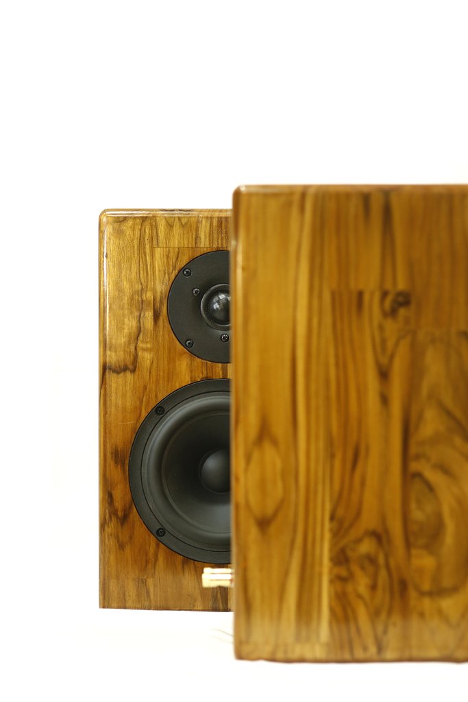

Yes, Pine is not a good choice for Cabinet acoustically so, I have given a try with MDF + Pine sandwich. I used MDF & Teak Wood (Attached Images) in my all builds.

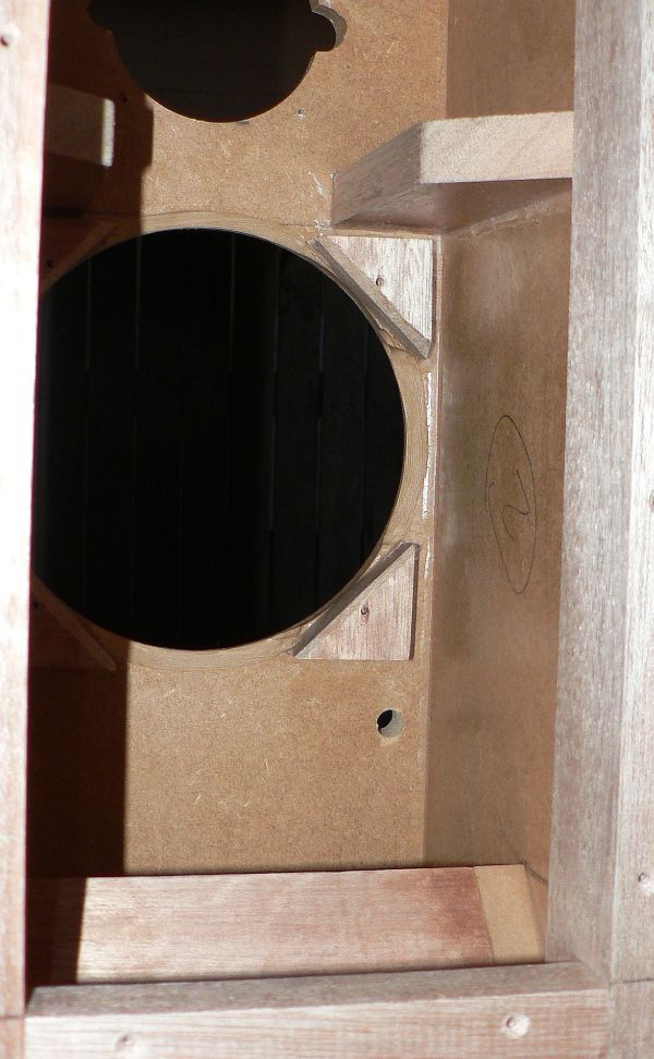

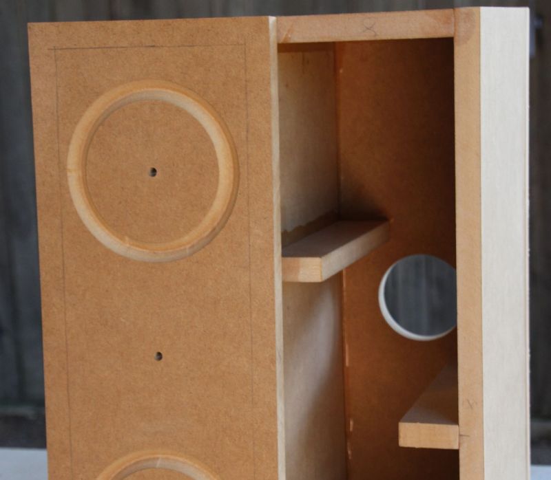

I couldn't see a couple of things in the pics. The woofer needs a 45° chamfer behind the baffle to help with air flow from the driver and easy enough to add with a router and a reversed 45° trimming bit. I don't know if the enclosure has any bracing inside as the panels should not have more than around 350mm without additional support or stiffening.
Easy enough to add with some P2P from side to side or some stiffeners or cleats added. I've shown a couple of examples of what I mean.
