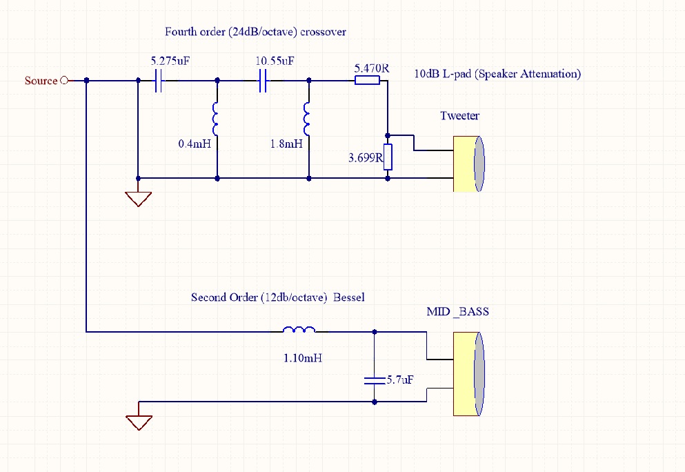

can you please check if this schematics is what you mention
In the second order crossover the phase shift 180 degrees (reversed polarity)
So I have to reverse the connection of the Mid-Bass is this correct?😕
Thank you for the help.

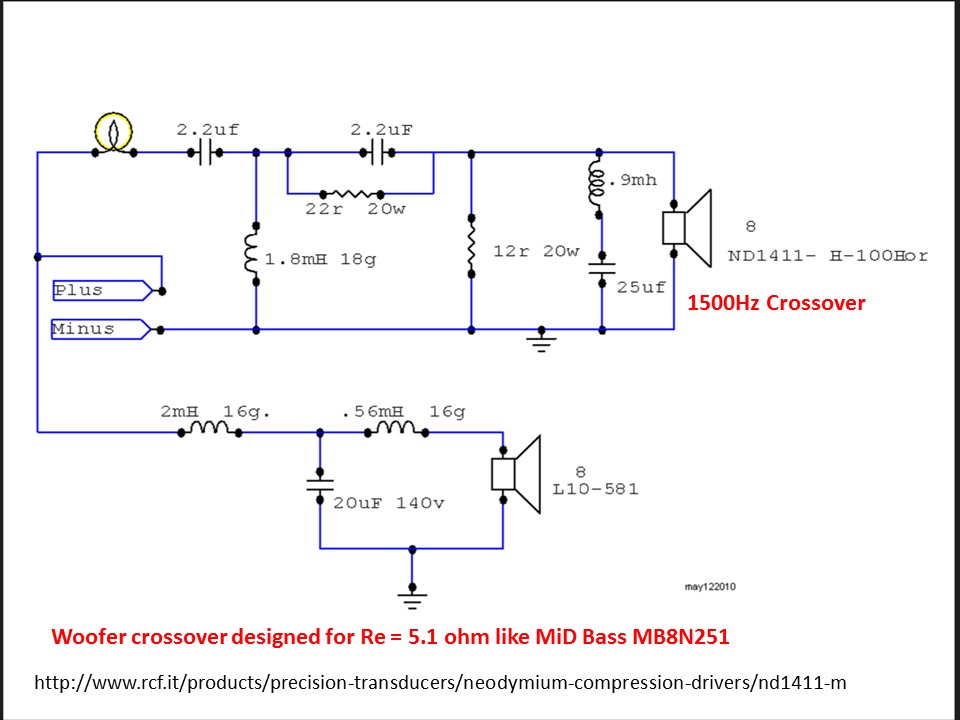

--From RCF website, this compression driver requires a horn.
--The attached RCF crossover should also work with your Re=5.1 ohm MiD Bass MB8N251.
--You may need to add a small value resistor in series with the tweeter to get a good SPL match.
--HF94 90-degree horizontal and 40-degree vertical beamwidth is popular horn for home use.

Can you tell me, please, what is the role of the two resistances in the high pass
filter?
for the impedance compensation I will use jantzen metallized polypropylene
Thanks for the help
Can you tell me, please, what is the role of the two resistances in the high pass filter?
schematic_post3
The 3.7 ohm and the 5.47 ohm resistors create an "L-Pad".
Info and on-line calculator here
http://www.bcae1.com/lpad.htm
The 3.7 ohm shunt resistor attenuates the 8 ohm (nominal) HF driver by about 10 dB.
The 3.7 ohm in parallel with the 8 ohm HF driver makes a 2.53 ohm load.
The 5.47 ohm series resistor restores the 8 ohm load in that part of the circuit.
I'm trying to figure out, this X-over layout ,what is the role of the two resistances the 22R and 12R are they work as a L-pad ? and the .9mH coil with 25uF cap are they a Zobel Circuit (Impedance Stabilization).
this are the two elements of this schematics that I don't' fully understand.
thanks for the help
