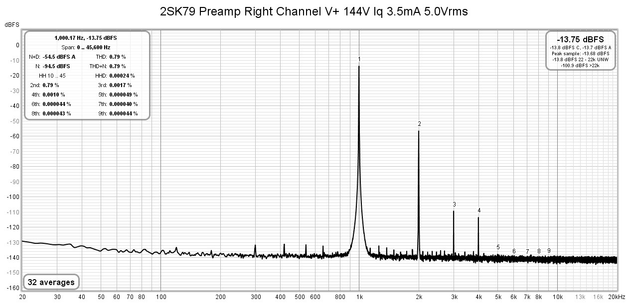

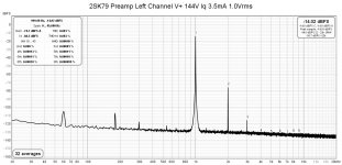

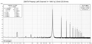

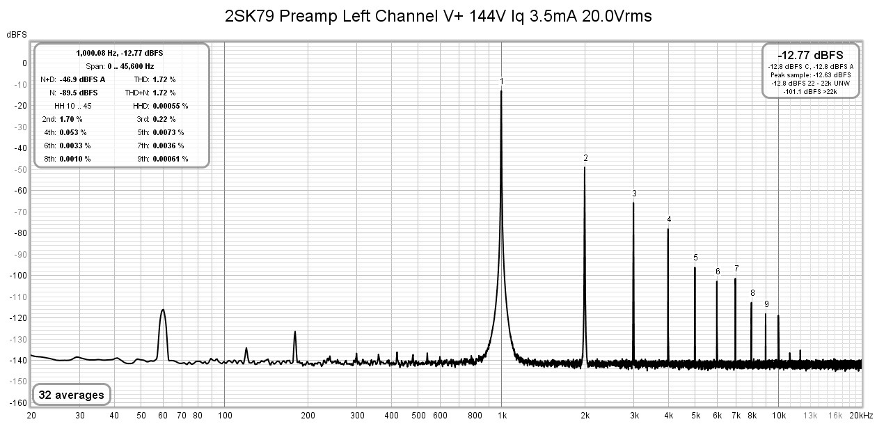

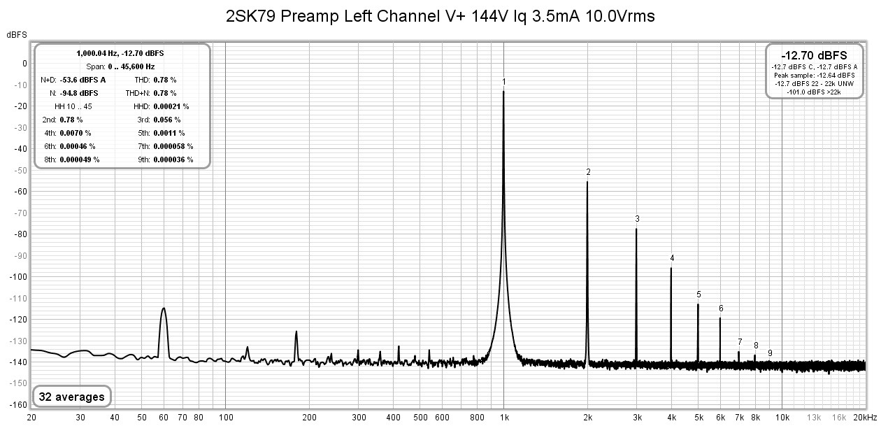

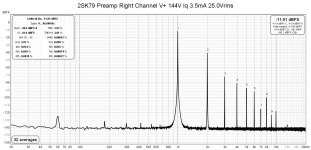

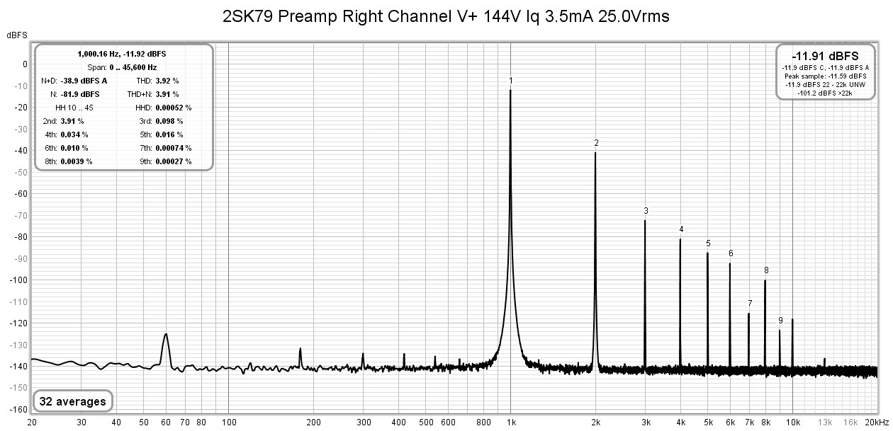

So to check a LTSPice simulation result, I changed the right channel buffers' V+ to 98V while keeping the 2SK79 V+ at 144V, as the simulation showed lower distortion than with V+ at 144V to both 2SK79 and buffers. It involved a bit more than just changing the voltage but long story short, the measured harmonic distortion was slightly lower, but at high voltage output, higher harmonics became prominent, similar to what was measured when I had the 2SK79 at V+ 98V and Vd 65V (post #36 - prominent higher harmonics at 20Vrms output).
So I went back to V+ 144V for buffers and 2SK79 (post #37). With that decision made, I modified the left channel circuit to match the right channel.
I ran distortion measurements for the left channel and here are the results. The left channel had much lower distortion, most likely due to both 2SK79 not being identical. See post #37 for the right channel's distortion. I have also added 5Vrms and 25Vrms measurements for the right channel for comparison.
I do not know whether the difference between the two 2SK79 is due to the 2SK79 manufacturing tolerances or perhaps the right channel 2SK79 had suffered some deterioration during its life. After all, they had already served some time in a Sony VFET amplifier before they were sold to me. I have no complaints with the sound so I am not going to try to find a replacement 2SK79 to lower the right channel's distortion.
In fact I am actually quite happy with the sound so no more tweaking of this preamp. It is finished. Currently it is feeding my summer amp, the 10W single ended 2SJ28 choke loaded follower, and they sound great.
It also has enough gain and voltage output to power my 50 Watt THF-51S Mu-Follower Follower monoblocks to full power. I do not need 50 Watts - most of the time my amps are probably sending less than one Watt to my 103dB speakers. But this is DIY, so more is better, and the fun is in the journey.
