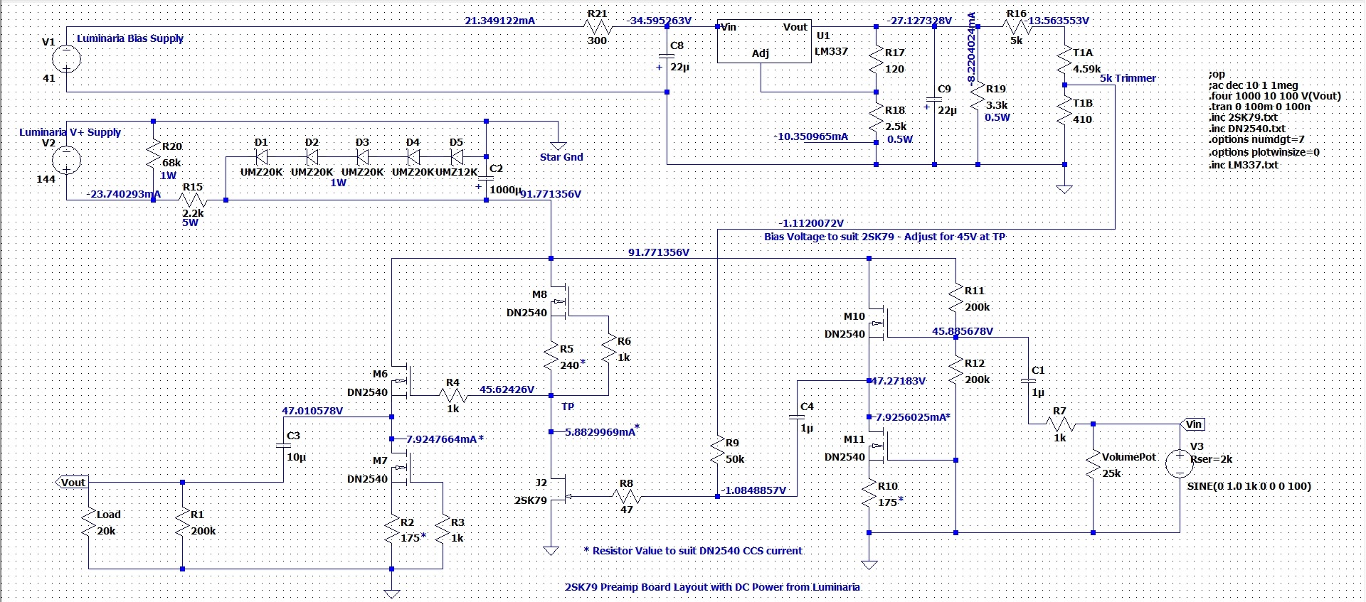

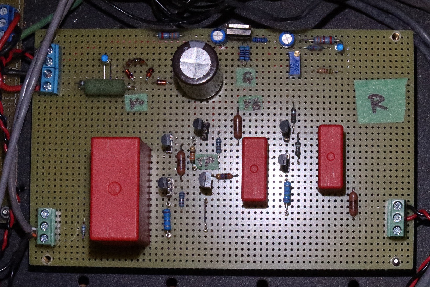

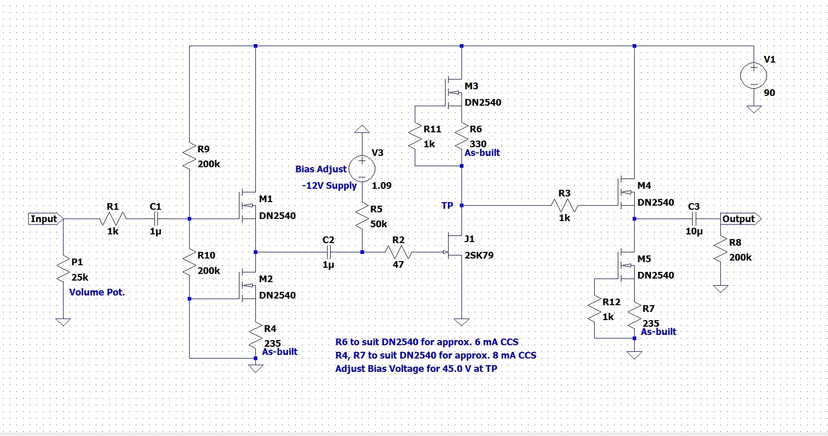

Earlier this year a pair of used 2SK79 was available at the diyAudio Swap Meet so I purchased them with the intention of using them in a high gain preamp/follower amplifier front end. I played around a bit with LTSpice and came up with a plan. I am not an EE, don't have the technical expertise, so I just threw some things together and hoped it would work. I took inspiration from the DN2540 buffer in the Luminaria and the B1 Korg's architecture of a triode sandwiched between CCSed JFET input and output buffers.
The result is a DN2540 CCS loaded DN2540 input buffer, followed by a DN2540 CCS loaded common source 2SK79 voltage amplifier, followed by a DN2540 CCS loaded DN2540 output buffer. V+ is 90VDC throughout and Iq is 8mA for the buffers and 6mA for the 2SK79. The power dissipation of the 2SK79 is 0.27W compared to the specified maximum of 0.75W at 25 degrees C.
Gain is 28.6dB (27X) according to LTSpice. I will measure to confirm. The Luminaria's gain is 17dB (7X). The distortion is in the same ballpark as my Luminaria, which was measureed at around 0.10% at 1Vrms at 1kHz. The specs for the Luminara state the THD as 0.006% at 1Vrms at 1kHz, but my Luminaria never had such low distortion. However that never did bother me as the distortion was second order dominant. That distortion worked well with the much lower distortion of my various SIT follower amplifiers.

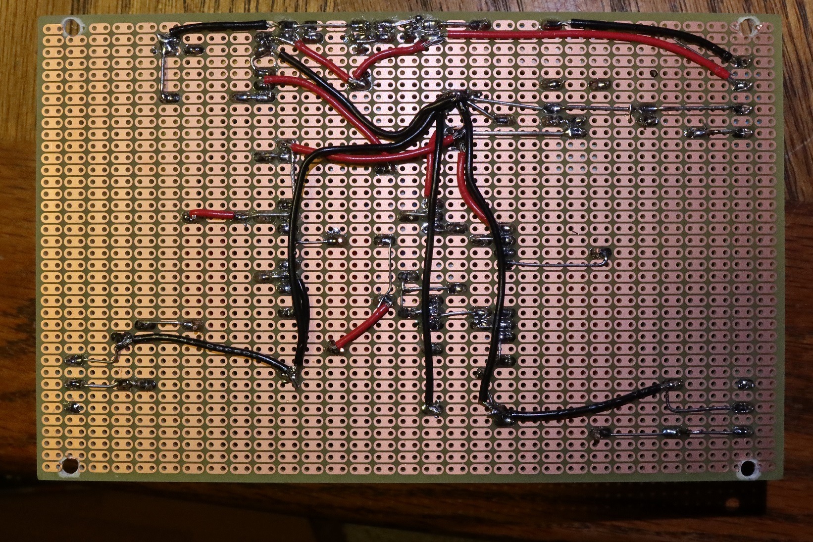

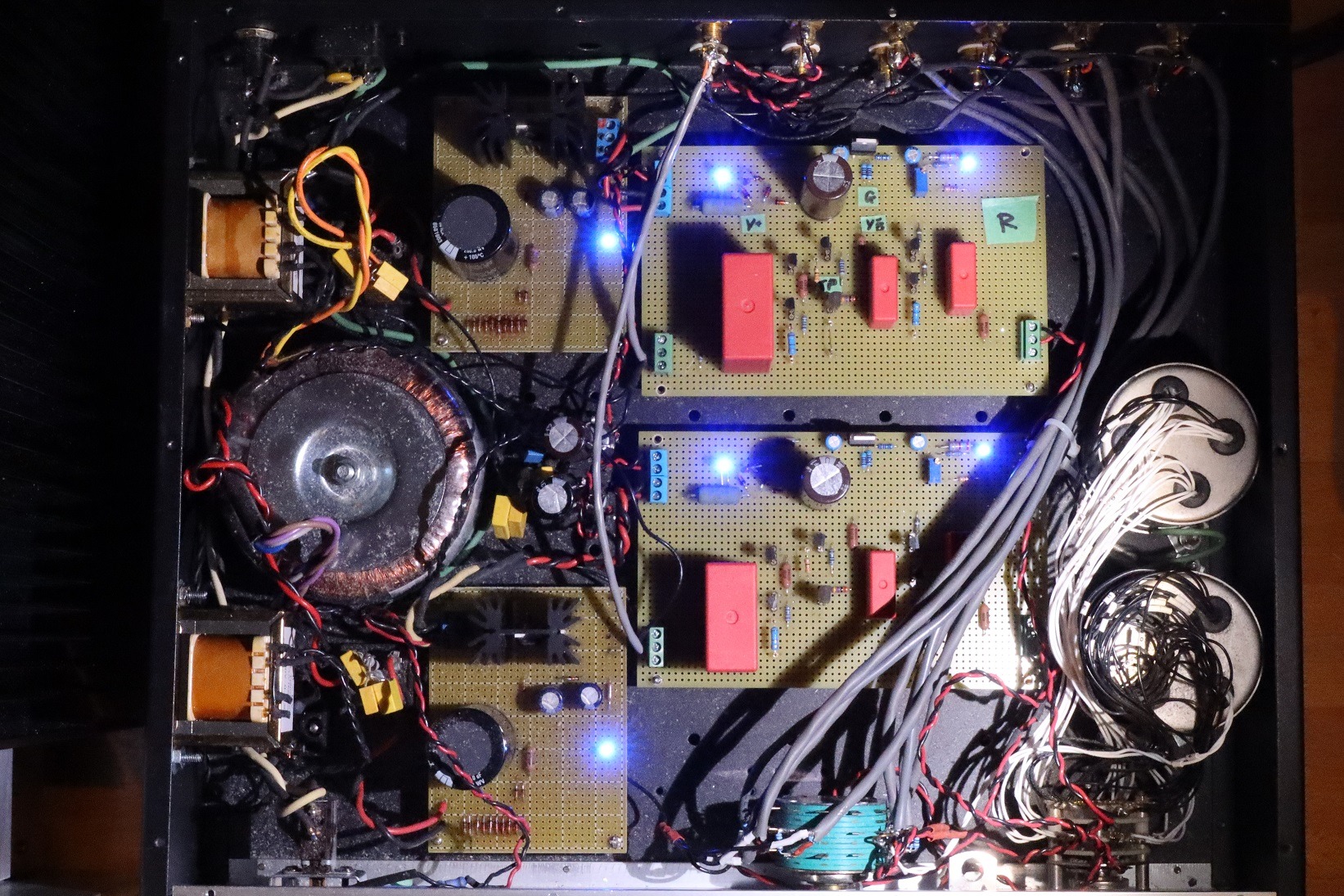

As usual I built the preamp on perfboards. It is housed in my Luminaria chassis, making use of the regulated V+ power supply and the C filtered bias power supply. On each channel's perfboard I added a zener diode shunt to drop the V+ and a LM337 regulator circuit to drop the bias voltage, as the 2SK79 circuit did not need the Luminaria's higher bias voltage. Also remaining are the preamp input and output circuitry. The Luminaria boards and the 2SK79 boards are identical in size and have the electrical connections in the same place, so I can easily swap the boards and have either a Luminaria or 2SK79 preamp in a matter of minutes. After I finished the first board, it replaced the Luminaria right channel and was powered up for tweaking of voltages and operating point, and then preliminary listening with done with the Luminaria left channel still in place for stereo sound.
Both channels are now finished, and I am enjoying the sound.

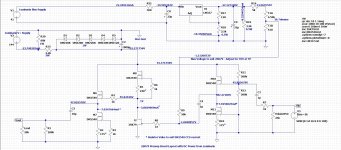

2022-05-19 Revised schematic here:Revised
2022-08-23 After much tweaking, this is the final circuit:Final Circuit

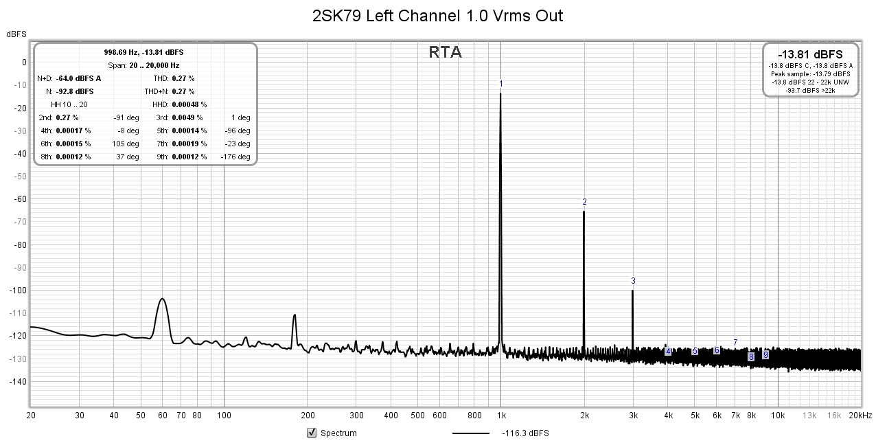

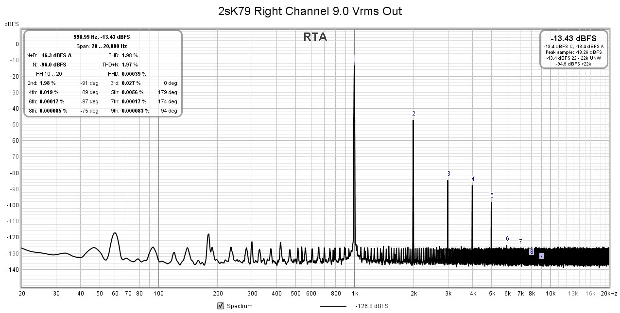

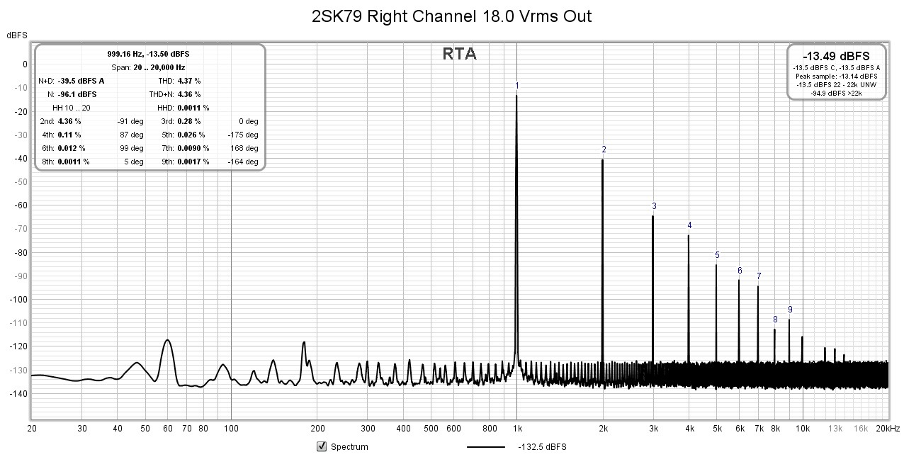

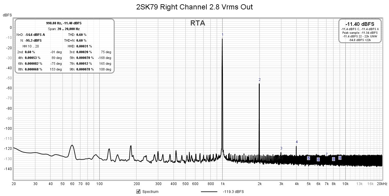

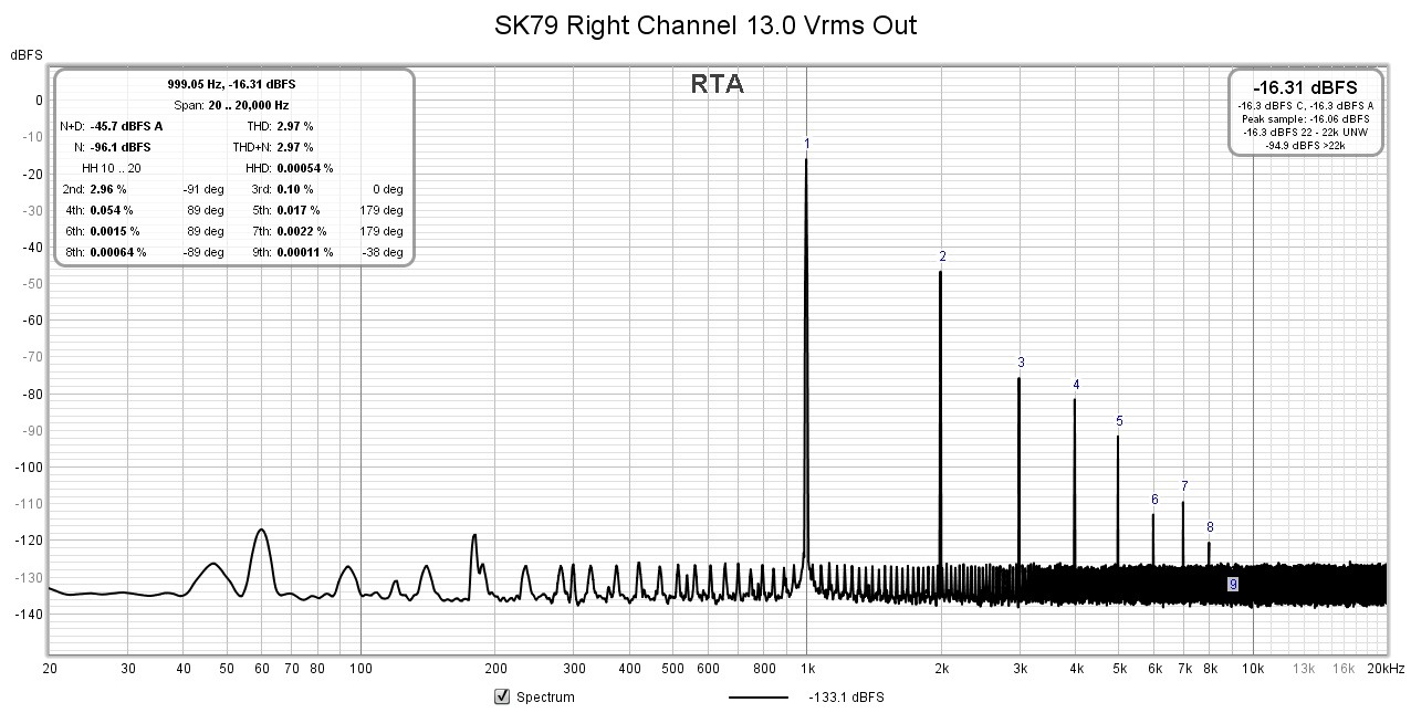

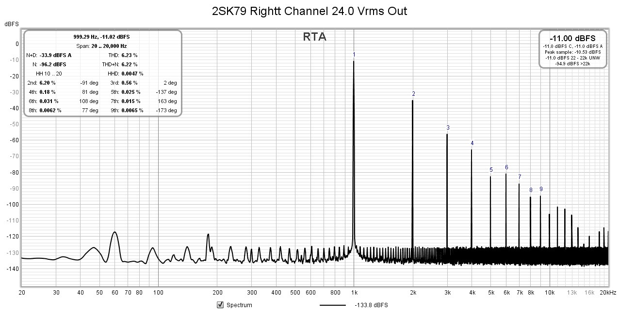

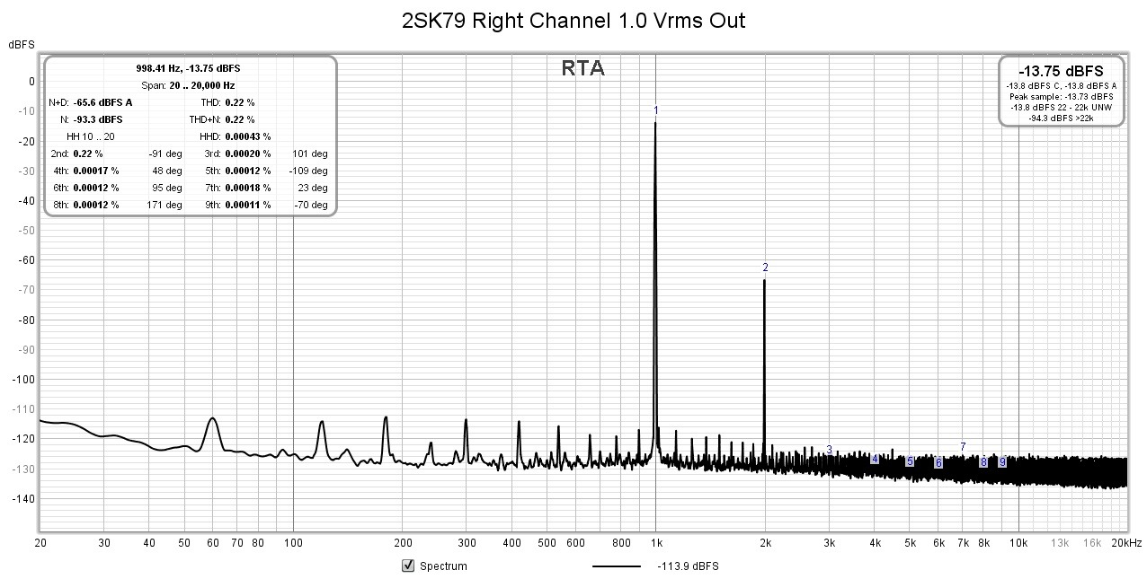

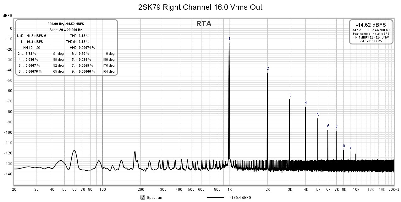

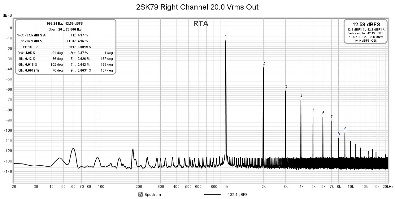

Here are the distortion measurements for the right channel. The output was loaded with a 20k resistor.

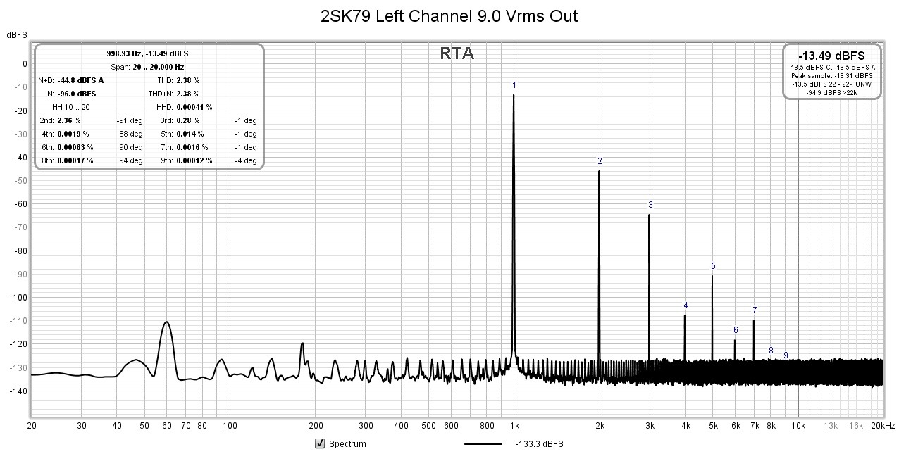

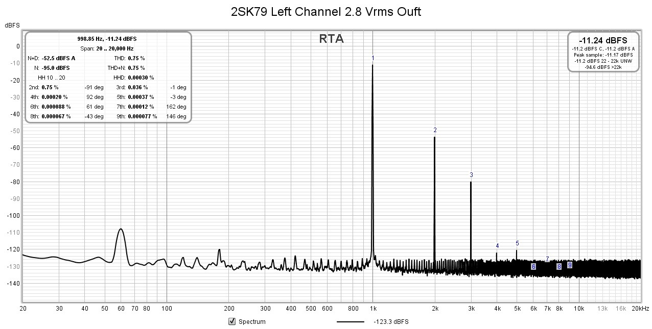

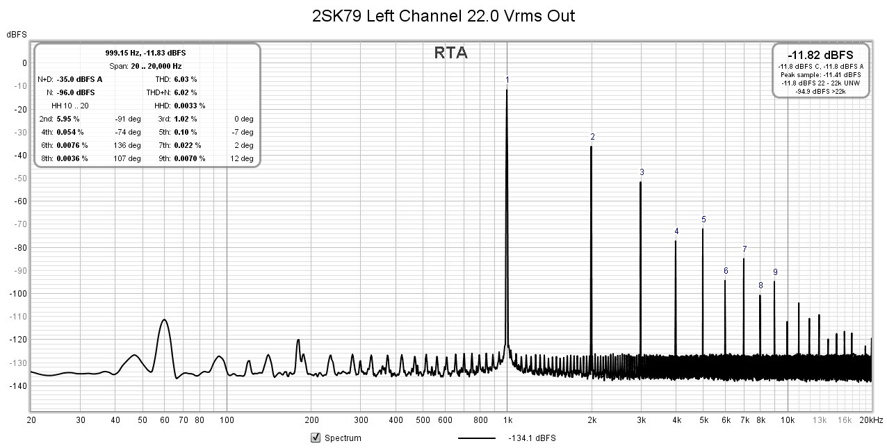

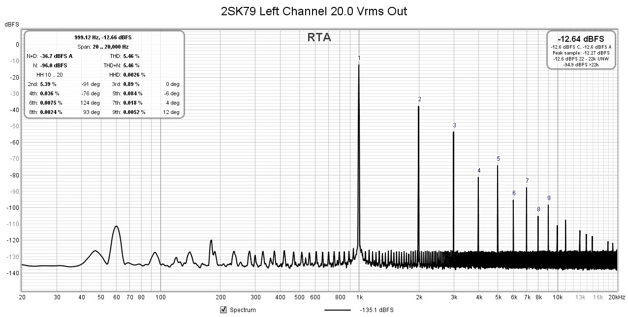

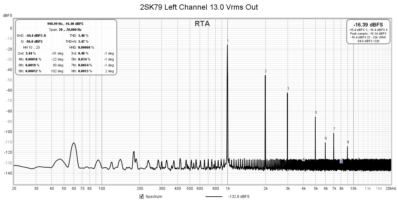

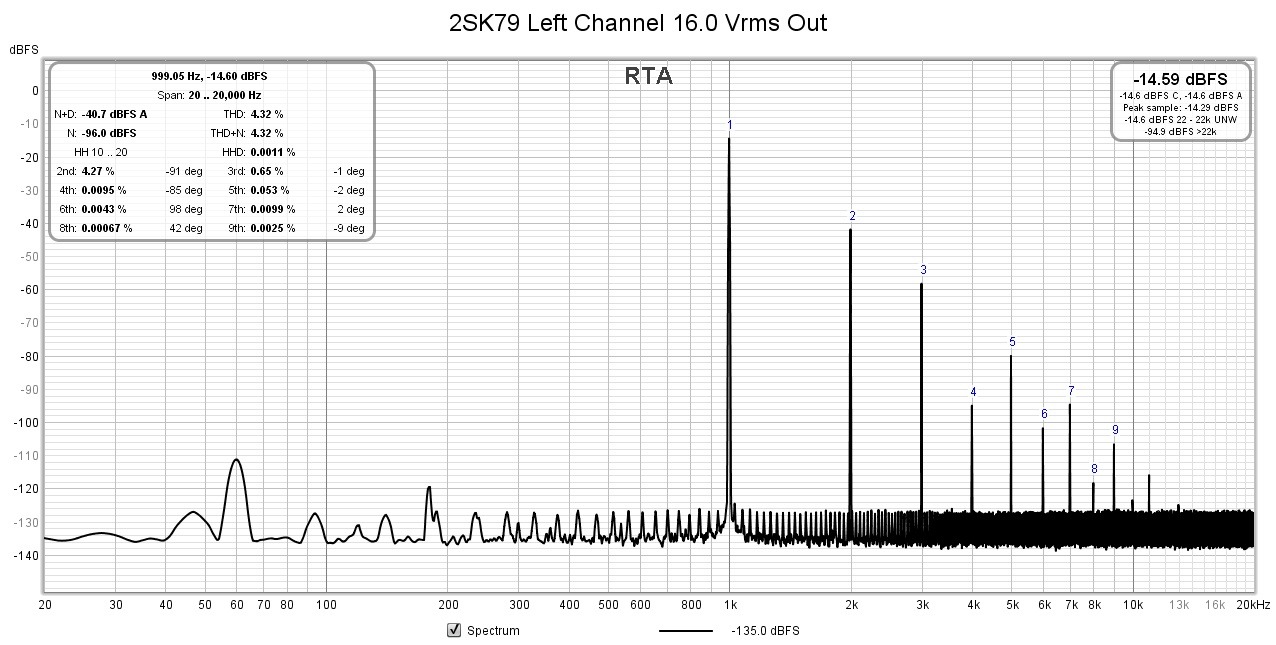

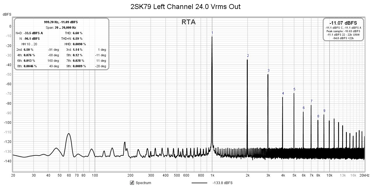

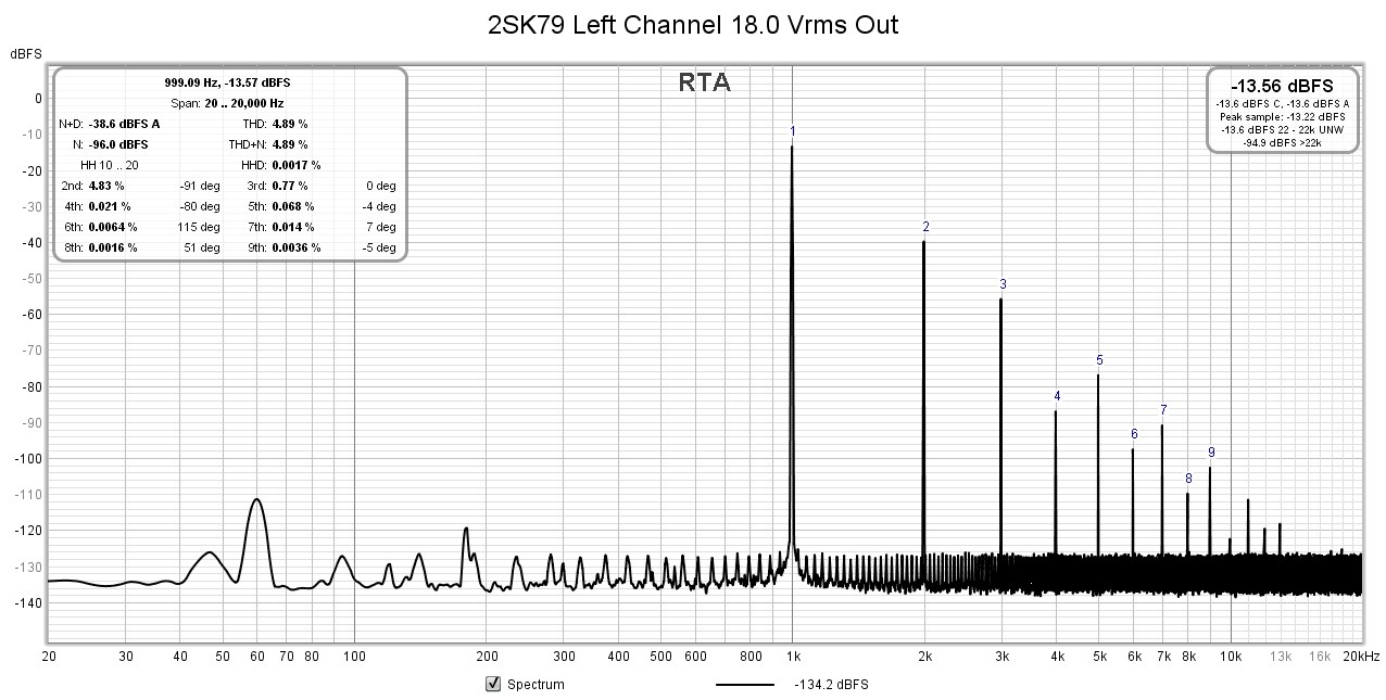

The distortion numbers for the left channel were a bit higher than the right channel numbers. Also the left channel had a bit more 3rd harmonic distortion.

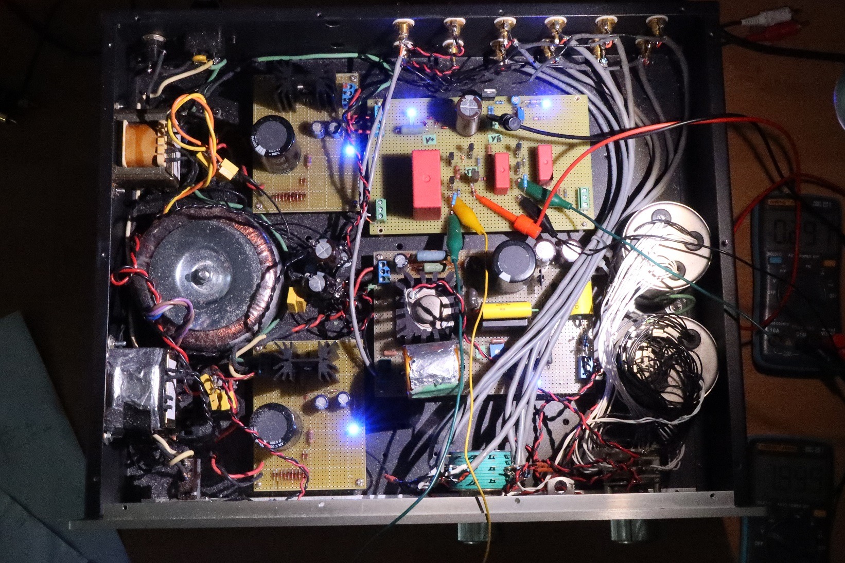

The left channel 2SK79 gave me a bit of a scare at first power up. I had done a quick low voltage Idss test when I received them so I knew that they were functional. However when I first powered up the board I could not get Vds to rise above 2V or so, regardless of the Vgs. The 2SK79 was mounted in a socket so I pushed and wiggled it a bit and I got a momentary high Vds reading. I was also monitoring the current and fortunately the CCS kept the current low the whole time. So I powered down, removed the board, and examined it. What I found was the gate pin had broken off a the base of the 2SK79. The 2SK79s were purchased used and the pins had probably been bent a few times before I received them, and I bent them a bit pushing them into the socket. The source pin was also on the verge of falling off. So what had happened was that with the gate not connected to receive the bias voltage, the drain was wide open and the drain resistance was very low, but the CCS saved the day.
Fortunately I was able to attach new pins. There was a very tiny stub of the pin left at the base of the 2SK79, so I applied a dab of flux and was able to solder a very small gauge lead from a high kOhm 1/4W resistor to the stub. Since the source pin was on the verge of falling off, I replaced that too.
So the 2SK79 survived to play another day.
Here are the left channel distortion measurements:
