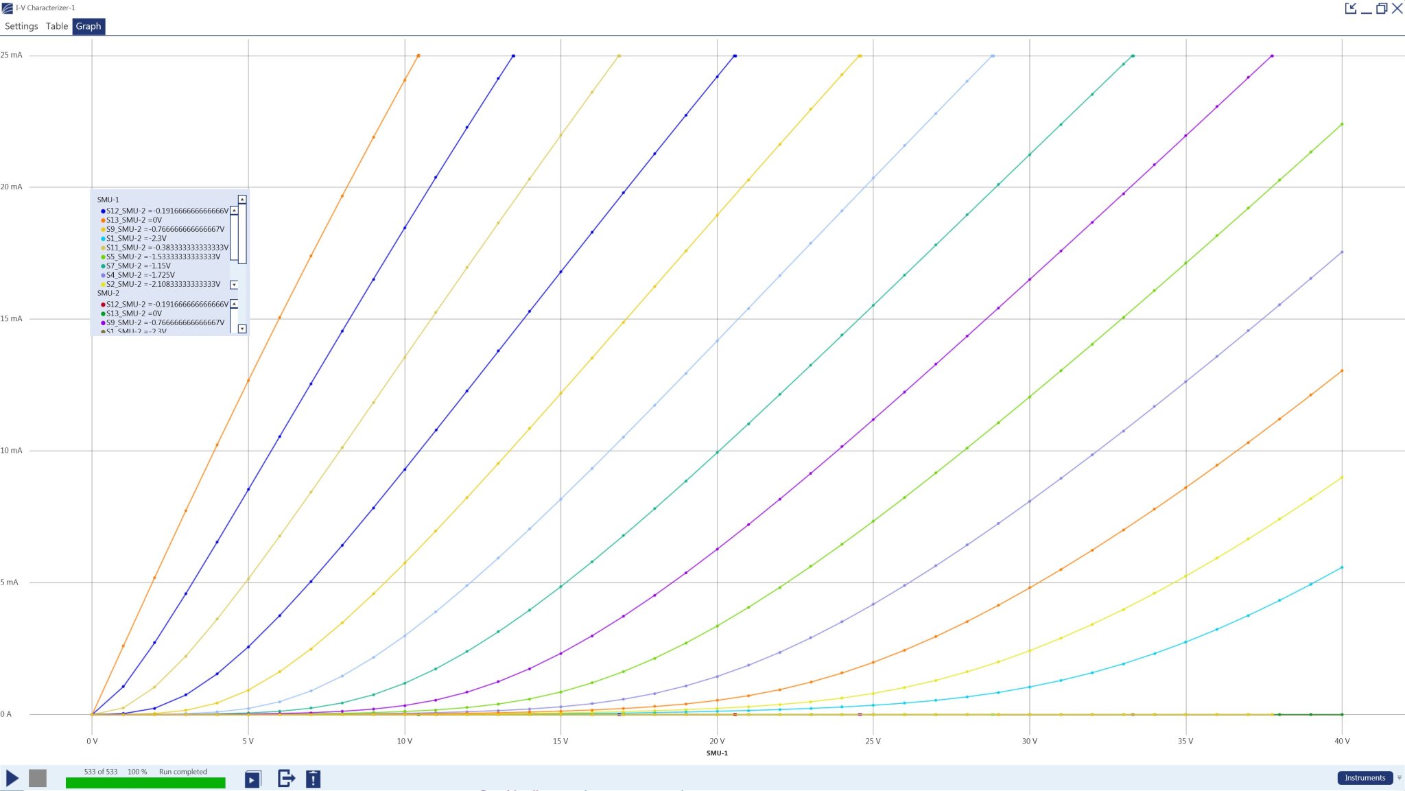

I tried a million permutations for a simple circuit about a year ago. I've been listening to the preamp I built with them since then. It's about as simple of a "tube" circuit as you can get. It has bypassed "cathode" bias and runs through a Tamura transformer (20k:600). Naturally the transformer is adding distortion, so take these with a grain of salt. But here are measurements that I made from 40V to 80V. All using a 442R resistor to set bias. I think the current was around the 5mA range or so? It's been a while. Regardless, distortion went down as voltage went up. At about 70V the gains got smaller, and it maxed out around 80V. This held true at any output level. Not sure what voltage these were taken at, but it was normalized.
BTW, my preamp is certainly not designed for high voltage swing. That's actually why I switched to a transformer from the preliminary choke load. It was just too much gain for what I needed. But the choke had better distortion numbers and more voltage swing. At any rate, I wanted a little "sauce" in there and what I landed on sounds great to me!
On that, I think I settled on 60V for the B+ and that ended up being 6 or 7ma.

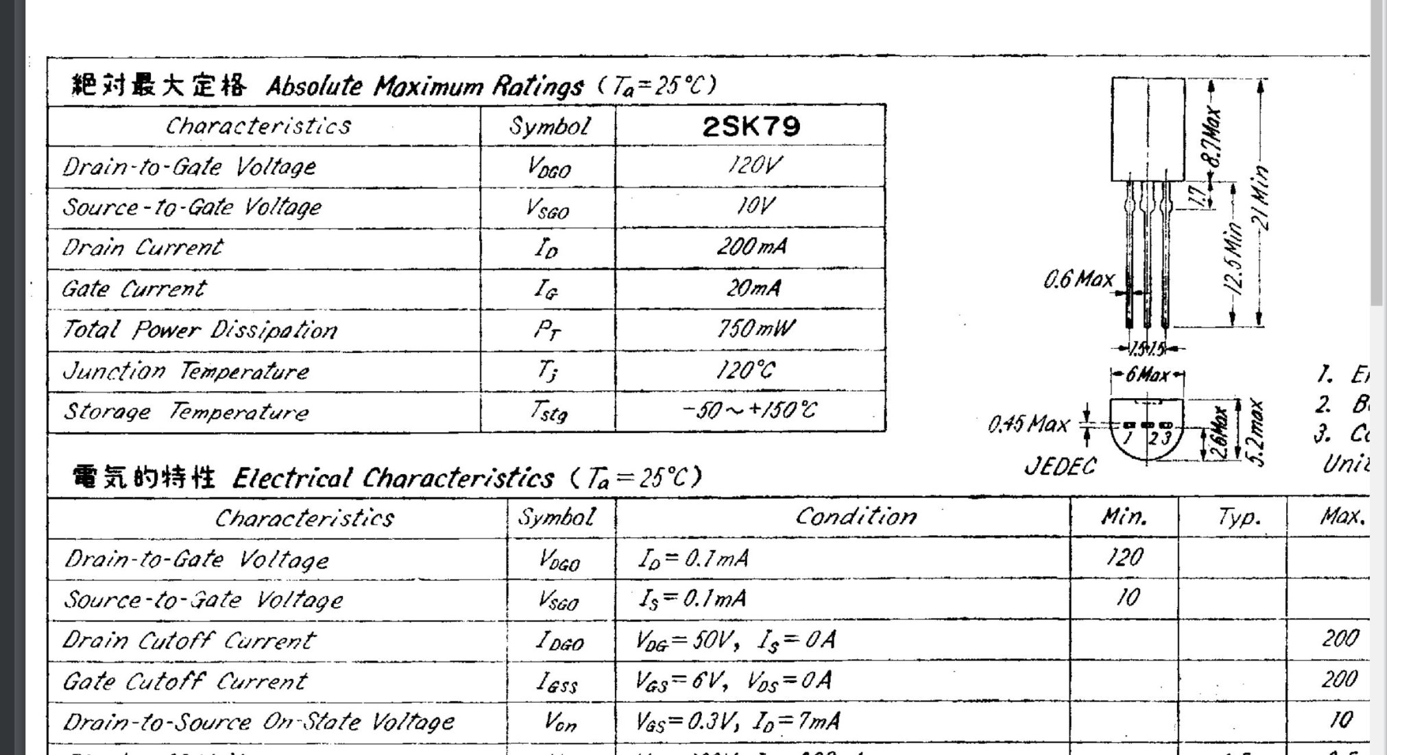

You took it up to 1.8 Watt!!!??? That's way over the specified limit. I would not do that with unobtanium parts.

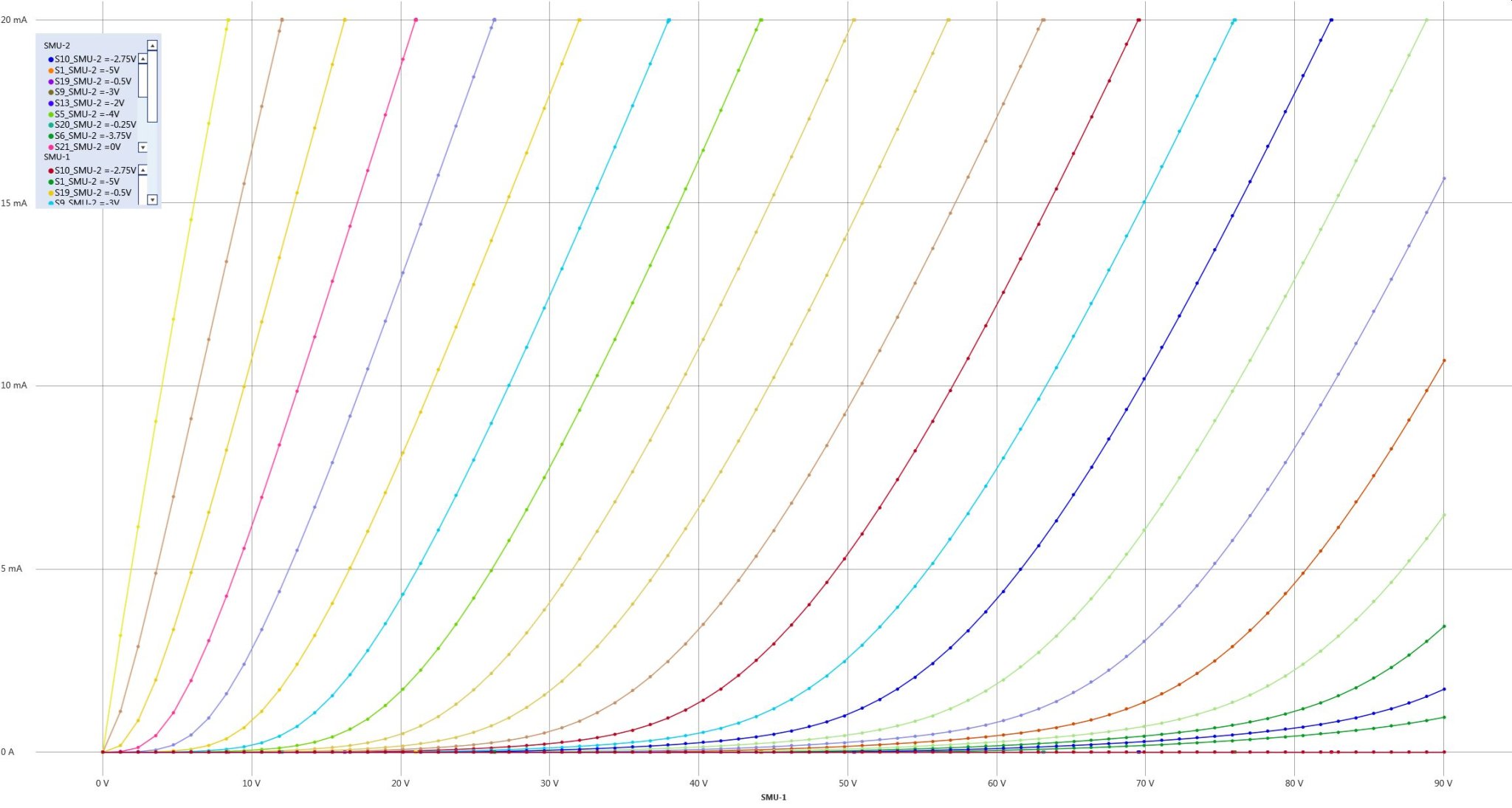

Nevertheless your curves just confirm my earlier curve measurements. These parts are more linear at higher voltage and current.
The settings for measurements were 0.1 NPLC which is 1.667 milliseconds per measurement. Average power is low during the measurement. The curves complete fairly quickly. Datasheet states 750 mW which I read as continuous. Momentary over max does not alarm me. The parts are pricey for sure. I am glad to have obtained some. I am planning to run the part at 45 to 50 volts Vds at 10mA. I burned in the part at 50v at 10 mA for some hours. I plan to attach a heatsink to the 2SK79.

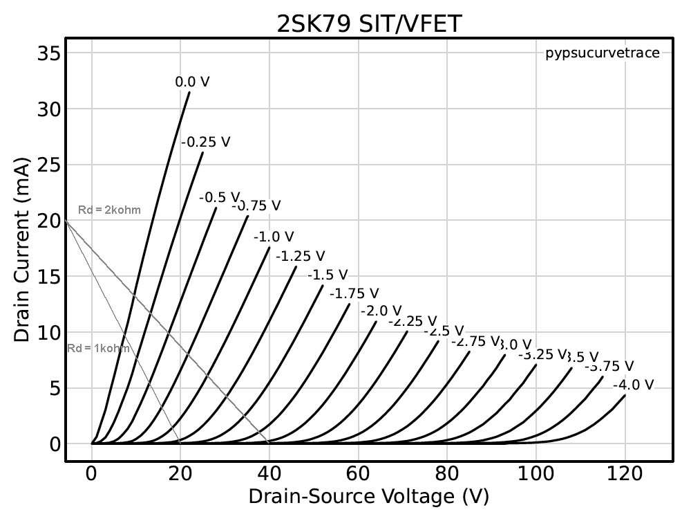

With a 100 V PSU and a 50 V / 10 mA bias point, you'd drop 50 V off the PSU at the load resistor, which would work out to 50 V / 10 mA = 5 kΩ. This 5 kΩ load line is shown in the attachment. Pretty decent, if you ask me. The dissipation on the 2SK79 would always be well below the 0.75 W.
How did you end up at the 2 W number?

I am running the 2SK79 at Vds=70V for dissipation of 245mW. The 2SK79 specification for maximum dissipation at 25 degrees C is 750mW. I am at one third of the 25 degrees C maximum dissipation and I think that is a reasonable maximum taking the actual operating temperature into consideration.
