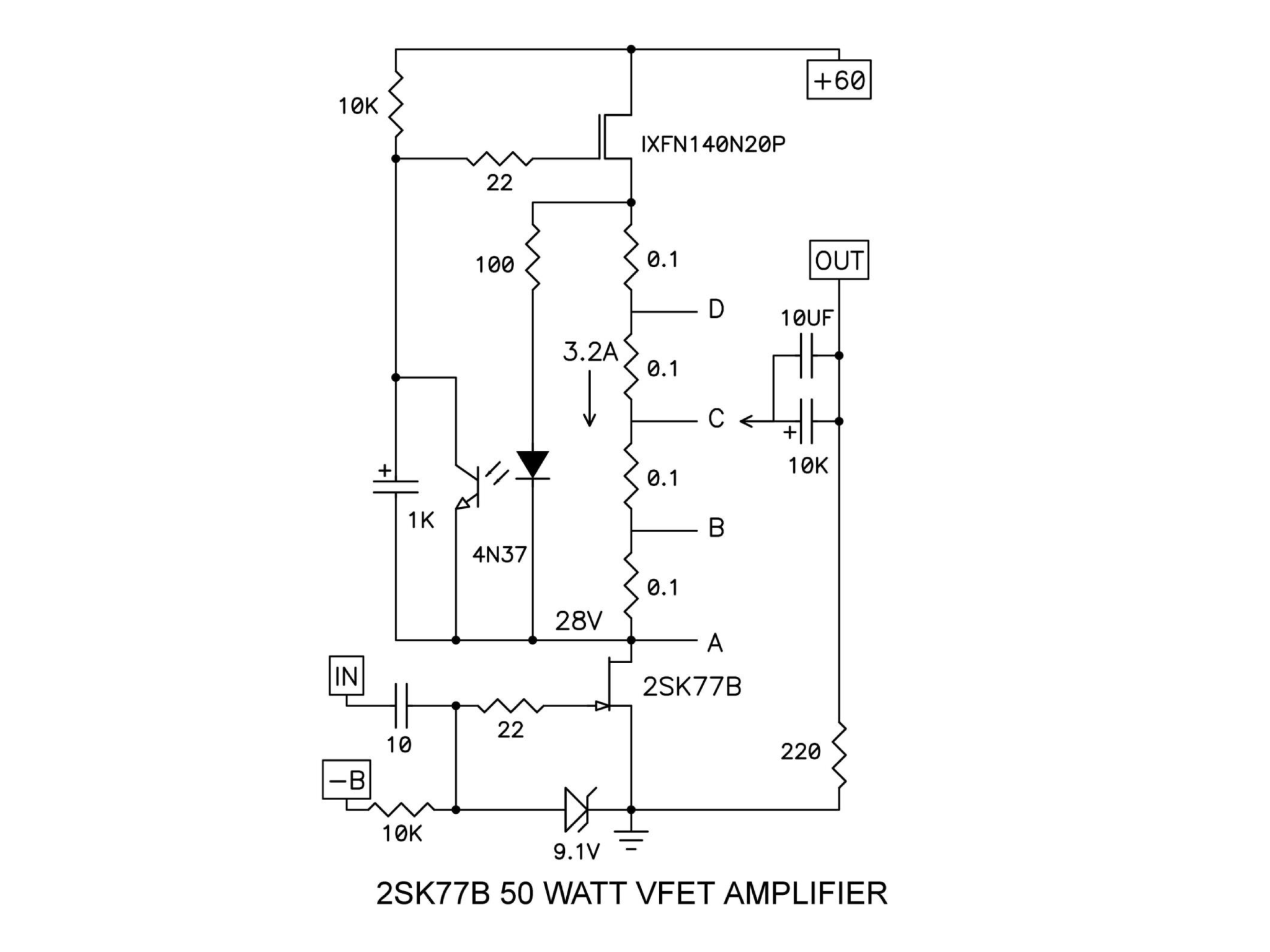

In this project the BIG BIG IXFN140N20P is used.
Of course only because its form factor matches the 2SK77 . . .

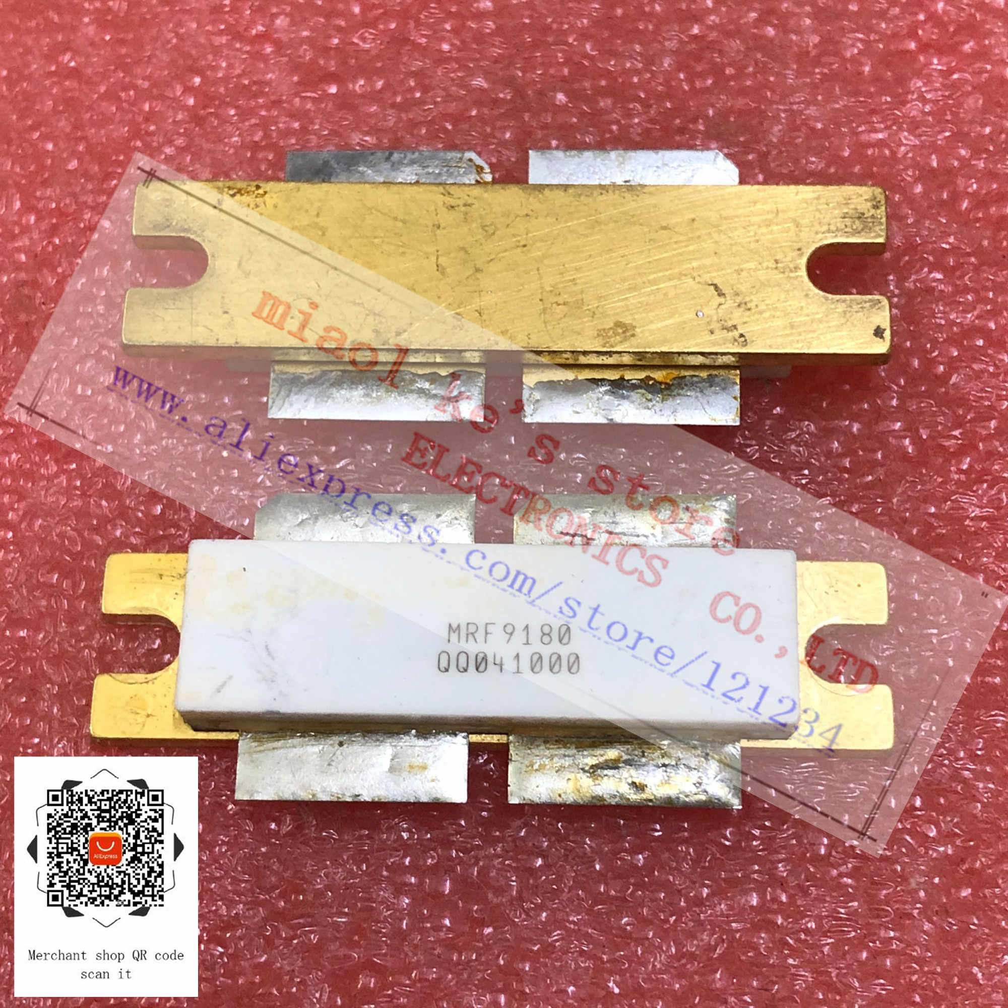

Recently I found some interesting Lateral Mosfets, ranging from 120 to 170 to 300 watts. They look very lineair; evenly spaced transfer lines. And they have extremely low input capacitance. At 65-85 pF <<1/100th of IXFN140N20P . . . So also great for babeltalk bottom use.
I am talking about RF mosfets like the MRF9120 and MRF9180, RF Power Field Effect Transistors once used for broadband transmitters around 860 MHz and higher; N-Channel Enhancement-Mode Lateral MOSFET. These are abundant, new or refurbished; available as single or matched double Mosfet. They have a gate flap [pin] and a drain flap [pin].
Meself I was thinking to use a Hitachi Lateral but these seem fine too.
- Does anyboybody have thought on this?

even if role of upper mosfet is important as any component in amplifier, it isn't overly critical - counting on fact that part itself is working as Mu follower, gate driven with low impedance
so- pretty much any decent mosfet, big enough and stated as good for DC operation (SOA) should work OK
if and when you find some interesting part, fuss is worth if you can use it in some other - more critical and important position in amp
example - that thingy could be interesting in Schade iteration of Papa's Big Puck amp, which he presented in same lecture

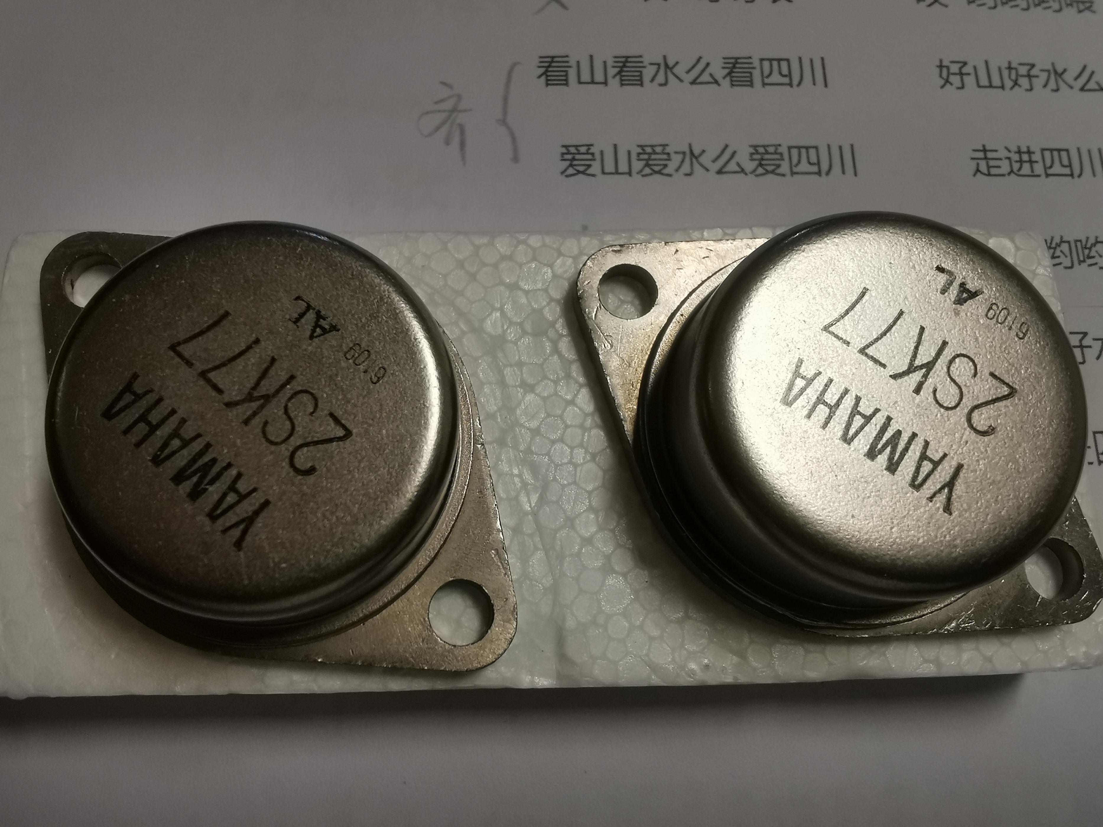

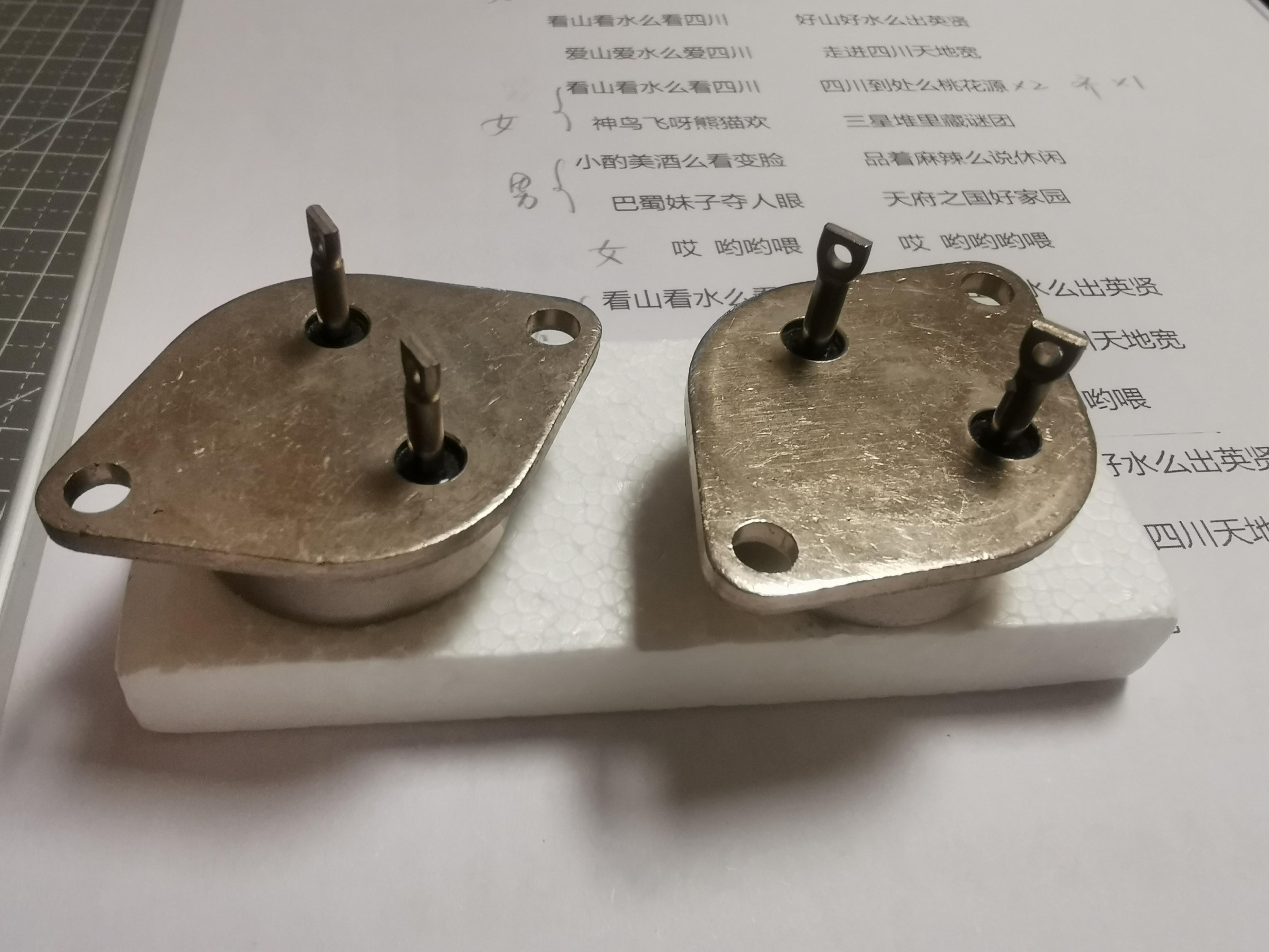

got one pair 2sk77,I am thinkg about how to use it in the big power amp.use for the follower or command drain model? any suggestion will be great appreciate.
Singing Bush, what else
practically , if having part scarce as that, you'll get most of it's character in Common Source arrangement ( voltage gain, output from drain)
or upcoming Choked Singing Bush ( end of same thread), though that one still need to be verified in vivo
you have all schematics, even breadboard will do
