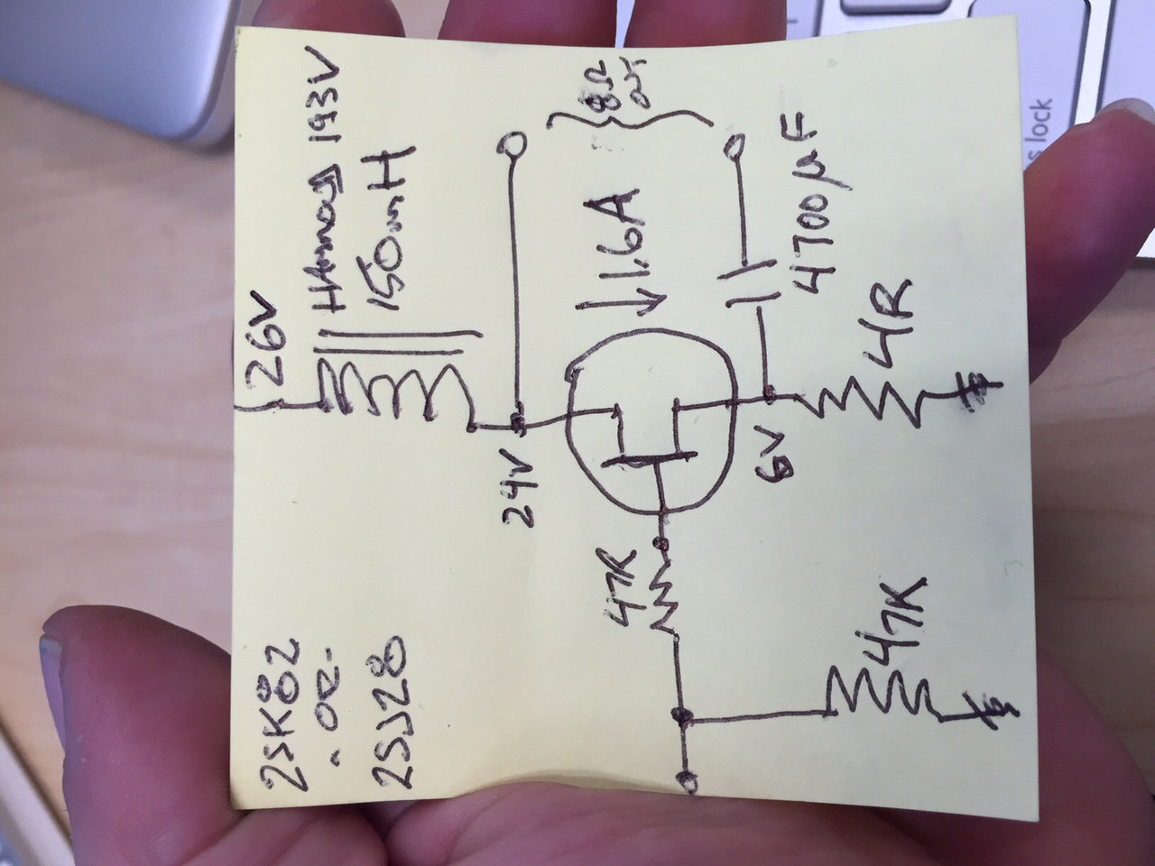

i use this simple auto bias method but with a Mosfet CCS instead of the choke loading , 1.8R source resistor and A 6800uf output cap as i don't have a 4700uf
it seems that i have small bump at 30/40hz with my speaker that i dont' have with my other amps. perhaps the value of the "pseudo parafeed "output cap is critical. i will try with smaller ones 🙂

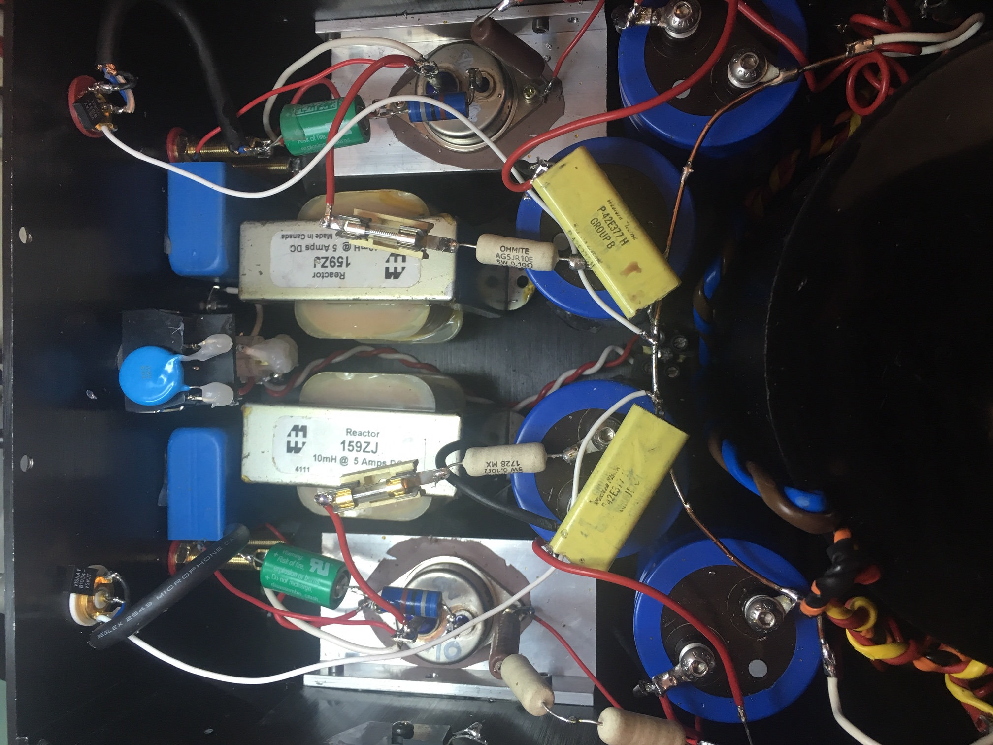

it is alive , my THF51S l'amp CCS with IXTH6N50D2
the B+ is 60V the THF51S is running at 30V VDS and 2.1 AMP with auto bias and a 6800uf capacitor output return to source ( western electric schema)

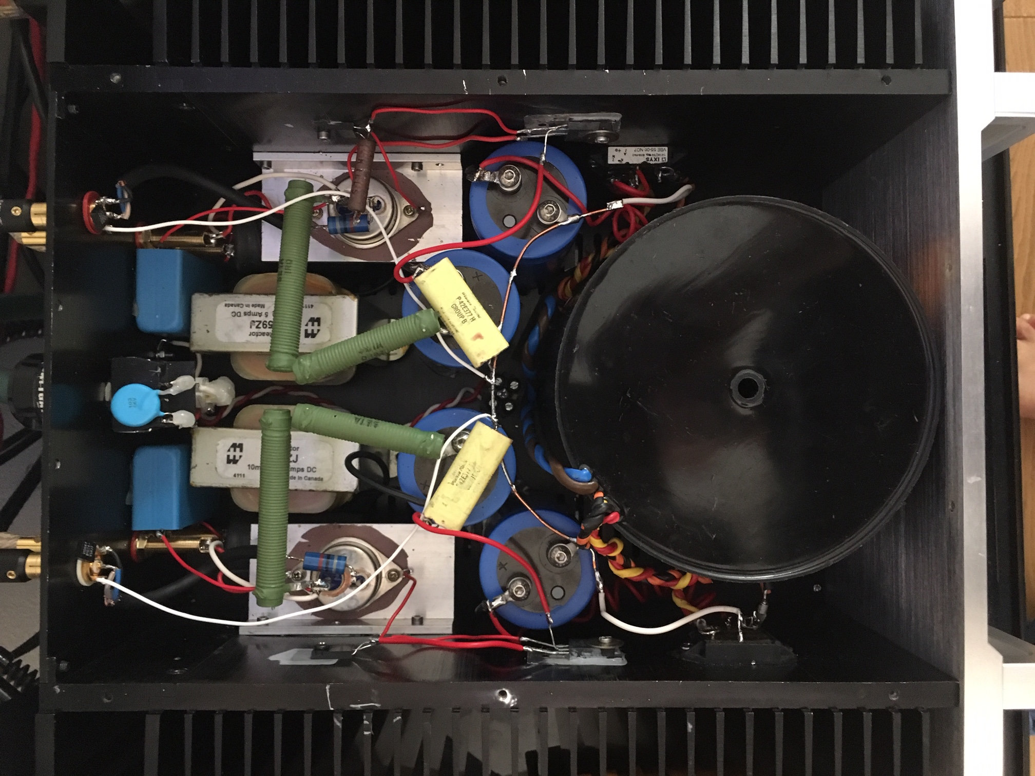

i have made a CLC power filter but finally get more noise than with CRC ( surely the chokes are to close of something) but nothing dramatic.

i have use this method with many amps during month and never had problems with battery discharge . perhaps but my amp never last so long before being rebuilt in something else 🙂
works well with 3,6V lithium buton cell ( on the grid and not on the source !!)
somtething strange with the "wester electric bypass cap" and auto-bias the sound seems too good to be true. everything is big with an enormous soundstage and 3D effect. to compare the fixed bias with battery grid bias seems smalller and flat but more real .
the effect of the positive feedback injected by the return of the speaker directly to the source ?

i had some nasty noise on the speaker so i have tried to change the PS to a CRCRC but it doesn't change , it is more like a buzzing. as on the pictures my CCS source resistor is a wirewound type perhaps acting like an antena i will try a non indiuctive film one.. i have change my 6800uf output cap to a 4700uf and now the Bass are more real , no more bumps at 30hz.

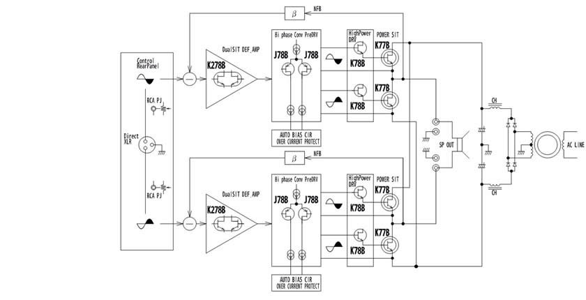

Super work on amorphous core input choke's for the PSU and nanocrystalline transformers for SIT's output stages.
I stay in tune for part 2 of the amp construction article.... ambitious high quality as usual made by Dave Slagle.

There was only a prototype, currently disassembled.
The dissipation of the one presented at BAF was 180 w/ch. That's
a pretty serious sink - better use two....
