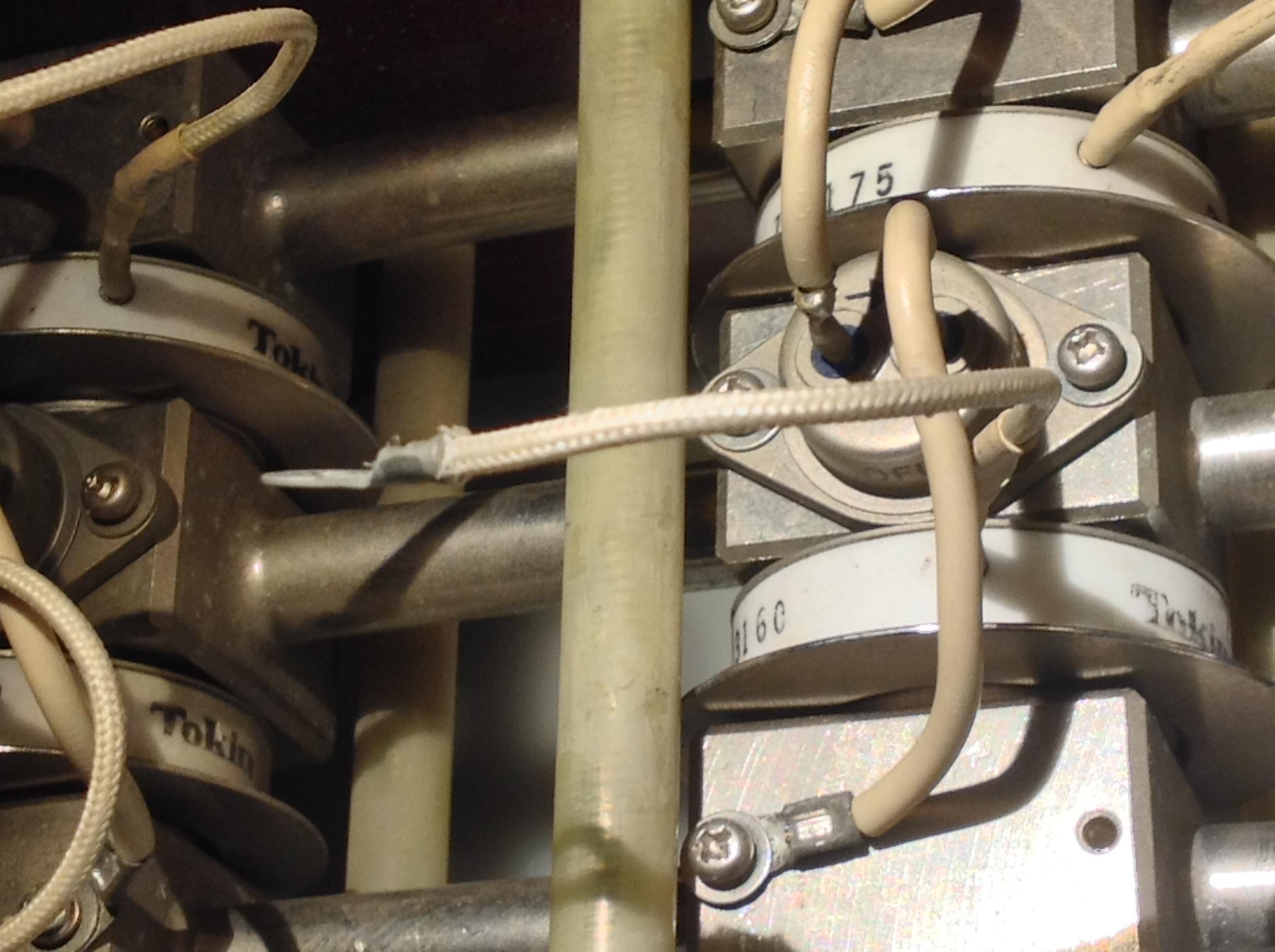

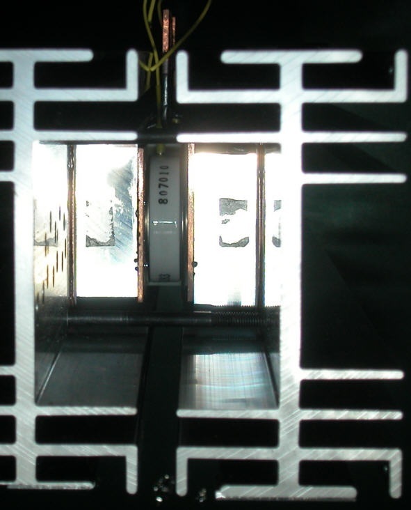

If it was not for the full colour I would say the electronics in Soundhappy’s post came right out ofp the original Frankenstein movie.
or Stanley Kubrick Sci-Fi 😀 metal cube's and pipes structure are the water or air cooling heat dissipation system.

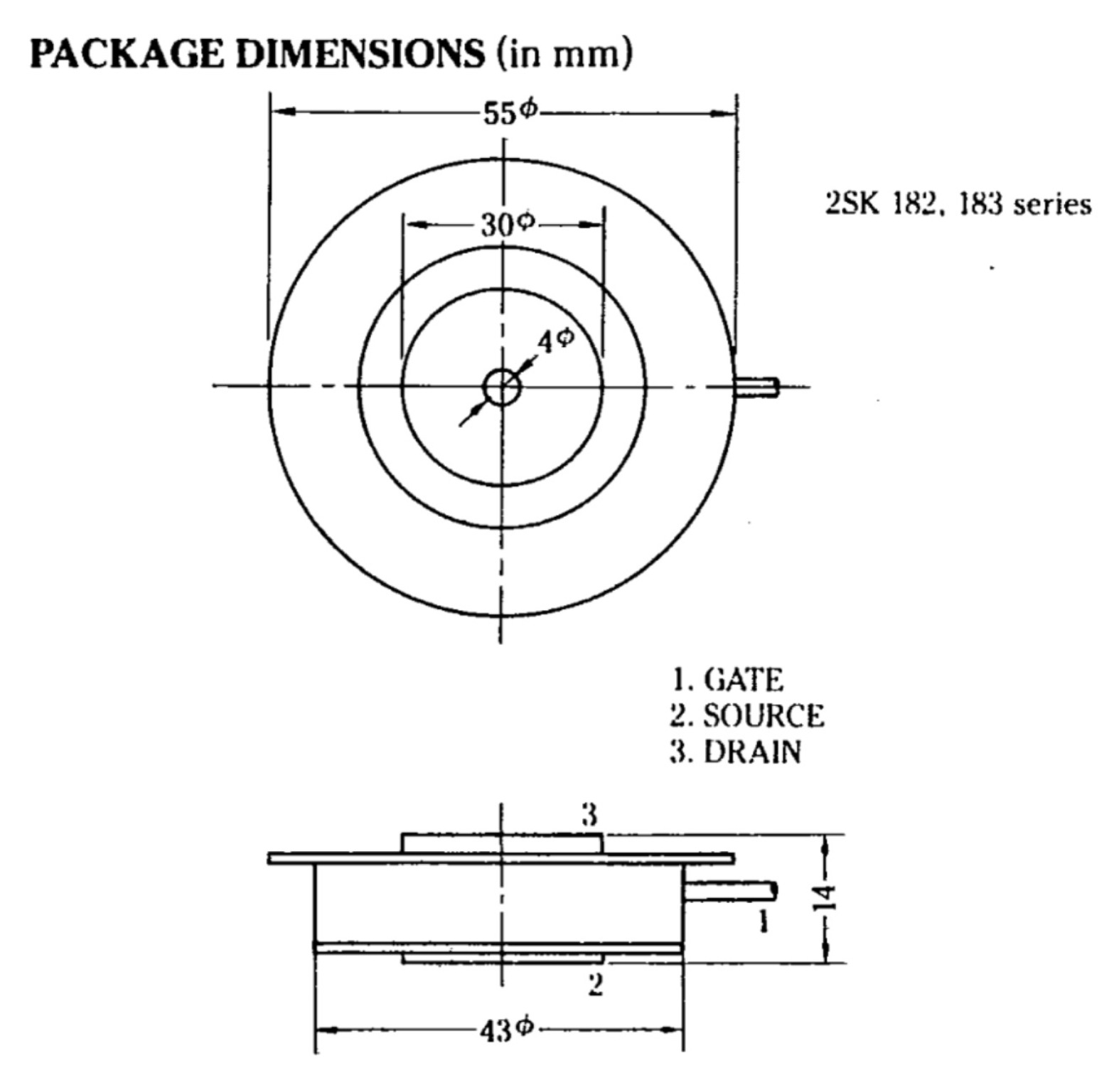

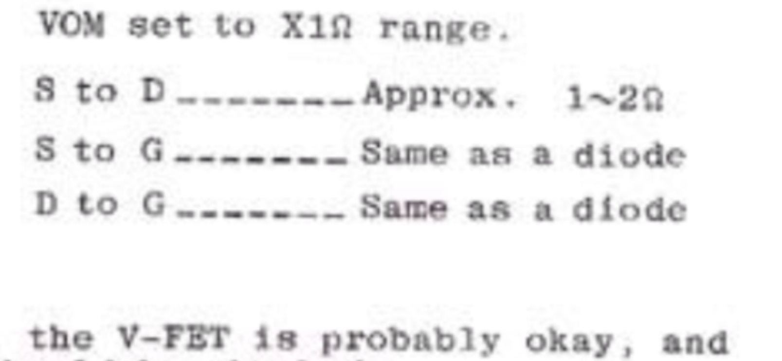

1000 Watt's space saucers 2SK182 simple test of resistance 4 wires Kelvin = 0.41 Ohm ( 1 ~ 2 ohm for Sony ) and diode test are OK.
2SK180 source - drain resistance test = 1.33 Ohms and 2SK182ES R test = 0.81 Ohm

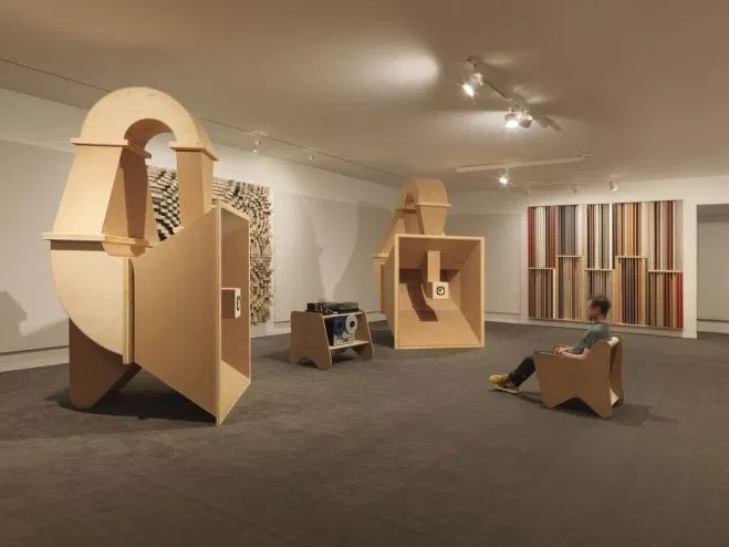

I built El Pipe-O myself (as I recall), and the Kleinhorns were constructed
by my interns that summer Chris and Matt Williams.
Both were donated to an artist's collective in Oakland.
Don't know what became of them since.
Interesting off topic
Kevin Schmidt: We Are the Robots Exhibit Review - Reviews - Computer Audiophile

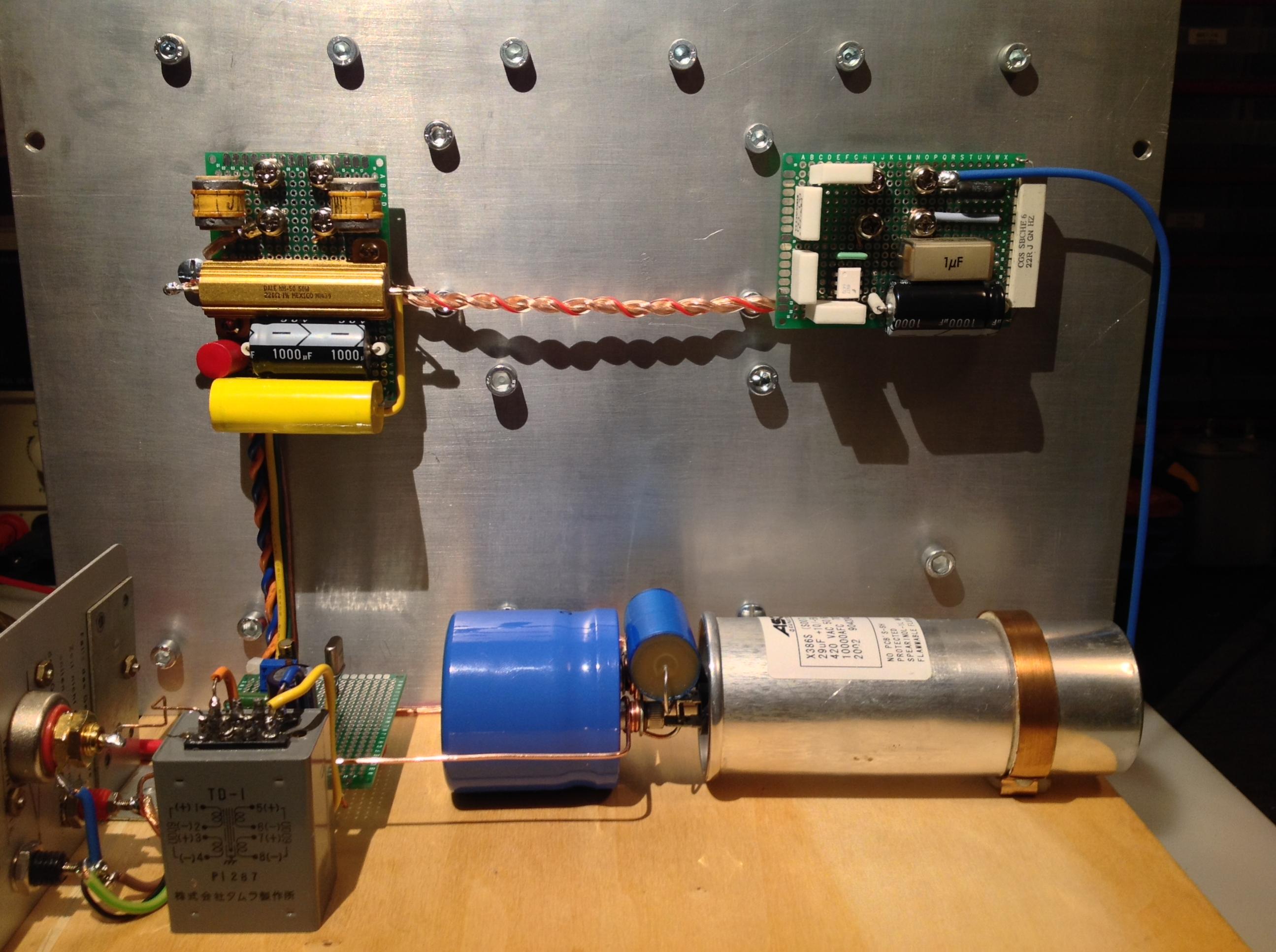

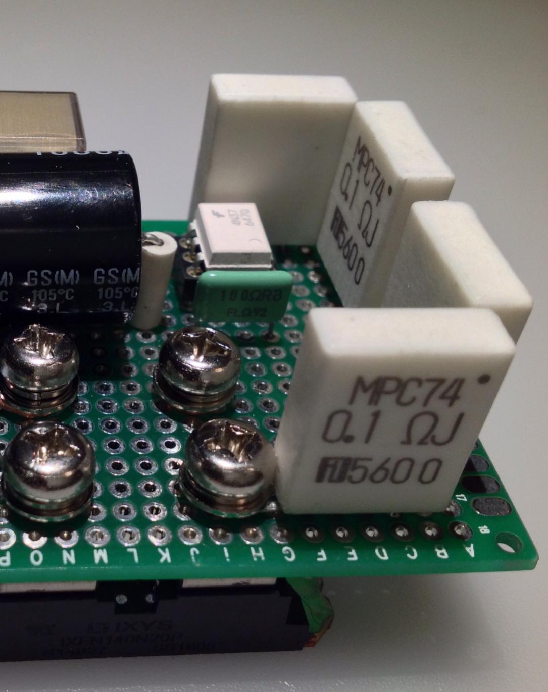

i'm begining to build a THF51S l'AMP with IXTH6N50D2 michael CSS
power supply will be 2X 45V 500VA , 39OOOuf 1R 39000uf , my goal is nearly 25V B+ at 2amp ( with autobias on the VFET)
is the 1R CCS source resistor needs to be variable ? or is it self adapting ?
it is alive , my THF51S l'amp CCS with IXTH6N50D2
the B+ is 60V the THF51S is running at 30V VDS and 2.1 AMP with auto bias and a 6800uf capacitor output return to source ( western electric schema)
i have made a CLC power filter but finally get more noise than with CRC ( surely the chokes are to close of something) but nothing dramatic.
i have 1R CCS source resistor on one side and 0.8R on the other to get the same bias and vds on the VFET ( my mosfet are not matched i suppose)
sound is very good somehow very different than my alpeh min or Sony pushpull VFet. don't know if i will buy some hig power resistor to try or Chokes for the moment. it seems more powerfull than my previous build with 2SK82 but it can be a illusion of the fresh build , i will see for the next days 😀
