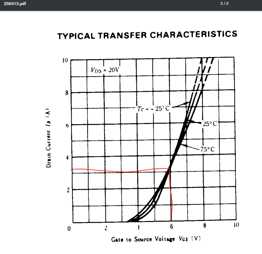

those mosfets are not lateral mosfets; the zero tempco point of the 2sk413/2sj118 series is VERY different from the one for the lateral mosfets in the 2sk1058/2sj162 series!
see data sheet excepts below.
the simple bias network will not work properly with non-lateral devices!

Is the attached scheme suitable?
