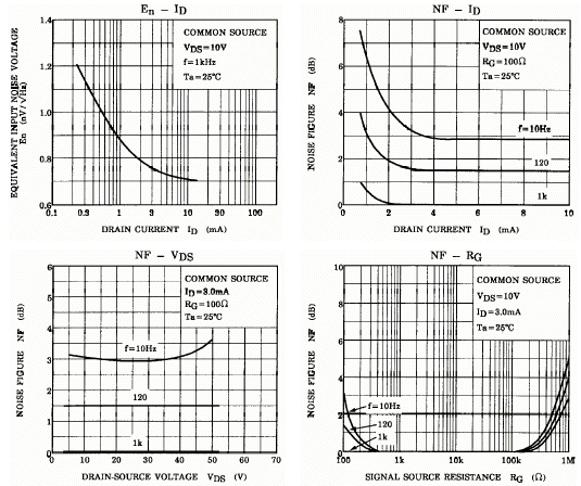

Interpreting datasheets
Sorry for not jumping in immediately, and thanks a lot, Fred. Nice link !
Well, in my case, I need low noise (phono). Looking at the 2SK369 datasheet, noise curves pages (see attached curves), the equivalent input noise (top left) is better for high drain currents, 8 to 10 mA in this case. The noise figure (top right) gives an almost constant NF (@ one frequency) within this ID range. As far as I remember, and correct me if I'm wrong, NF measures the ratio between Input and Output noise. So it should mean that high currents in the Fet generate noise (quite normal if it's thermal noise)... So, if i'm reasoning correctly, I still don't know what current would be the best. Intuitively, around 5 or 6 mA should do the job, and I want to parallel 2 or 3 of these devices... Any hint or error ?
And just one last question to prove I'm completely dumb. I still can't figure out if the so called "signal source resistance" (bottom right) is the impedance of the generator (signal source) or a kind of gate stopper resistor connected to the fet ?
Sorry
Fred Dieckmann said:Let me know when you run across some Jfets with Idss of 30mA and show me a circuit where they are actually biased that high. The problem is someone assumes these values and then goes and builds a circuit with a couple of milliamps bias current and wonders where the gain went. Most of the Toshiba jfets availble to the DIY are in the GR Ids group and most the circuits I have seen run the device at 1 to 3 milliamps........ Tell me how useful your model will be for these circuits.
Sorry

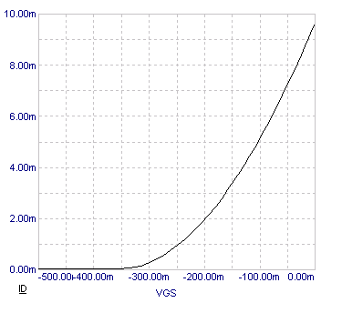

One late clarification
At the moment I posted that model, I was wrongly convinced that is the one that represents one high Idss 2SK369. (I do not use that model often and I messed it with the 2SK363 model I have and which does represents one high Idss 2SK363.) In fact, the model I posted has actually 9.6mA Idss. However, this is just fine with VTO=-.3552. Below is the Id vs. Vgs plot done with MicroCap. So, I would say that the transconductance vs. Id curve would look satisfying. Id vs. Vds plot curves are btw too flat as they are with the bulk of the JFET models (check the few other threads on this topic).
Pedja
Pedja
