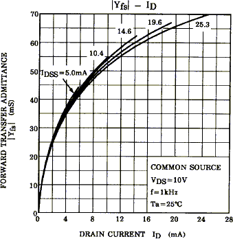

Let me know when you run across some Jfets with Idss of 30mA and show me a circuit where they are actually biased that high. The problem is someone assumes these values and then goes and builds a circuit with a couple of milliamps bias current and wonders where the gain went. Most of the Toshiba jfets availble to the DIY are in the GR Ids group and most the circuits I have seen run the device at 1 to 3 milliamps........ Tell me how useful your model will be for these circuits.
Well, in my case, I need low noise (phono). Looking at the 2SK369 datasheet, noise curves pages (see attached curves), the equivalent input noise (top left) is better for high drain currents, 8 to 10 mA in this case. The noise figure (top right) gives an almost constant NF (@ one frequency) within this ID range. As far as I remember, and correct me if I'm wrong, NF measures the ratio between Input and Output noise. So it should mean that high currents in the Fet generate noise (quite normal if it's thermal noise)... So, if i'm reasoning correctly, I still don't know what current would be the best. Intuitively, around 5 or 6 mA should do the job, and I want to parallel 2 or 3 of these devices... Any hint or error ?
And just one last question to prove I'm completely dumb. I still can't figure out if the so called "signal source resistance" (bottom right) is the impedance of the generator (signal source) or a kind of gate stopper resistor connected to the fet ?
Sorry :ashamed:

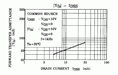

Praise! said:
[...]The transconductance of a common source JFET amp with no source degeneration resistor is 2*Idss/Vgs(off) and Idss and Vgs(off) is linearly related.[...]
Having looked at a number of JFET datasheets the last days, I'd say the Idss/VGSoff graph is linear in the log/log plots. Same for Idss/Yfs.
I.e.
VGSoff = C * Idss**alpha
Yfs = C' * Idss**beta
For example, the Sanyo 2SK772 datasheet has alpha of about 0.5 and beta of about 0.3
And I assume, 1/beta should always be near 1+1/alpha.
