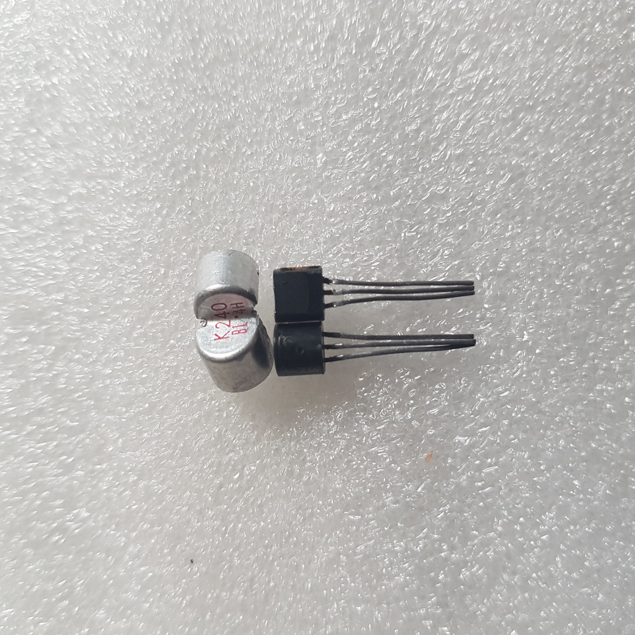

I was browsing an old electronic parts shop in my city when I accidentally spotted some 2sk240s with a grade I had never seen before. I was curious, so I picked up a few. I checked the Toshiba datasheet, but I couldn't find this grade listed. Do they really exist?

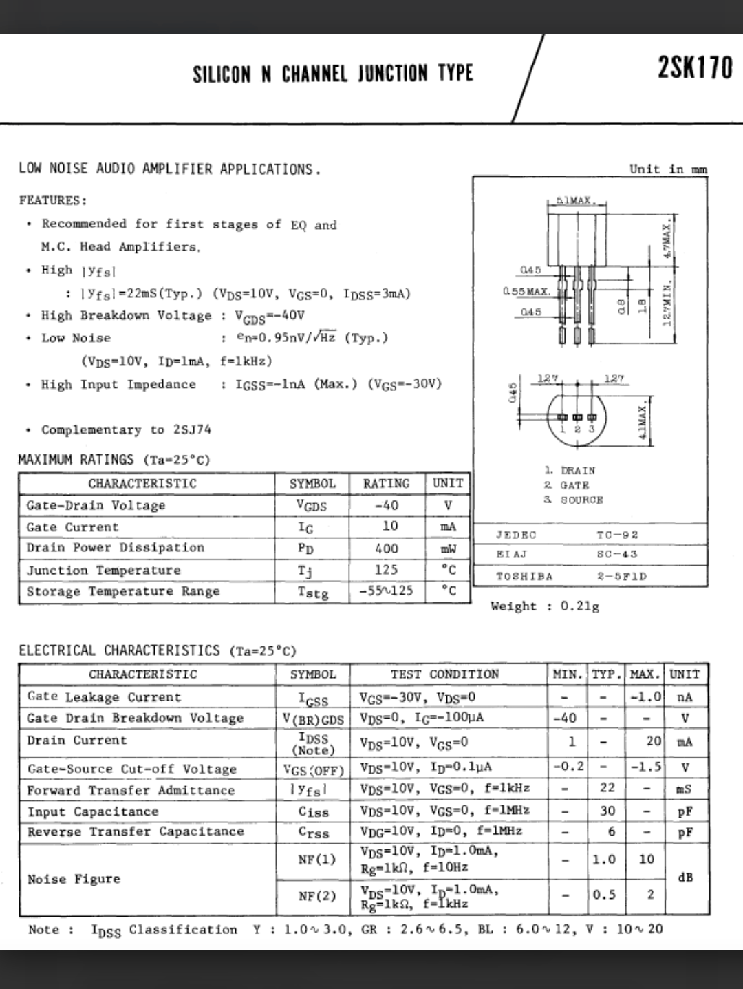

That would imply there are two 2SK170Y in these 2SK240Y packages?
Exactly, but with no markings

Measure the Idss, the The specs are "Y : 1.0 ~ 3.0" [mA].
@ bango: what is the Idss actually of those 2SK240Y's?
I've measured a few of them, and they do fall within that Idss range (mostly in range 2-2.5mA)
Actually, I used my last set of these in my latest riaa project. Not "Y"-grade but BL´s, but they do indeed exist, although more or less extinct in this day and age. Congrat´s on a great find
Yes, the BL grade (also GR & V) does exist and are listed in the Toshiba datasheet. However, the Y grade isn't mentioned there. Which is why I asked.
