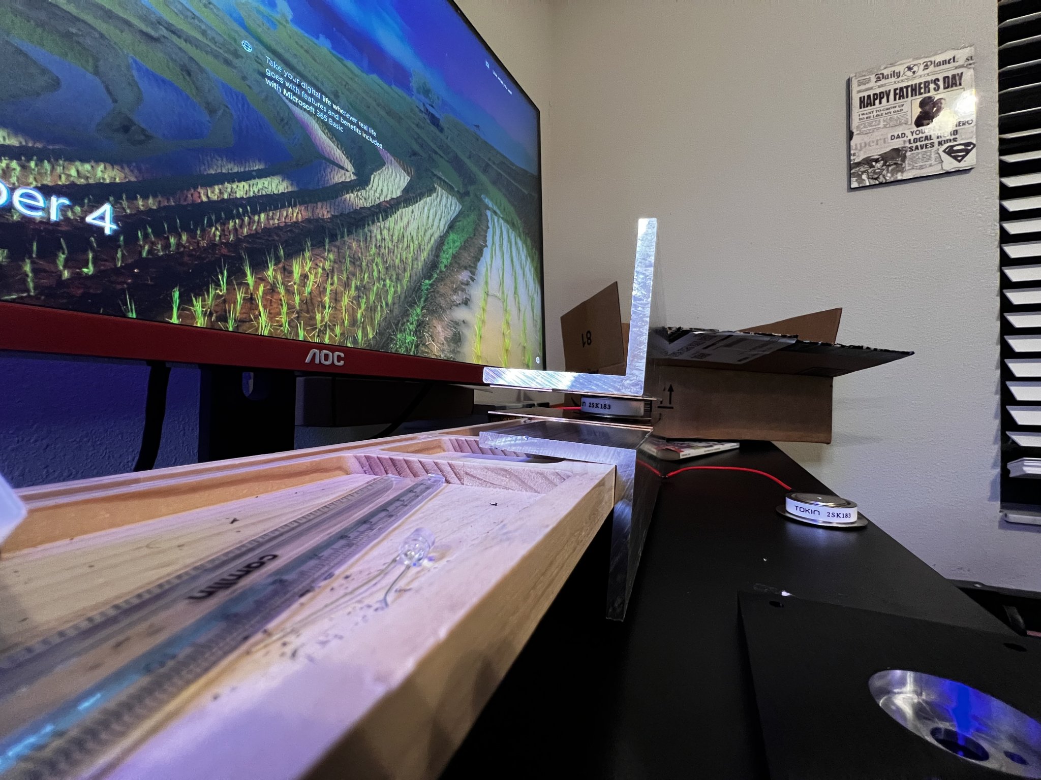

Hello DIY friends,
As you may or may not be aware. I recently acquired a pair of Tokin 2SK183 from Ebay.
I have searched everything that I can get my hands on regarding these transistors from this site or on the web.
As far as I am aware the only other design using the 2SK183 I have seen on the web is from this website (http://www.ne.jp/asahi/evo/amp/2sk183cspp/rep.htm).
I have no plans to follow that design, except to copy how the designer managed to build a contraption for the Source and the Drain, as I posted here and here.

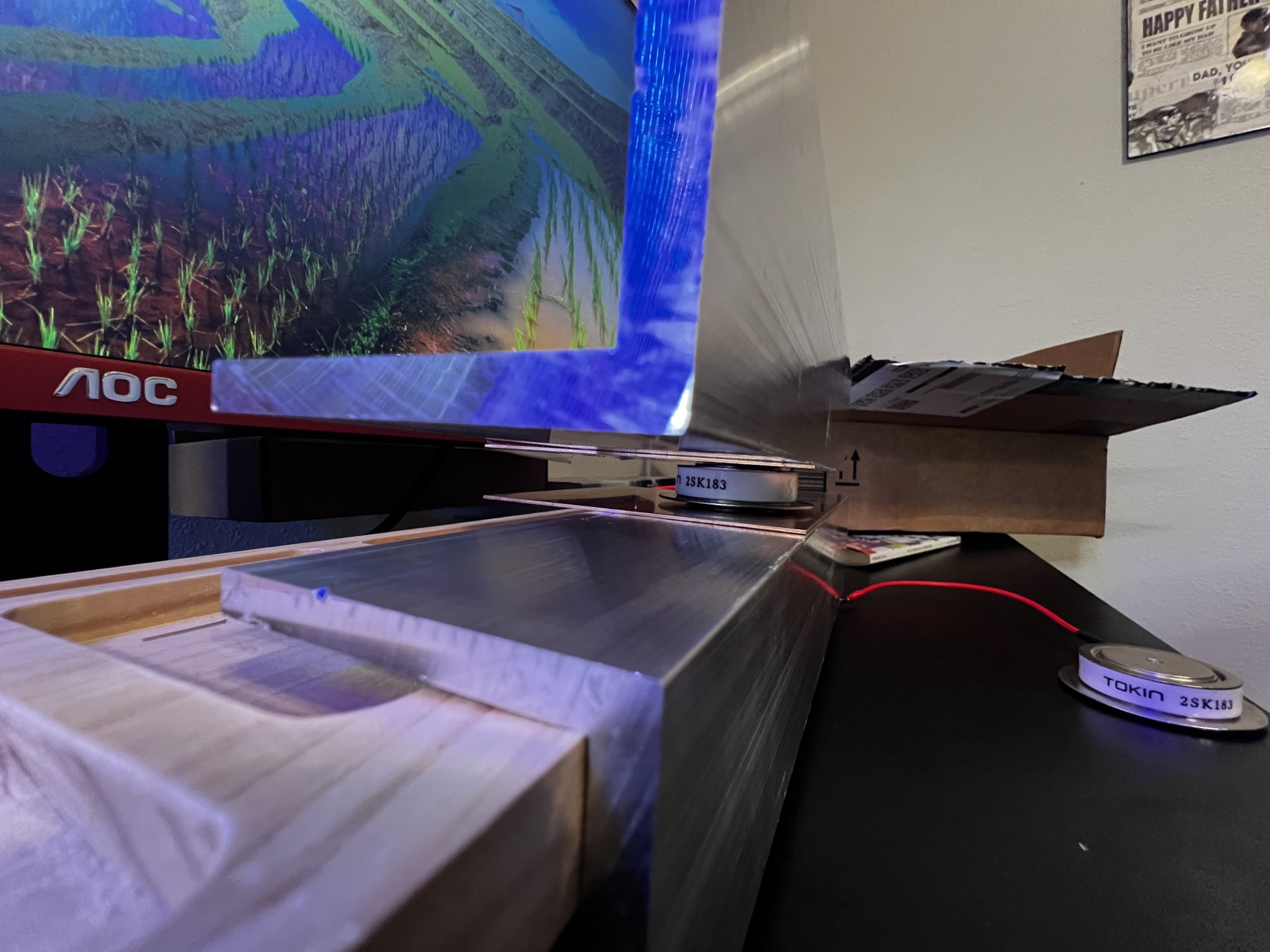

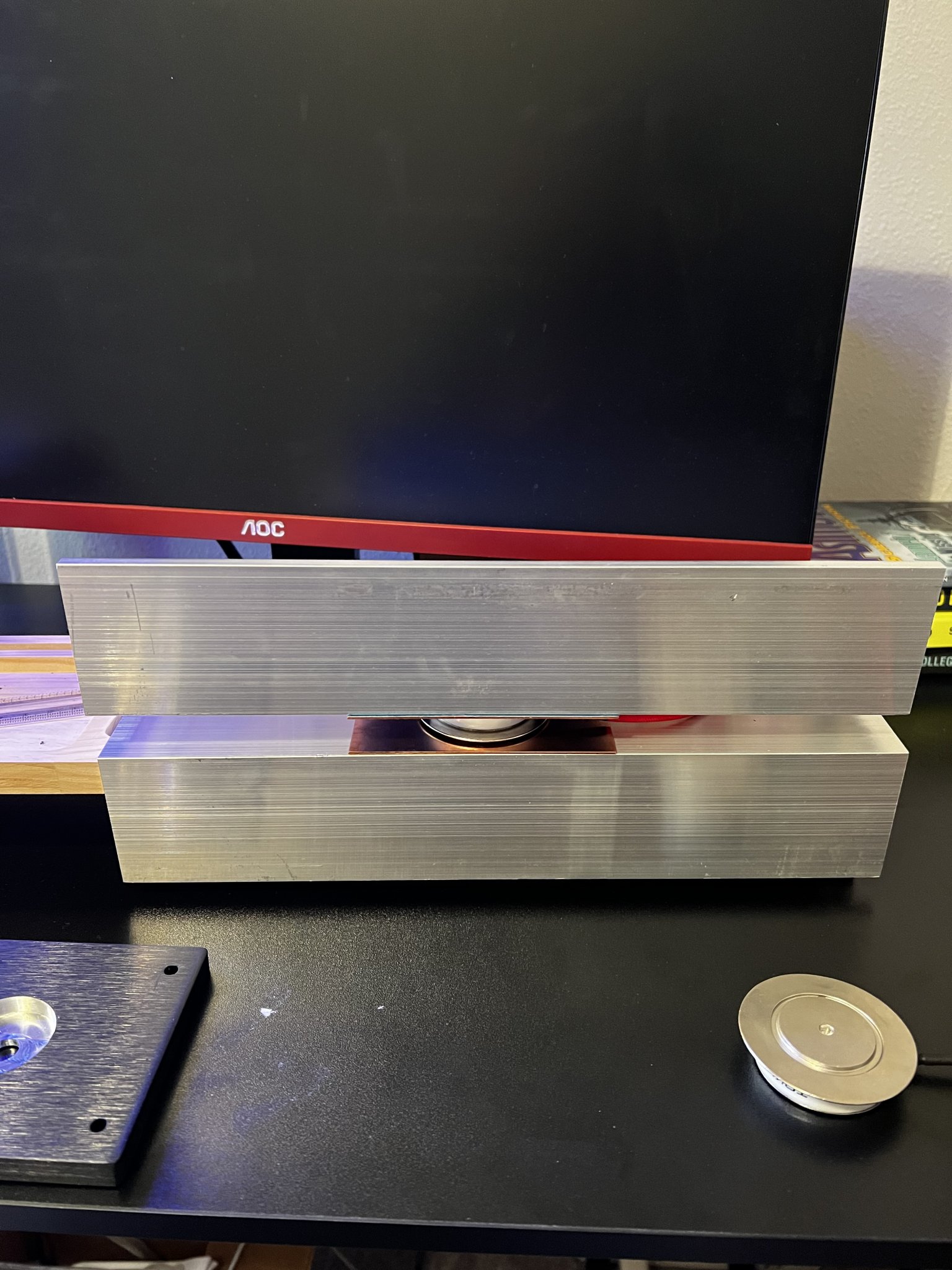

He used a thick Square piece of Aluminum, I plan on using the L-brackets instead. I am rather worried a bit about heat dissipation, for obvious reasons. If anything I may have to create a proper babysitter for this amp.
The plan is to create a SIT Sandwich. The Drain and the source are attached to 1mm copper plates, which are then attached to an Aluminum L-Bracket I purchased from Amazon. The Aluminum brackets is then attached to the heatsinks.
The hope is after I finish my SIT sandwich, then I can ship it to a member and he can do some curve tracing for me.
After that, I need to choose a design. Off the top of my head, I prefer to keep this project simple. Either a lightbulb amp (common Source or Drain) or a choke-loaded follower. I have a set of Warbler PCB's that I got from @schultzsch , I am unsure if that will work/be problematic.
Of course, even before I get to that point, I need to have the SITs tested and identify operating points, bias, etc.
I was going to purchase the aluminum and copper plates from onlinemetals.com but right before I was about to purchase, Onlinemetals decided to increase the price of the shipping, which to me was not worth it. So I got the L-Brackets, Copper Plates, and Keratherm thermal pads straight from Bezos Bookstore.
Is there a high chance that I will make a fool out of myself? :nod:
Are the 2SK180 and THF51S easier to work with and have already proven designs on this site? :nod:
:rofl: wish me luck in advance. The only thing missing are tin snips and some long bolts and nuts to secure the SIT-Sandwich in place.

Nice set of vfets you got there. Once you find a good way to hold them down and throw away the heat you are good to go.

Nice! I'd be happy to run your sandwiches on my tracer.

I like to get this stuff done at local workshops. My own workshop is not exactly well equipped with proper metal working tools, and the workshop guys are usually much better at doing this kind of work. Oh, they often also have some surplus metal pieces which can be used for what I need.

Your approach makes sense to me and there is a lot of potential for good things to happen with this!

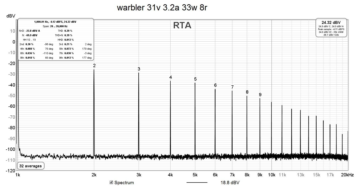

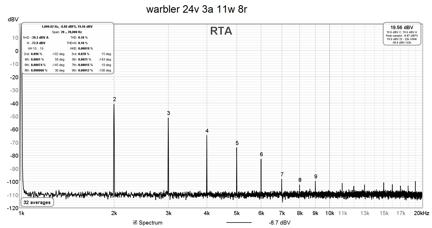

I listened to the Warbler on low impedance and low spl speakers but also on high spl and high impedance ones. It’s a nice sounding amp.
Oh yeah. Certainly my wife and daughter will yell at me to turn it down! Are you using the RME for the FFT/THD measurements?

You could do some tests at low power to prevent overheating without the sandwich. With a bit of luck thats enough to check for the SIT behaviour of your parts.
If you have two adjustable bench PSUs (one for drain-source voltage+current, one for gate-source voltage) you could do some rough curve tracing using pen and paper. Just keep a finger on the SK183 to check the heat.

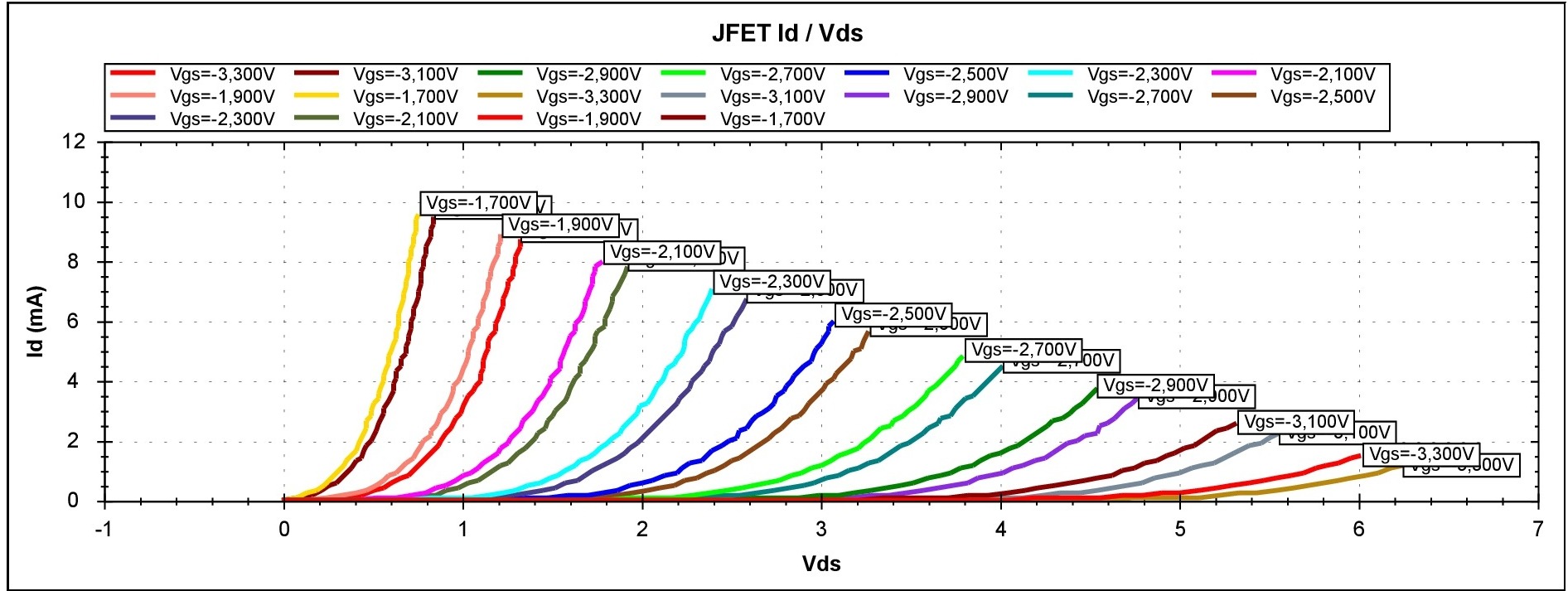

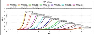

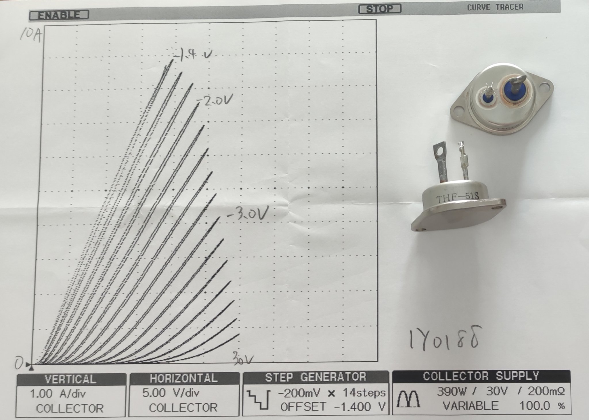

Un few years ago I bought two THF-51s selected with the Id/Vds. This is a graph from a Tokin. The other graph is almost identica. With an PEAK DCA75 the two SITs have this Id/Vds. Only 10mA and 7V.
I like those but a bit expensive for me right now.

Hey folks,
I haven't forgotten about this project. I have all of the parts required, except I'm not sure if I have the correct thermal grease between the SIT and the copper plates. I currently have Corsair TM30 Performance thermal paste in hand. Would that work?
