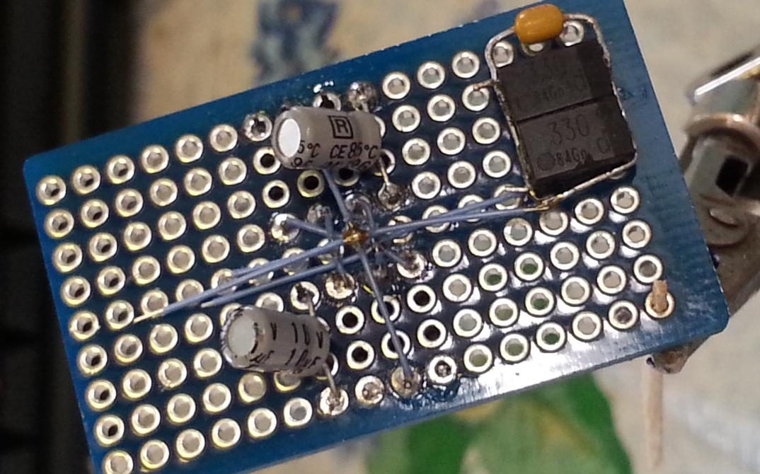

Andrew, there are four each 330uf totals 1500uf combined as an array, but isn't 330*4 =1320?
Anyhow, since unconfirmed voltage rating, conservative approach is to assume voltage rating below 7809 powering, so substitute a lower dc voltage, check current legitimacy since quiescent consumption of current is a couple milliamps. Fuse the current specified for normal little gem mark II consumption. Should the tantalum array blow, it will be a big short. I benched it out of circuit by charging it to multimeter battery voltage applied during capacitance measurement, some mere fractional volt, but it stubbornly retains charge, meaning good zero leaks. Thats why must chk next charge to six dc volts, simple 6v lantern battery charge up endure, then if ok, apply nine volts powering. I'll picture post so size is revealed of built array, like the size of my galaxy sIII keyboard button size, held horizontally viewed.

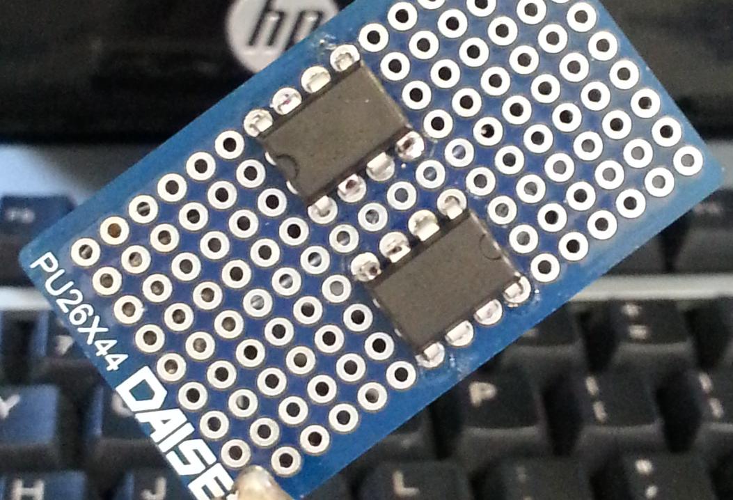

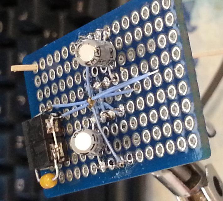

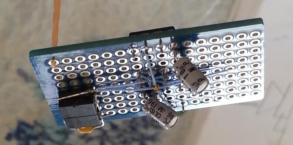

pics little gem substrate
pics of tantalum bank supporting little gem mark II, but buffer portion not appended just yet to substrate, must test gem's tantalum bank ability to accept voltage targeted 9vdc regulated

The perforated welled landings substrate is humbug dealing with, I'd rather freespace weld the gem package as was done its ahead upstrm buffer weld package.
pcb evolution must be made easier, as in hand drawn conductor traces and hand penetrating landing wells. Nothing much has improved since I was a kid taking electronics in public education. That was the vietnam war back in the 60's!
Do you visual the kynar segmented congestion of conductor routing on this humbug substrate? Thatts humbug fabrication! Intent of layered planes of kynar linkups is to minimize crosstalk and noise intrusion. kynar segmented planes of links esp thwarting competitive earthing amongst energy consumption routes. Laid earth linkages of kynar on ground floor substrate, then elevated yea millimeter skywards another kynar conductor path distributing user signal, and finally on the 3rd floor yea millimeter higher upwards is the consumption powering tension.
It's trauma to work backwards de-constructing welds to swap out discrete participants!
That means non conducive perfecting optimal circuitry arrangements because of the hassles to remove reinstall access interferences! Kinda reminds me of "building a ship in a bottle". Same thing of obstructions to access are encountered in extremely compacted engineering designs, like our subs, missles, recon satellites, now drone and fugure nano drone! I guess you pay painfully for specialized constructed packages, coveted packages.
Luckily I caught the under rated voltage of tension ballast array comprised of four rectanguloid smd chip tantalums. I detached the positive tension bussing, then independently battery charged this bank to various battery voltages avail, 1st 3v, 2nd 6v, last 9v. Ammeter reveals flow once charge saturated into bank, but current still weeps thru to upkeep battery voltage to par, so that flow is parasitic because its telling you your bank has annihilation going on inside, so scrap it, get a better bank. The bank of four each chip tantalums will be removed from substrate and another electrolytic installed instead with 104bypass as is requested for speedy bypassing. I located a japanese 10v 105celcius brown cylinder radial electrolytic 500uf and its just about the same volume as the bank array tantalums. I realized it's an aluminum electrolytic but it does not suck amperes from battery testing upon complete charge up (instantaneous practically speaking). Other electrolytics maintain steady ampere (ma) draw even after chargeup. So the better the nonleakage (annihilation of energy stored inside electrolytic), the better the cap. But I don't know how conductive performance will be, as caps do exhibit sluggishness transacting charge balance negotiation to demands. I pay attention here because response time affects guitar outcome sound signatures. Materials used to construct caps exhibit real world characteristics! Its not perfection so cap will not follow ideal laws of capacitance, it has compromising influence, from resistivity, inductance, probably more influence from range of frequencies passed, and atmospheric meteorological conditions affect too. All that said of the condenser ballast for tension desired. Looks like tension will always be behind schedule! The vacuum tube folks some adore "sag" inherent to tube rectifier bottle. And that's coupled to condenser bank itself always behind schedule to guitarist demands of promptness, and so the coveted gube rectifier.

culprit found and cleared, amber residue bridging
i found the bug. it is that china amber stuff called amtech flux rma-223-uv "made in usa!"
pure isopropanol and tiny paint brush bristle agitation submerged workpiece washed all cross connects bridged by amber deposits
fired it up with spkr, quiescence measures 48ma by 256mvdc positive across spkr
