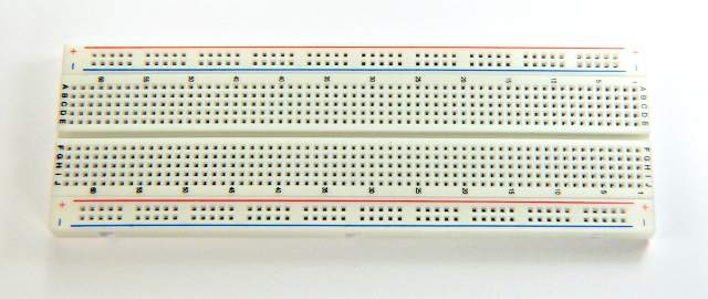

Best way is experiments on breadboard.
You can try Mr Pass buffer schematics for example is simple and you can change resistors types and brands :
metal film, carbons film, wirewound and fancy etc. and find subtle differances and perfect sound to your taste.
Greetings 🙂
