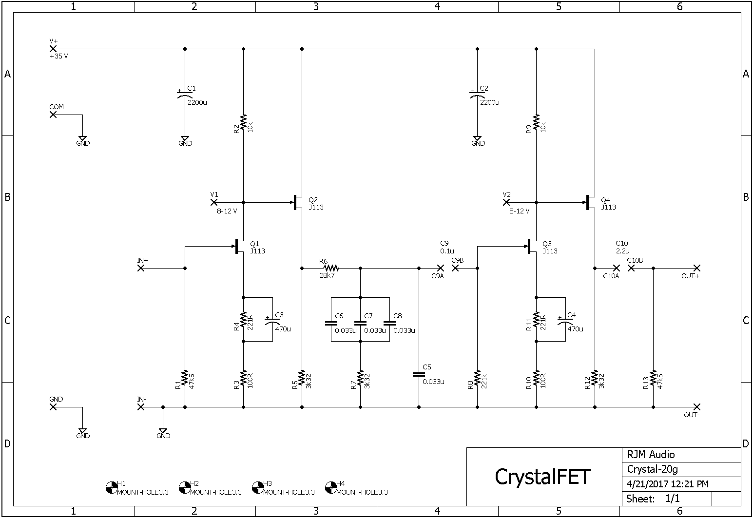

Regarding alternatives that could possibly handle 10mV pickups without much alterations:
Apart from Pearl II which i've considered in the past but is a bit more complicated, what do you think of say RJM's CrystalFet 2?
Here is the latest (i think) schematic of its MM only, lower-gain version:
Would it be more capable, with adjustment maybe, to keep up better?

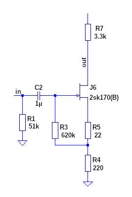

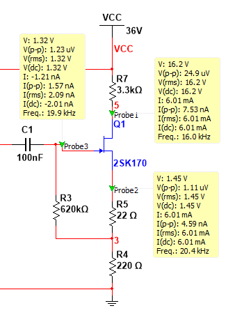

This is the OP circuit without the passive RIAA network, to illustrate gain compression.
I am not sure if it really helps to calculate the overload margin of a phono stage without the effects of 0dB - 20dB - 40dB damping of the RIAA Filter at 10Hz - 1kHz - 20 kHz.
and the cartridge output is the inverse of the RIAA network.I am not sure if it really helps to calculate the overload margin of a phono stage without the effects of 0dB - 20dB - 40dB damping of the RIAA Filter at 10Hz - 1kHz - 20 kHz.

Instead of using a large electrolytics in the source, it is better to use a small film capacitor at the gate. And overloading need not to be a problem...The drain current is set by R5, and the gain is set by R4 and R7 in combination with the transconductance of the JFET.
Indeed, will have to build it in a few minutes, but simulation seems to indicate that you can hold distortion quite low with this "level shifting" arrangement!Instead of using a large electrolytics in the source, it is better to use a small film capacitor at the gate. And overloading need not to be a problem...The drain current is set by R5, and the gain is set by R4 and R7 in combination with the transconductance of the JFET.

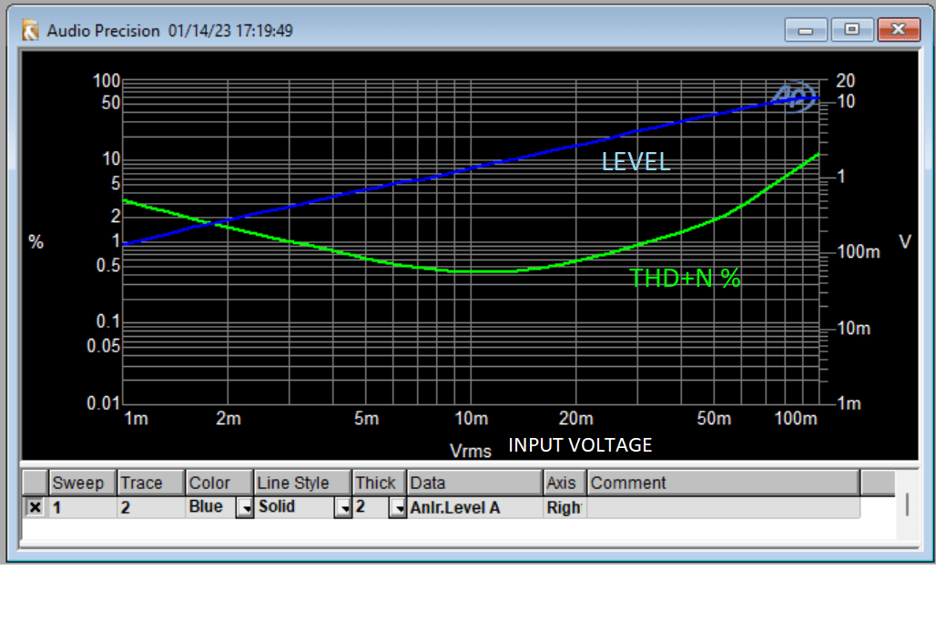

Look to the graph in post 55, the poor gain compression is a problem, even with a more typical cartridge.Problem is NOT the Le pacific.
Knutn has provided a simple and elegant solution.

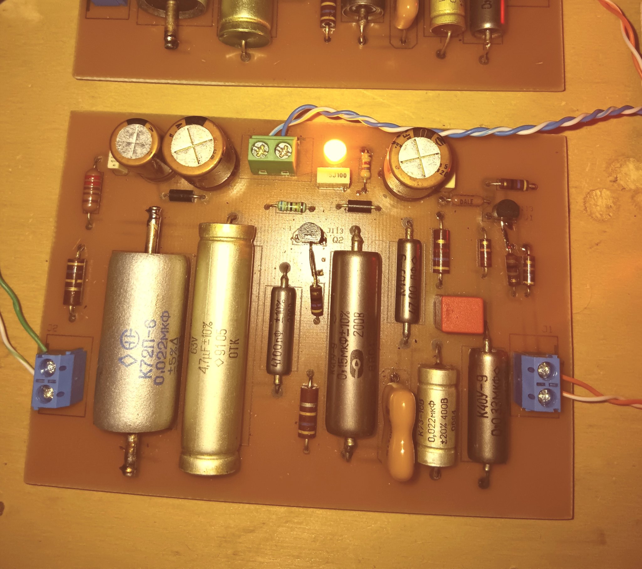

Hi again.

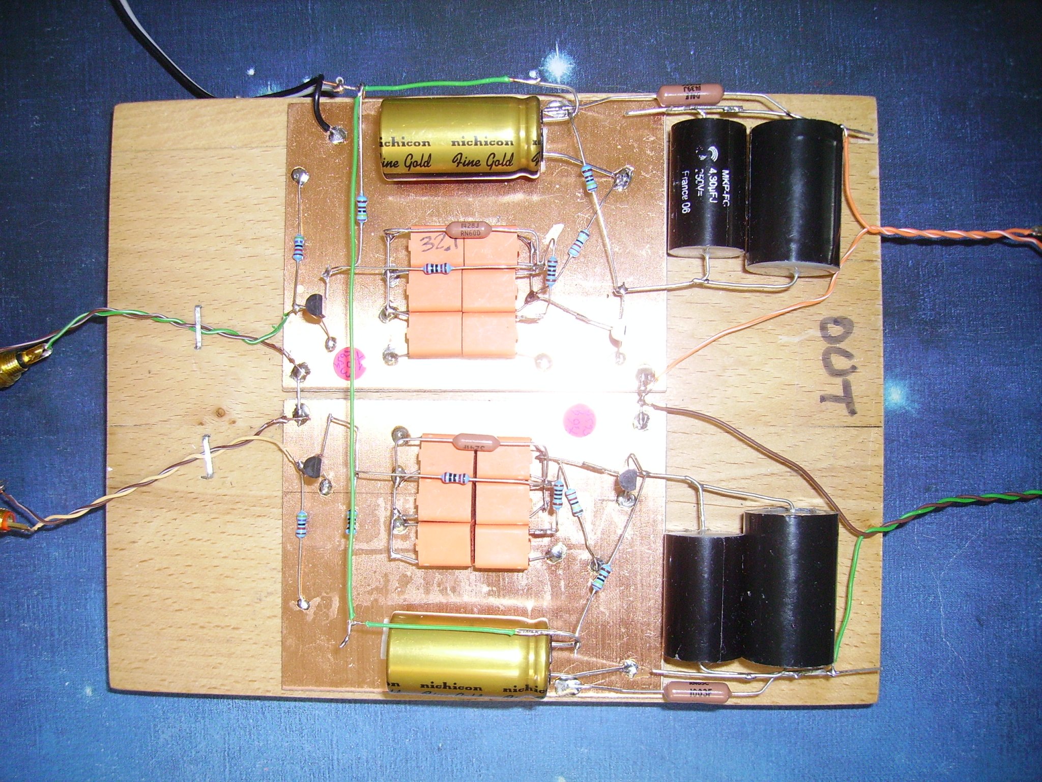

I've been using Le Pacific succesfully with high output Shure M44/55 for a while now and it is working nicely. Mostly a Shure M55 with a Morita Kurogaki (wood) stylus.
And the last week i've also been running tests with Jico J44A-7 DJ (nude tip) which is even higher output. So far so good, it all holds very well. No distortions, no overloading and generally i'm very happy with such a barebones RIAA.
Recent version of the dual-mono PCB (one of first truly own design-so be kind!):
To my ears, it surpasses my other main passive RIAA stage, an Audio Note L3 clone with M2 regulated tube PSU.

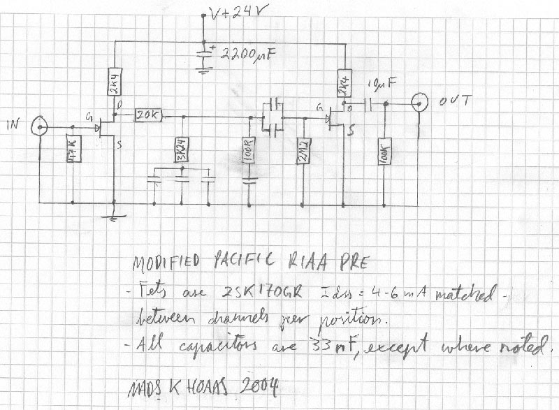

My question is, since i also have several much lower output cartridges, what would be a possible way to increase gain slightly in this guy?
*Will follow with the actual version of the modified schematic used right now with the Shure.

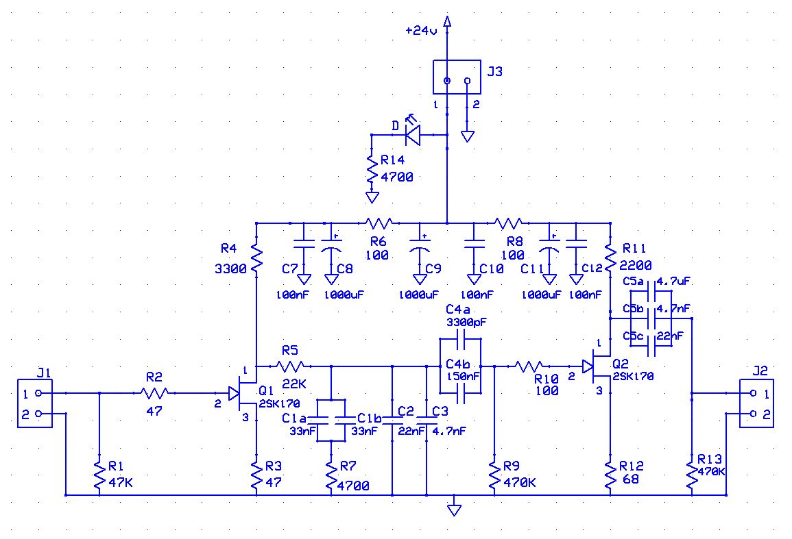

Here is the schematic:
Any possible suggestions to increase the gain a bit, would be appreciated.

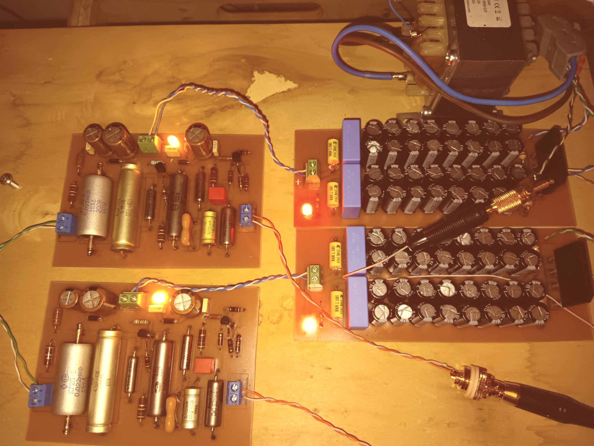

Generally it's a noise-free preamp.
However, when i used two separate PSU boards to power each channel (each mono board) I encountered increased mains hum noise (60Hz /120Hz).
Tried some stuff but didn't help. Star point earthing, floating the earth with a resistor//capacitor, disconnected earth. There was no difference whatsoever.
However, connecting the two mono boards to a single PSU board, i could get it back to being noise-free.
By the way, I'm using a single transformer to power the PSU boards.
Maybe two separate transformers will help a bit?

Why? the constant confusion? Built this Years ago from Madds simple Le Pacific schematic Used Quality parts and Matched fets .
A v simple build that has proven DEAD silent and One of the best Phono stages I've ever heard.
Consequently I have not fooled with it for ~20 years.
