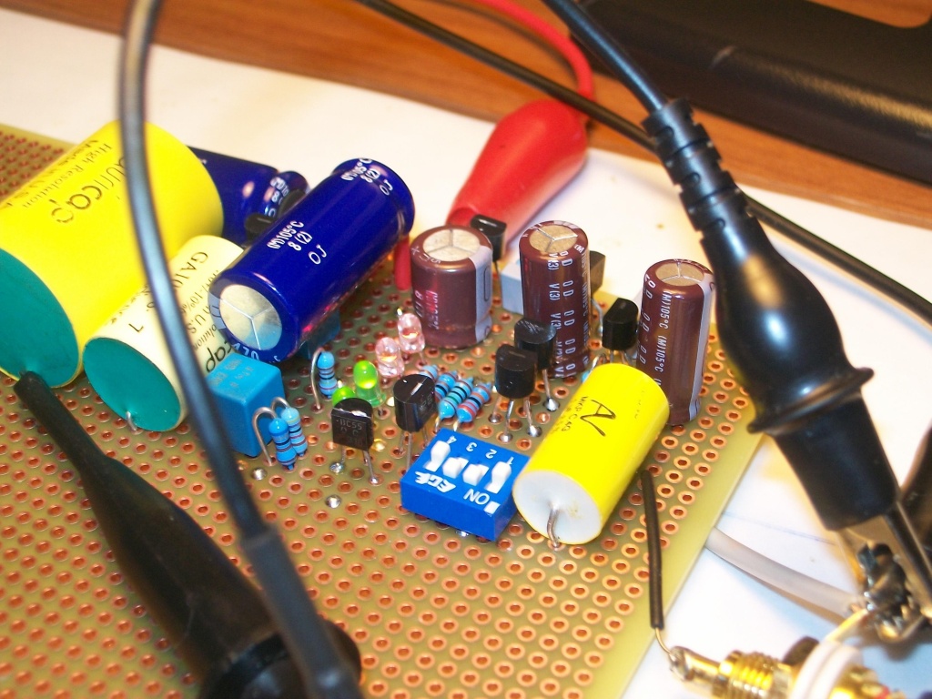

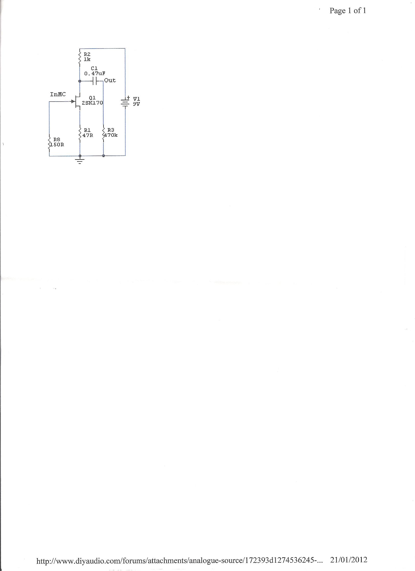

Batty can you try the head amp on a battery? I have built both without success. The power supplies seem ok, but no luck with two builds of the amplifier.
Salas what is the 220k resistor doing?
Gives local reference to gnd. Can work without, it may give the odd ''pop'' from cout, but no big deal. To check the build properly, provide a sub mV sine wave from a divider, watch on a scope for output. See that you got no DC on input, check all your component connections against the schematic.

As I mentioned before look in the simplistic Riaa thread for smpkje's 63dB build, he had successfully used your pre-pre and the HighMC main Riaa pre directly from the pdf instructions and input sensitivity selection DIP switching. He had shown some layout details, maybe comparing it can help your debugging.

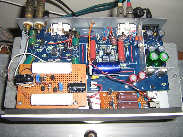

here are my updates, last time I still have hum and transparency problem on the mid-high side. Also I like to try bypassing the 1000uF caps.
On transparency I know it must be very good referring to my TDA1541 sk170 DAC I/V (ECdesign), so problem must lies elsewhere
bypassing all 7809 and BC550's 1000uF caps with 0.1uF wima I got better mid & silky highs
Changing azur540 Cout from prev, mod 100uF black cerafine to 10uF silmic2 is surprising , silmic gives better transparency and bass...silmic will stay until I can find small sized 10uF MKP 🙂
Hum largely gone after tidying up litz wire leads, too bad I still use bad-hot transformer.. I'm happy now & starting enjoying records maybe for 6 months 🙂 then build the complete RIAA, Thanks Salas !

Nice progress. Maybe you can find 5mm pitch 63V Wima 1uF and 0.1uF MKP1837 Vishay to step bypass your 10uF Silmic since space is a problem.
Thanks for your tip, I'll look for small 1uF wima MKP and 0.1uF 1837 to replace 0.01uF orange drop, the silmic's are still on long leads, I plan to try another electrolytic caps ha ha, but no need..

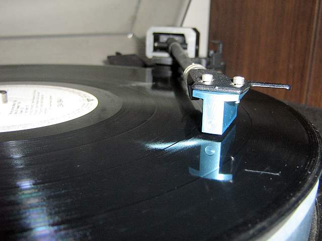

Interestingly I have a incorporated switchable cart loading, i selected the values too close as there isn't much difference in sound. I used 90,100,120,220 and 560 ohm.My cart has recommended loading 120R.

Which cartridge you used?

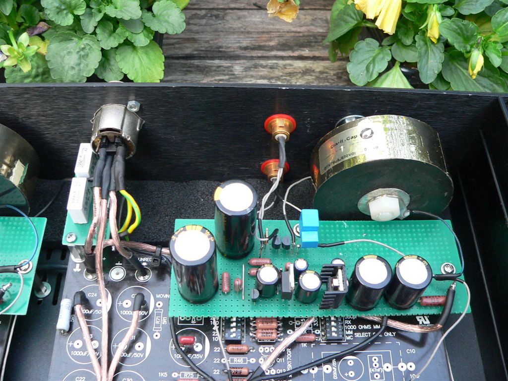

I made the MC step-up also and it wasn't just a voltage step-up 🙂
I used 2 LT1086CT in serie in their best config.
FT3 teflon is very honest, pure & great for instruments but I needed a more juicy sound so I used Clarity Cap DACT with MKP1837.
My cart is an Ortofon Rondo red.

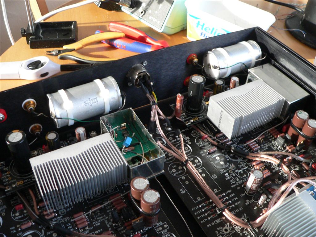

ANOTHER approach at the mc- pre. This time with a BiB shunt, the power an open sound it gave made me go back to the FT-3 teflon cap. I had some issues to tackle hum, put the mc-stages in metal boxes and installed some RC filters in front of the BiB.
Maybe it's premature when I say that this is my final setup of Salas his MC stage,
because you never know, but it's good !
