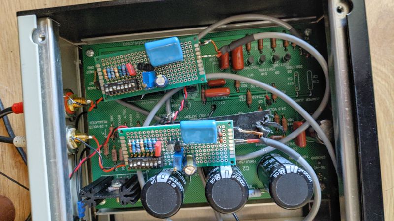

Some say absolute phase matters some say not. We also don't know if its actually preserved in the various recordings or not. In any case you can reverse the polarity of speaker cables at both cabinets terminals and compare. That way you know its restored in your system chain at least.
Salas,
Just a word of thanks - I found this thread when looking for a schematic for a MC step up for a Pass pearl. I used a "teddy reg" to supply power given that the current demand is constant enough and the teddy reg is very quiet on its output although with high enough output impedance. Anyway, after the usual issues of chasing down hum, it is singing away and sounding lovely. No surprise that it it suits the Pearl so well I suppose.
If I adjust the supply voltage I'm looking to have about half the supply voltage on the drain?
Fran
