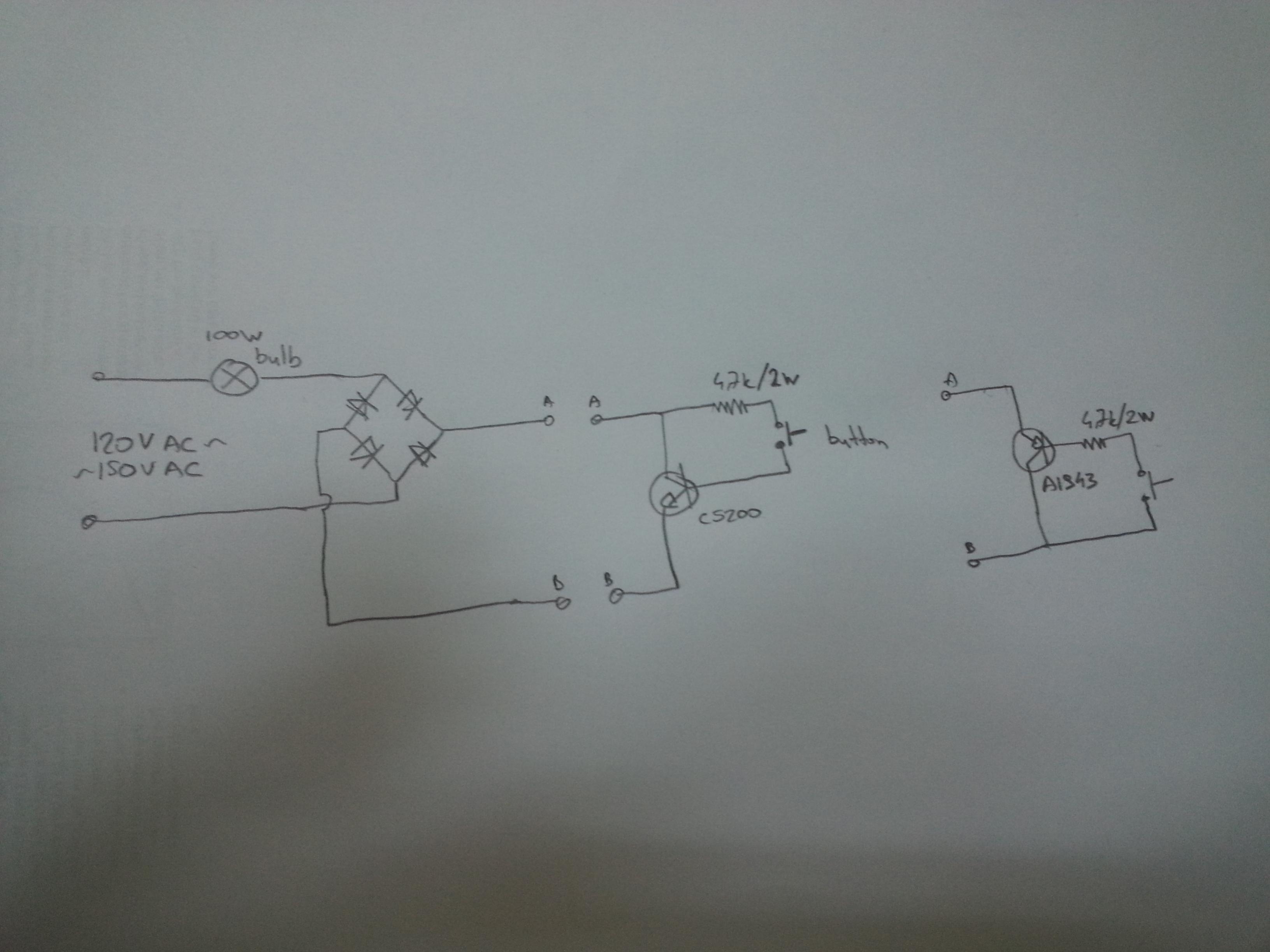

Hi friends.
Here the test and gave me results.but interesting thing happened fake c5200/a1943 are hold on 120AC supply,but 150AC they burn imidietly and bulb stays on as you plug supply 🙂
Other are holding on 150AC voltage supply should i push them more or is it enough?Datasheet says 230v min.what voltage can be correct value to test it?In SOA says 200v like 0.05a (50ma) 🙂 do you think even original ones can hold on this?
And anyway i will not use these transistor in future.but i made mistake and bought some few time ago.

120 V ac will give a peak of 170V dc and 150 V ac will give 212 V dc . I assume the the 120V and 150V ac are measured values and not assumed values !
That's a rather dangerous way to test transistors.
Maybe he's a candidate for a Darwin Award

the base current when at 120Vac is ~36mApk
That will allow ~3.5Apk when the Vce is ~170Vce and dissipate an instantaneous 600W that will repeat every 10ms.
