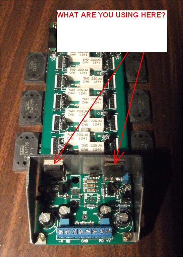

You must drive them with MT-100's (EF3 -below). @10A soa -10ms nothing comes close -I'm just using the OPS in the picture for my subwoofer.
BTW - all my sanken's match nearly perfectly. The little ones (mt-100's) have
better gain /better matching than my ON TO-3p outputs.
