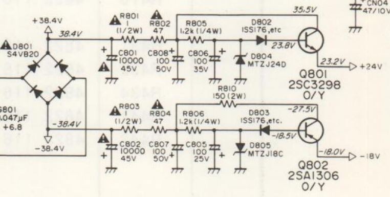

I need to replace the 2SC4883 in a Marantz PM66KI. It's nothing to do with the output section, but used in a regulator that drives auxiliary circuits like the speaker relays, phono board, etc. The schematic is attached.
I feel like I should replace its friend the 2SA1859 too, as these transistors have been roasted for a couple of decades. Other cooked components in this part of the circuit already replaced. The 24V rail is sagging to 10V under load (7V when source direct relay is also engaged) and the transistor doesn't get warm anymore. I think it objected to me re-doing its fatigued solder joints as it was fine until I did that....
So I'm wondering what I can use to replace Sanken 2SC4883 / 2SA1859 with what is currently available.
The PM44 has the exact same circuit but uses 2SC3298 / 2SA1306 (Toshiba?) but these don't seem to be available either.

I remove R802 & R804 and replace them with wire links (R802 is the most probable cause of your sagging +24V).
I remove the 150R resistor (R810) and install it @ R809 (NOT factory installed).
I remove the wire link adjacent to Q801 which enables R809.
I replace R810 with a 330R/2W wirewound resistor (you'll have to purchase one).
If you have them available, stick TO220 heatsinks on Q801 & Q802.
I leave R805 & R806 as they are when they left the shed @ Heathrow.

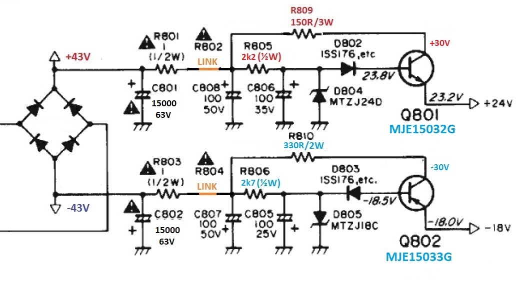

Thanks - all electrolytic capacitors on the main board have been replaced. The big 'uns were domed (but measured fine btw) the whereas the 100/220uF (ELNA RA2) were mostly way off. One of the 100uF ones measured 30uF with an ESR of 22 ohms.
Anyway... R802 seems to measure and look OK, but there is a base/emitter short on the NPN 2SC4883. I wonder if even a TIP31/41 will do here as it's only a zener pass transistor it doesn't need a 100+MHz jobbie does it?

As the maximum operational frequency of Q801 is 0Hz, any NPN transistor capable of dissipating >1.25W continuously into free air without failing/melting is all you require.

I wouldn’t say ANY transistor - it is possible to go too big or too slow here. If too slow, output impedance will go inductive. Too big and you may not have enough gain at operating current. With older high power NPNs the beta can be single digits at tens of uA to as much as a mA. TIPs aren’t that bad, but some old switching types can be.
Ok I used MJE15032G. The 24V rail is not sagging anymore, everything looks OK and the amp is working fine.. The speaker relay is back to a loud clunk rather than a feeble click.As the maximum operational frequency of Q801 is 0Hz, any NPN transistor capable of dissipating >1.25W continuously into free air without failing/melting is all you require.

Without reducing the current demands of the supplied circuitry (the relays, etc.) you can't reduce the current through the transistor, so I can only assume you reduced the voltage across it? Wouldn't it sag under load otherwise? Although I think it would be fine if it sagged by a few volts, I'm just trying to work out in your 'rationalised' version what the voltages are at various points.
At the moment (at 100mA) I have R802 (47R) dropping 5V (45 to 38) and the transistor dropping 14V (38 to 24).
Without R802 isn't there an extra 5V going into that 24V zener, with no change in R806?

Just to tie this up, here's what I ended up with.
It's Hamish's recipe with new transistors added (one had died anyway) and slightly bigger resistors for the Zener diodes.
I have heatsinks on both transistors and neither get particularly hot anymore.
Everything working nicely.
