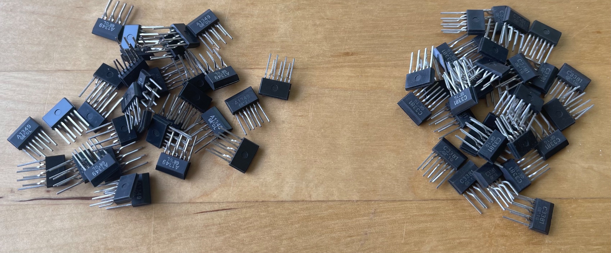

My friends and I are looking for replacements for Toshiba 2SC3381 and 2SA1349 BJTs. There are forum posts with single package replacements over the years, but even those replacements are out of production. I'd like to avoid eBay or sketchy transistors if possible. If I'm not mistaken, the parameter we are having difficultly with is the DC current gain (hfe) classification we're looking for a minimum of 350.

I’ve just checked my parts stock...only 4 pairs of BL left and about 10pairs GR.
sorry.
sending these parts to the USA would be very costly.
Hi there. do you still happen to have 2SC3381BL and 2SA1349BL left? I'd need 2 of each. Let me know if you do and how much to ship to US.I don't think it would be very expensive with just regular mail and tracking.

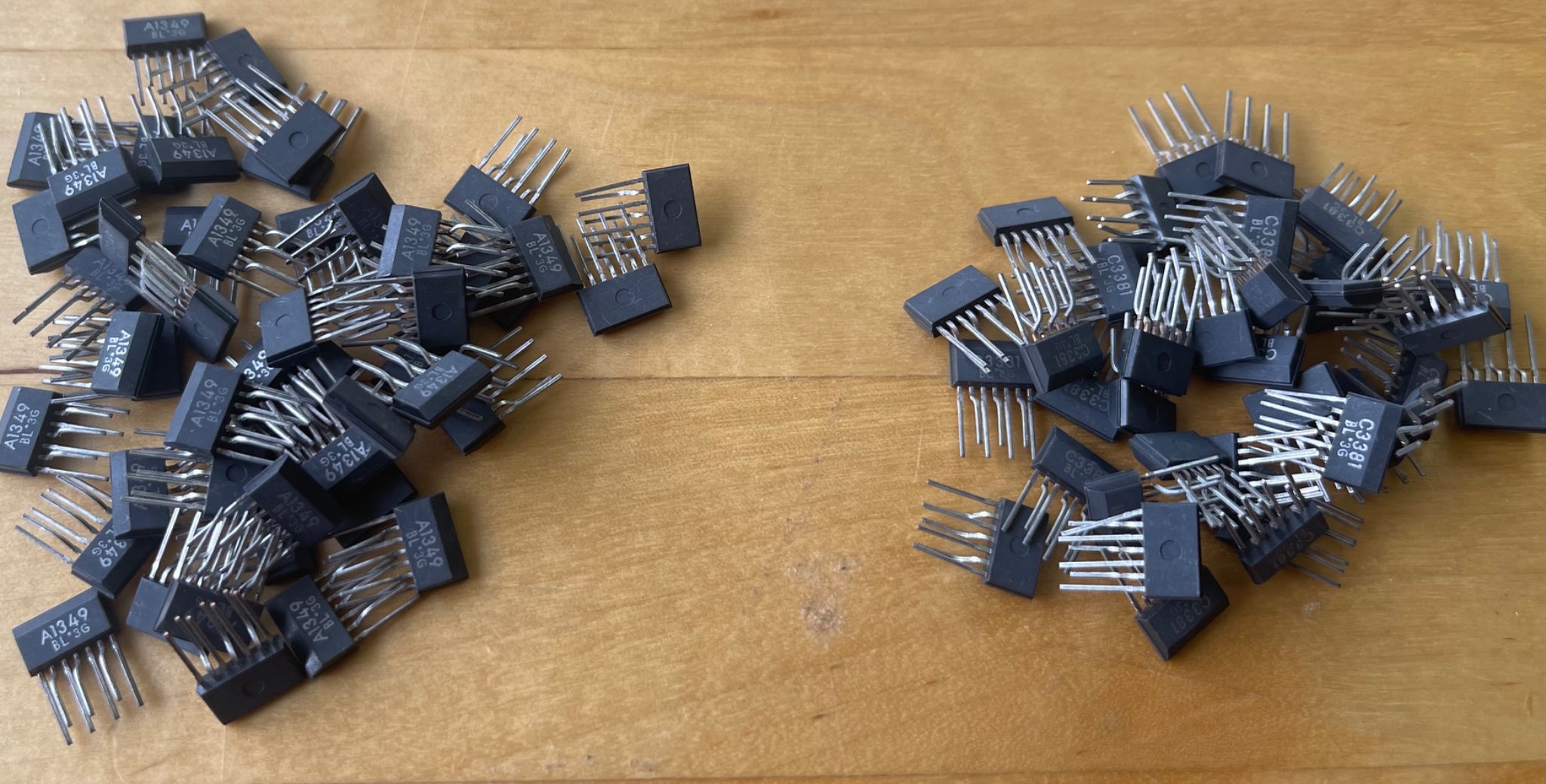

As evidenced here.
R
