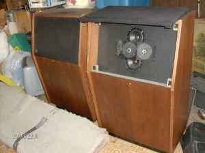

Those are some pretty interesting speakers!
looks like fun.

Be interesting to hear those speakers
They do sound pretty good.
See the attached pic of their schematic.

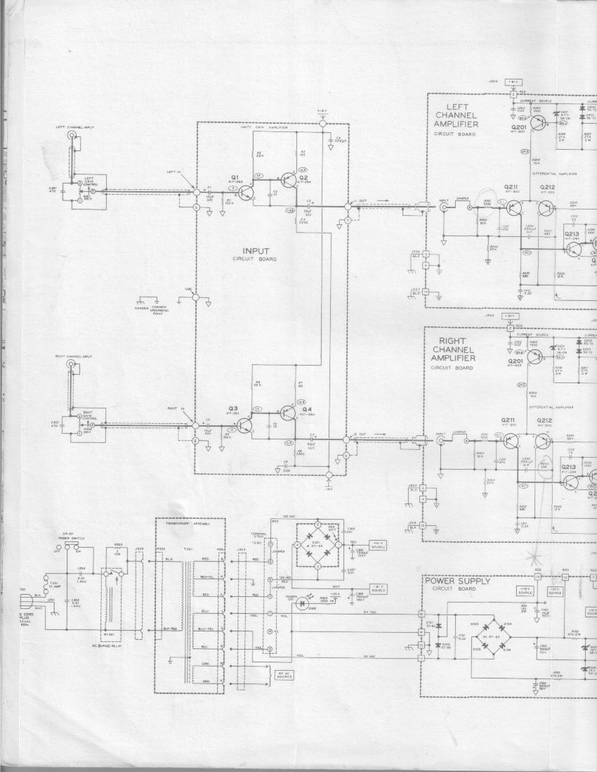

I have a Heathkit Power Amp AA-1640 that has an issue on the left channel that I believe I found. Thinking about replacing the 2N4889's with MPS A92.
The seem to be close enough. I also have some 2N5401 that would/could work.
Any comments or suggestions. They are Q201, Q211 and Q212.
Q213 I believe is the culprit (See Huntron Pics), but while I'm in there I want to change the transistors that may have been stressed as a result.
Q213 was a MPS A42.
The faulty Q213 has a rounded elbow on the defective transistor. It is the emitter collector junction. The nice square elbow is a known good transistor. These pics are on my Huntron Tracker 2000.
Transistor tested good on my Heathkit IT-121.
The Huntron rarely misses.
